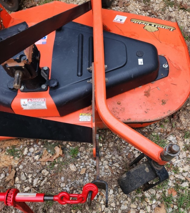

The picture was simply to show they were wider than they should be.
The black arms on the mower are removable. I’ve flipped them, mounted both inside and outside of the orange plate, but they still exceed the width needed to properly sit properly between the lower hitch which is my goal since I don’t want them scraping the tires and to switch attachments without having to constantly adjust the tractor’s hitch arm turnbuckles.
I might try the pipe wrench and tractor pulling idea. Not sure if I have enough low-end torque to make that happen but worth a shot but I’ve got the pipe wrenches, chains and trees.

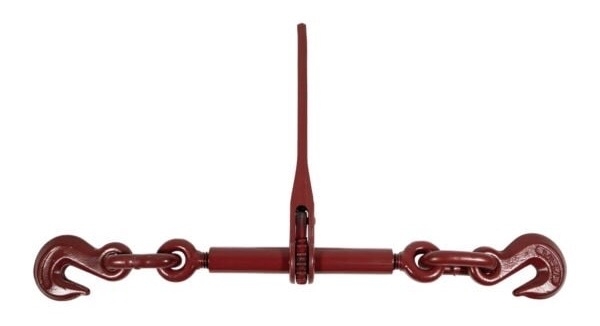

Another thought was a ratchet binder. I’ve never used one but if I can get it to pull evenly together in theory it would work.

I think I would bite the bullet and take them to a shop with a press to straighten them out, and maybe reinstall on the inside with a 1/2" steel plate spacer.

I don't know if it's just the perspective in the picture, but it looks like the ears that the black arms are mounted to are bent outward. Is that the case? If so (and assuming they're not supposed to be that way) they might need to be pulled back together with a chain binder too.

Concur with Runner. The right side mounting plate (orange & left in the picture) sure looks bent outward. Left side looks a little off as well.
Disconnect your black angle braces, get the orange plates bent back to 90° to the mower, and take your angle braces, put them in a vice and bend them back to fit.

You apparently think those are going to be really hard to bend. They are not. Select a way, get them off and bend them. The real question is, why did they bend out in the first place. You have something set up very wrong if the tractor bent those.

If you have a couple of large pipe wrenches, put both on one side at a time (top and bottom) so that when the back of the deck is in front of a tree, put a chain on both wrenches and pull the chain with your tractor. The wrenches will bend the mounting plates back into their normal F/A orientation.
Two wrenches in order to put a uniform bending moment on the whole plate area at the bend location instead of just a localized section. If you only have 1 wrench, do small increments of pull, top to bottom. Heck, even a LARGE Crescent type wrench will do. You want a LONG arm to get a big bending moment.
I would unbolt them and take them somewhere to get pressed back straight. Machine shop or most mechanics usually will have a press...
The bent plates are welded on. The gauge wheel arms bolt onto them. The plates likely got bent while turning the rig and the deck hit an immovable object, preventing its rotation.
