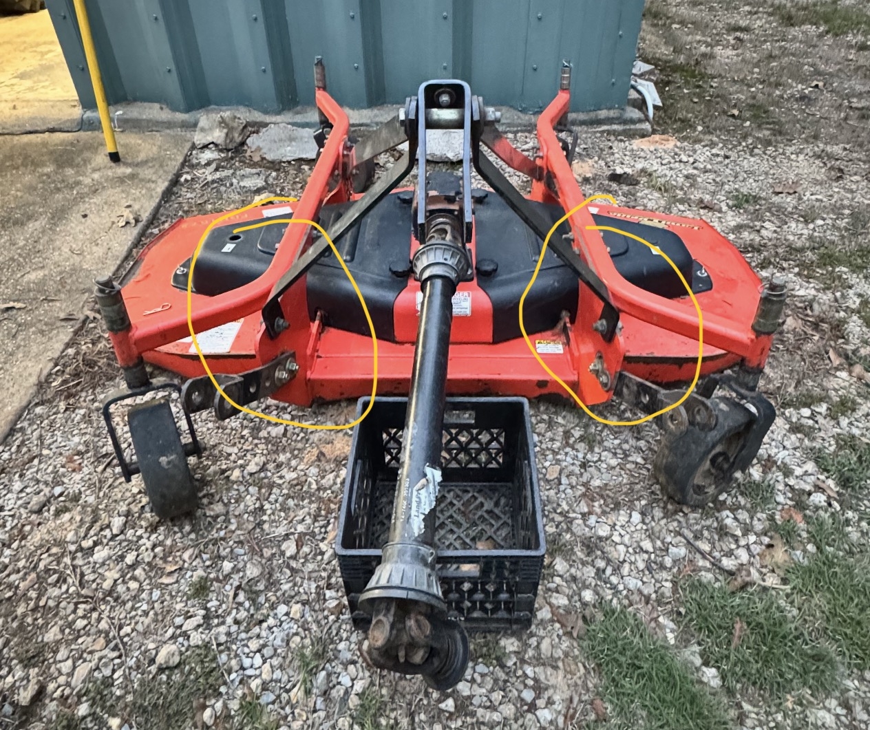

The two front sides of my landpride finishing mower somehow separated over the years. Unfortunately this makes it tough to mount it for use as the lower arms keep scraping the inside of the rear tires. Don’t ask me how it happened as I don’t have a clue.
Anyone got any ideas on how to pull the two sides back closer together so they have a normal 29” spread? Popping it with sledgehammer didn’t budge it. I don’t have a torch so I’m looking for some way to clamp the two sides together and squeeze them back into the normal position.
Thanks in advance!

If I got it right, the welded orange upright metal brackets that connect the top link lower braces and the 3 point mounts is what's bent. Took me a bit.
Actually BOTH the lower link brackets and the main brackets are bent. Think about it, if you straighten the main bracket the wheels come together, the wheels will then hit the lower link brackets even more. So over time they BOTH have bent. So you will still have to bend/straighten the lower link brackets at the same time.
Like it's been mentioned you will have to figure out how to bend/squeeze the main mounting brackets back together. But it does look like it will be a commercial endeavor to do it right. OR, you can just bend/straighten the lower 3-point link brackets to make up the difference. It won't do any more harm to the main brackets.
What happened was when you were mowing, the wheels or even the sides of the mower hits something solid like a small stump, deep holes, larger brush, etc. like maybe bumping a tree? Even fairly rough ground over time it will bend like that.
It seems the welded brackets and the lower link brackets are the weak points, they're the ones that take the damage to save everything else, just the way it is.
