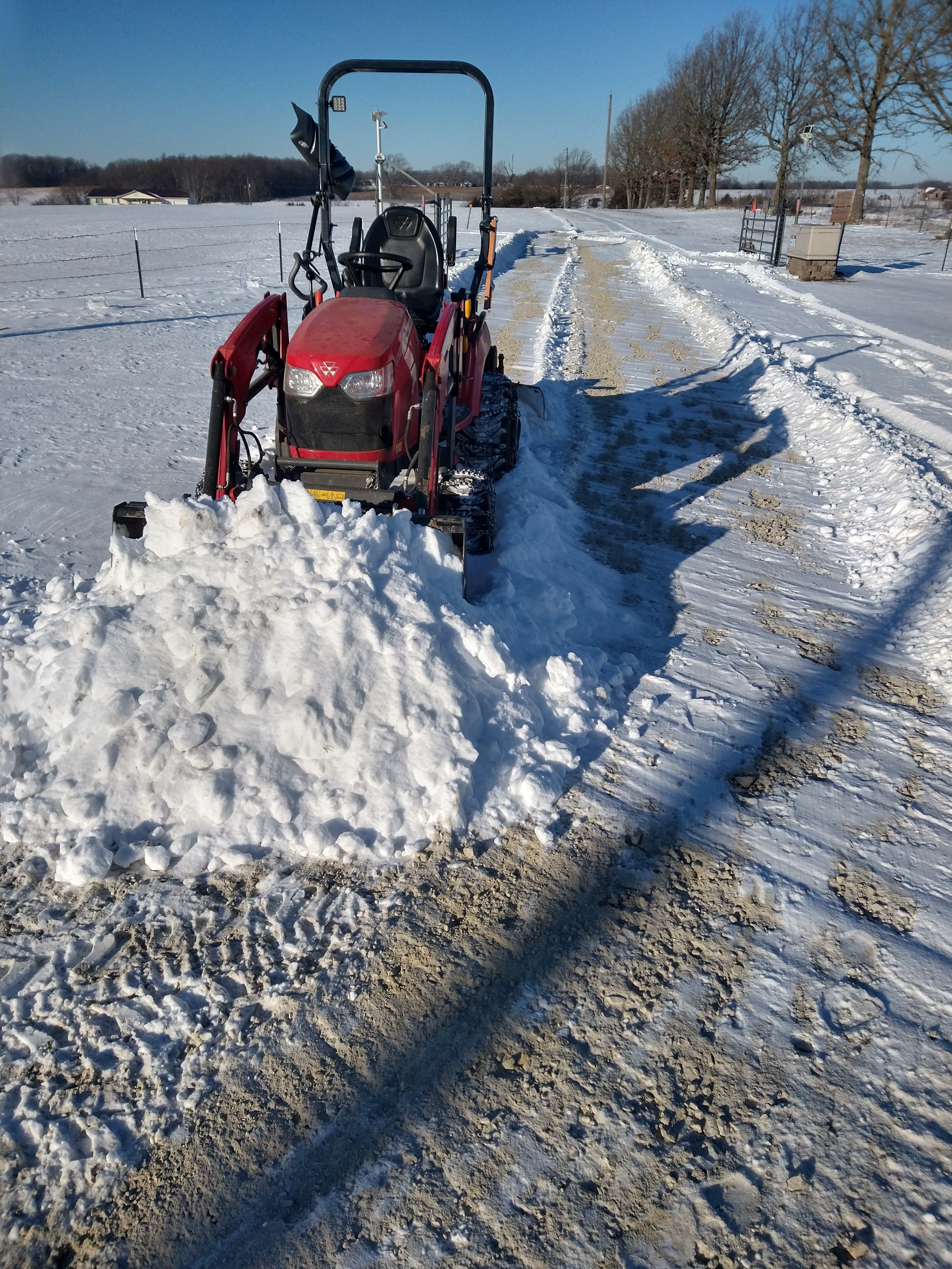

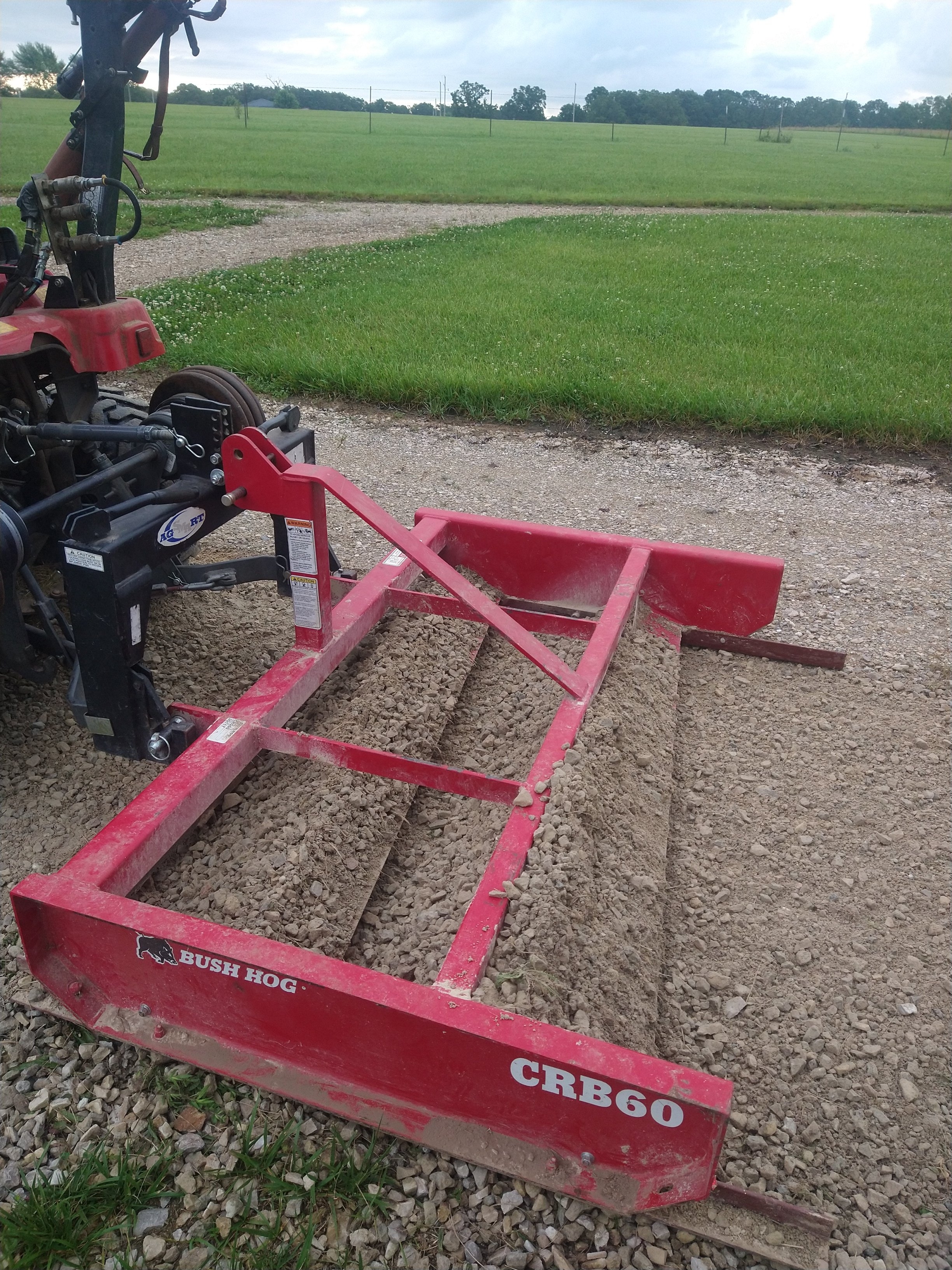

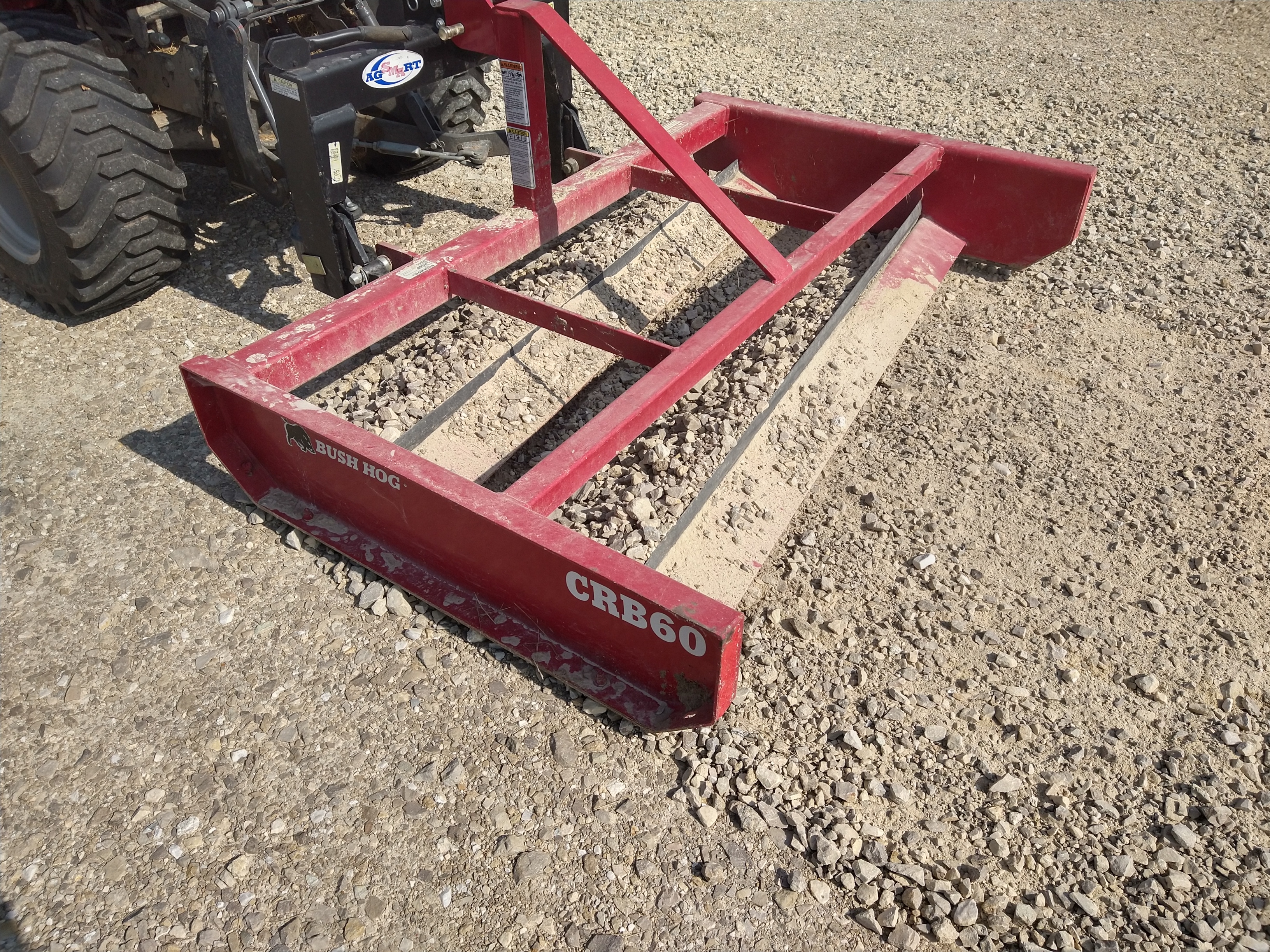

A rear blade is much different than a "grading scraper" ... Lots of times called a "land plane", Bush Hog calls mine a "road grader", the blades are fixed ... Looks like this, and is only 60" ... Which my 25 HP SCUT with tiny 26" rear tires pulls in high range without any problems ...
For a rear blade ... I'd also recommend a much wider than tire track blade ... Here is a 72" behind my 50" wide SCUT ... Not much extra sticking out!

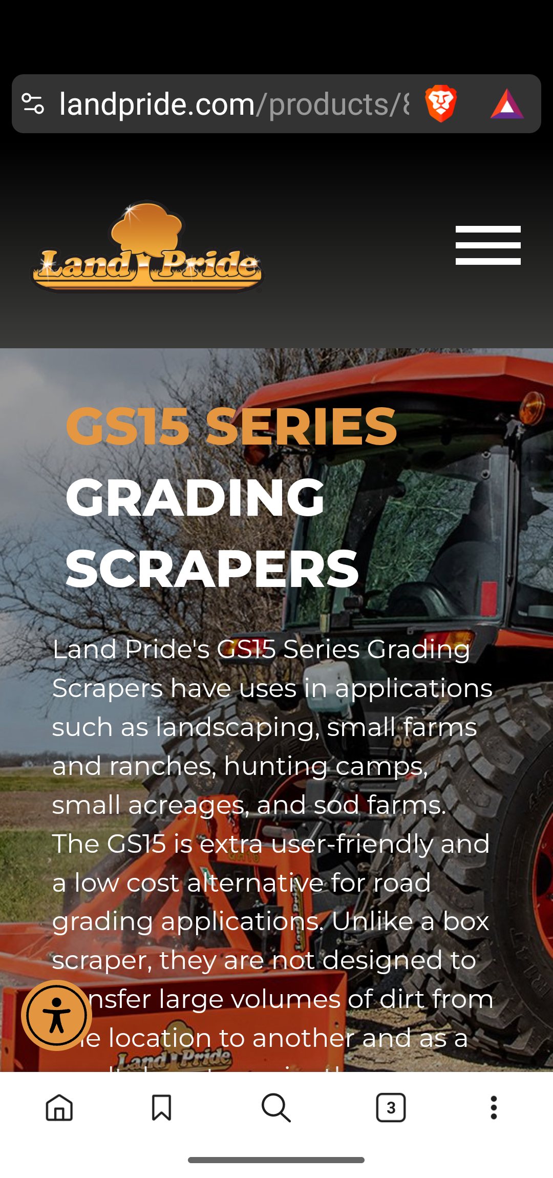

The Landpride GS1560 weighs 511 Lbs, with the 4 scarifier shanks ...
My Bush Hog Brand 60" doesn't weigh as much, but my Little SCUT pulls it no problem.
Shawn T. W.
Did you add those pieces of angle iron to your 3pt landplane or were they their when you purchased it? If you added them, what was the purpose?
If I continue to use my homemade landplane very much, I am going to have to replace the skids on it or weld some metal onto the runners. Mine runners started out as 3/4 x 2 inch flatbar that came off of my "Ugly Trailer" project.

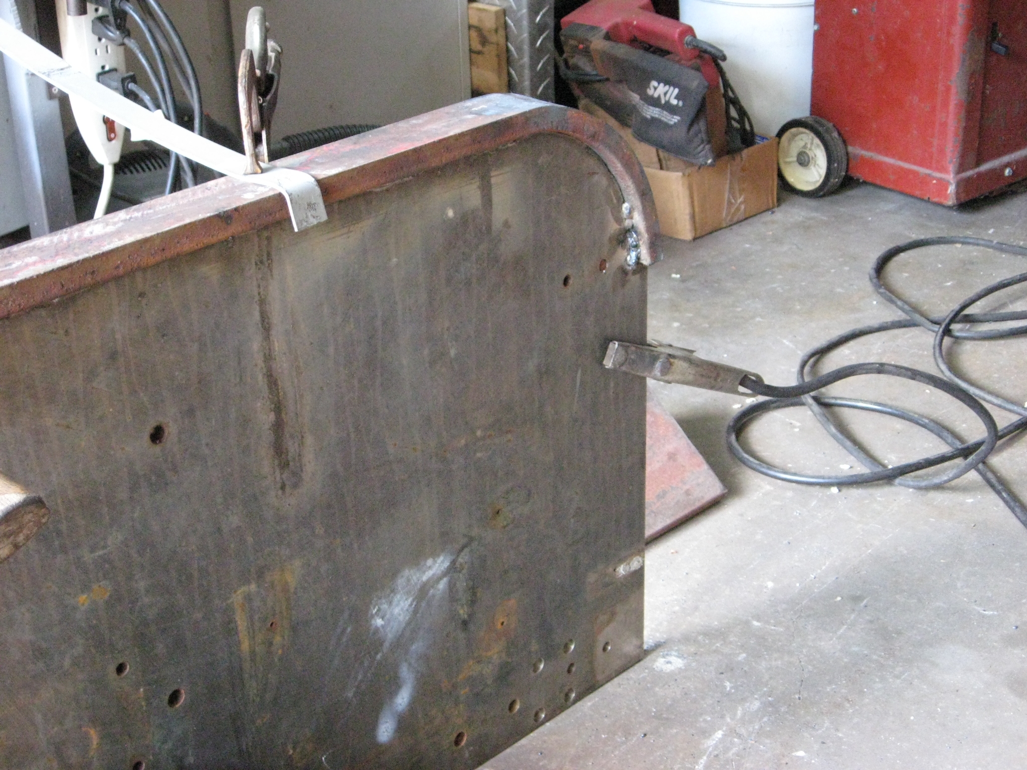

I am going to post a link to my old Duragrader link (call it a Dava grader)
DO NOT CLICK ON THE PICTURES TO MAKE THEM LARGER AS THE PHOTOBUCKET LINKS ARE NOT ANY GOOD.
You should be able to see them pictures on the link clear enough to see the angle iron that I used to make my skids.
David from jax
/ Grading Scraper #26
Here are pictures of the sides and bottom skid so you can see them better.
David from jax
For two reasons ...
#1. I wanted to reduce the amount the blade hung down, or dug in ...
#2. I wanted a longer runner to avoid the slight dips the factory (they way I bought it new) 32" runners left, so the 50" now eliminated that ... 50% longer runners!

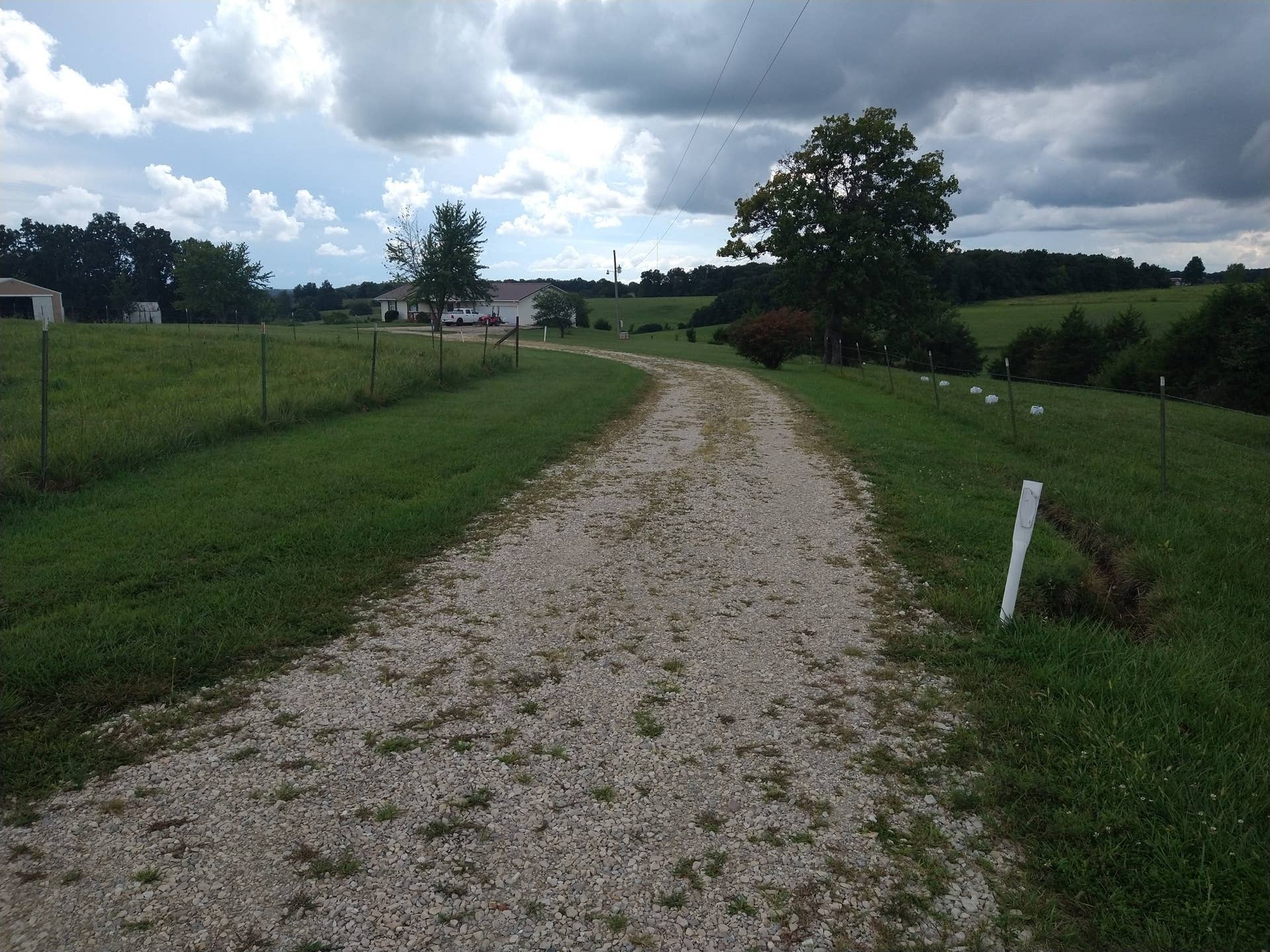

Yes, I tend to go up, then back down OVER what I just did, usually two trips up and back, so each piece of ground is hit four times, I'm mostly doing weed control now that I have my driveway done ... It's also better a day or three after an inch of rain ... When it's dry like this, it's tough going ...
My driveway looked like this after a weak dose of glyphosate, which I'd rather not use ... It was getting out of hand on my driveway, so I sprayed it ...
It was recommended on another forum to triple my strength, and wait another week ... So I sprayed it again!

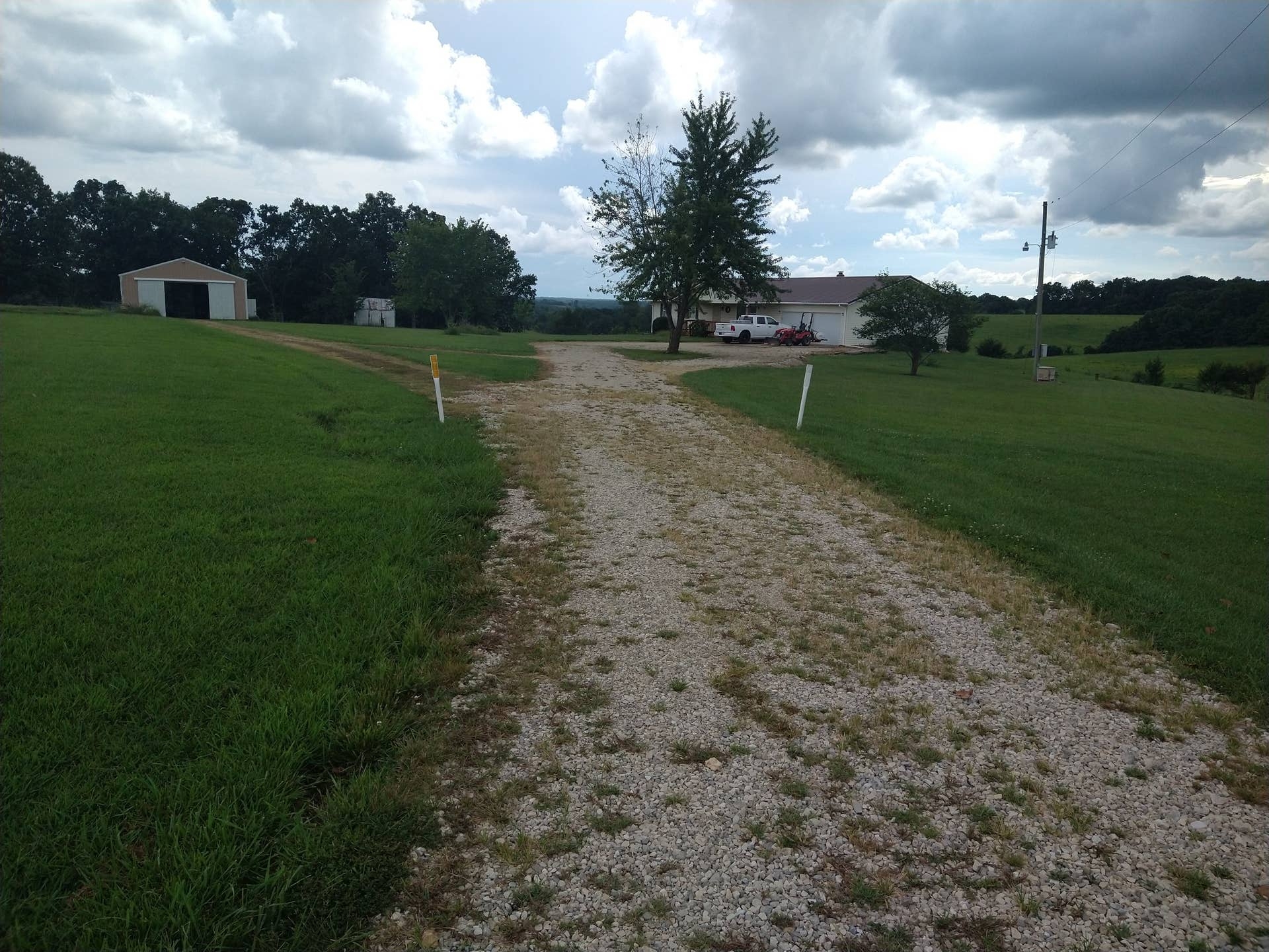

The next time home in about 10 days it was a bit "damp" out, but I ran the land plane anyways, as that's when I had time!
You can see how wet it was here ...
Since the blades only stick down 1/2" now, they don't upset the weeds with longer roots, unless one of the little teeth hits them ... So I want to do it more often now ...
