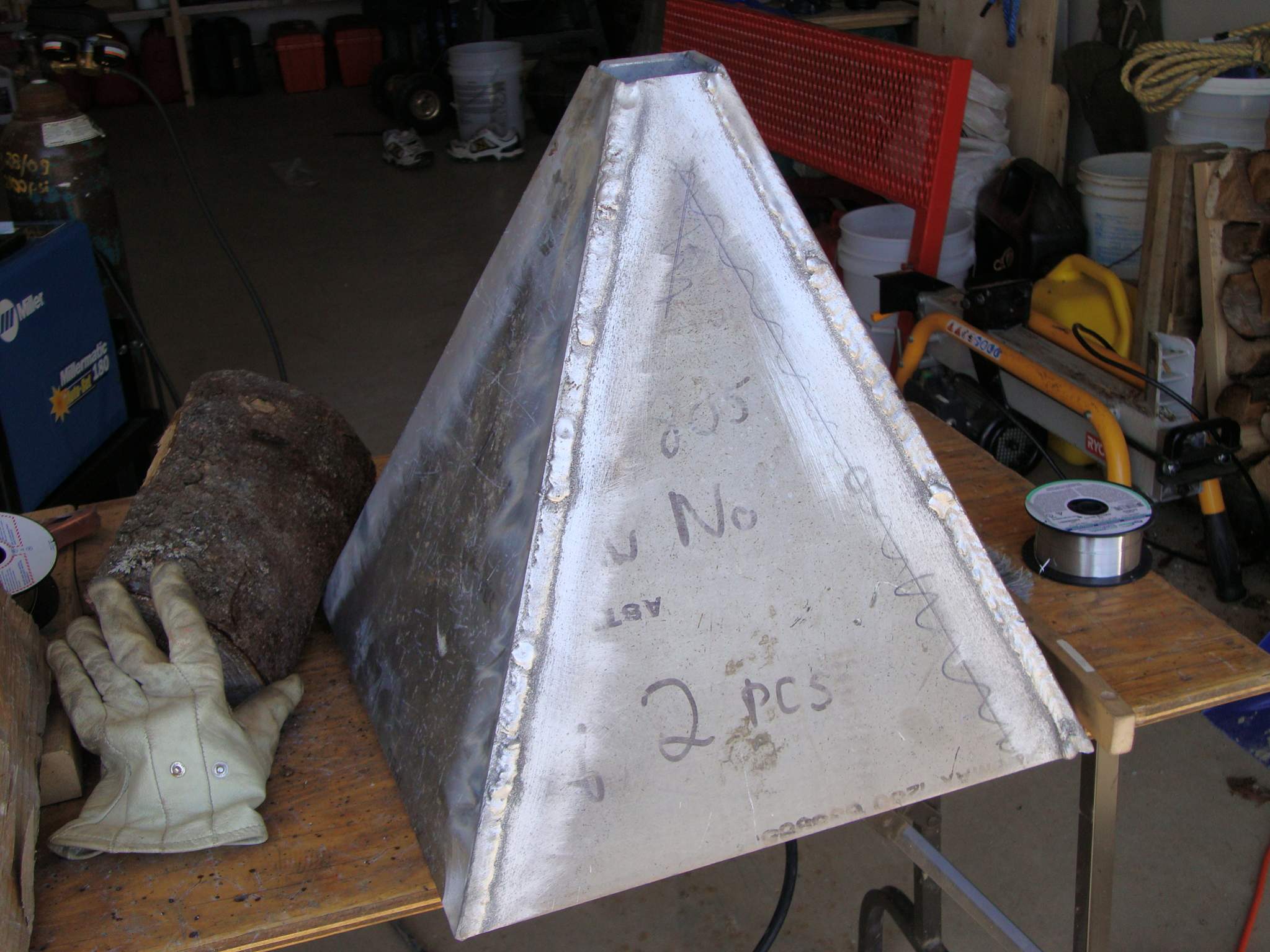

I use a skidding cone for the nose of the log so it doesn't get hooked on everything it passes.
Which skidding cone do you use? I've been contemplating buying one, the big yellow plastic one but have never been able to actually see one first...
Oh - and nylon rope? You are a brave man, that stuff stretches and stores a lot of energy. :cool:
I built mine from 1/4 inch aluminum plate, the nose is reinforced with aluminum pipe, and I added a chain carrying handle to one side. It's 18" across the bottom and about 2 " at the top opening. You put a chain choker on the log, extend the chain through the cone and snug the cone up on the butt. A grab hook where the chain emerges from the cone keeps the cone in place.
Sean
