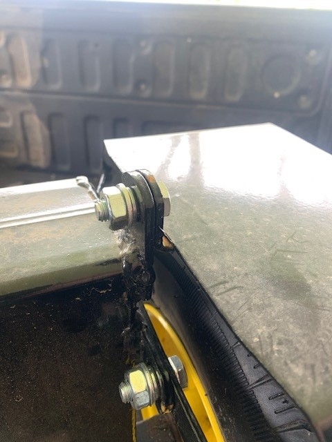

We'll have to compare notes on the Champion. I bought mine at Home Depot and it was already assembled. Although, I'll probably go through it myself. I'm a stickler when it comes to assembling things using locktite for parts that need to stay together and never-sieze on parts that need to come apart.
The first thing I'll do is add some lifting eyes, so I can easily lift it with a chain to put it in/out of my truck bed/trailer.
While checking it out, I did notice the Home Depot folks put all the cut lock-washers on the wrong side of the flat washers when they assembled it. No big deal, I changed them around and also used locktight on everything that shouldn't come apart. A pet peeve of mine is nuts and bolts coming loose/lost, when an ounce of prevention is all that's needed.
