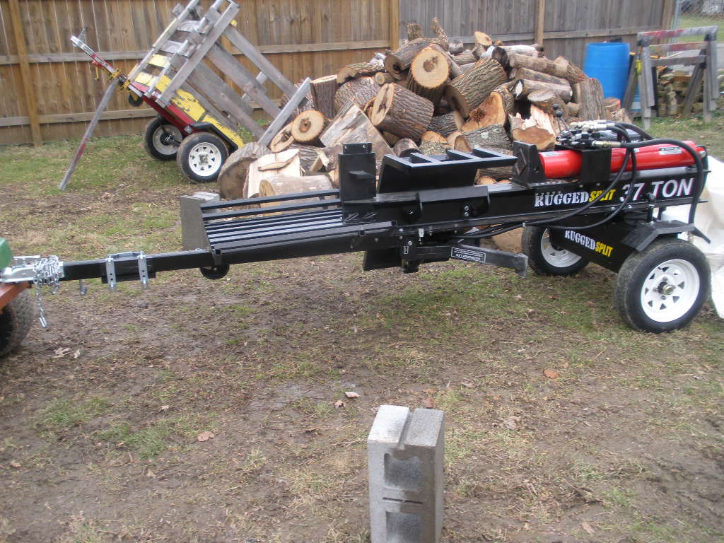

For me it would be counterproductive. One of my priorities for my splitter is speed. I want it as fast as possible to get to the wood, and then retract fast so I can put another piece in place. Hooking the throttle control to the lever would be ok, since I would not be doing anything with the lever in the neutral position. But when I move the lever forward or backward, I want it to get on with it.
Yes, and a pressure switch will not accomplish this as it would only rev the engine when there is resistance on the cylinder. You would want it to rev anytime the cylinder is moving.
I thought he just wanted it to rev up when he encountered a tough piece to split and run at half throttle the rest of the time. Anyways, a pressure switch would still work I think, just have to set it to where anytime there was pressure it would activate the throttle solenoid. I dont know how much pressure my splitters build on cyl retraction, but it does build some pressure, Take more fiddleing with than its worth I think, but doable.

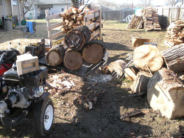

my splitter has a hydraulic lift table & it does take a while to load wood onto to the table & all the while the engine is running
at w o t auto throttle would come in handy, just go over & push down the throttle.. & turn it up again .no need to

the table will hold several pieces.
