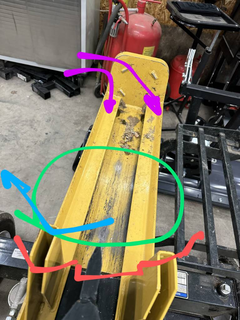

I took a break from everything else and walked over to the shop to snap a photo of the beam and wedge, as requested. Perhaps the flat end may need some more aggressive rough edges to help keep the wood from slipping.
Taking another look at the end of the splitter, I see that the beam design is effectively dished mostly to provide a channel for the wedge to ride in but also to cradle the log.
This dishing may contribute to an ejected log's upwards motion.
In my crappily marked-up picture, the purple arrows point to the dishing, the red is an exaggerated cross-section with a (green) log in it, and if the log moved sideways (blue arrow) it will encounter the dishing and be ejected upwards and outwards.

I see what you mean, that little lip could make it pop upwards. The one time I did have a split fly a little bit it was straight sideways.

I wonder why most splitters seem to have the wedge as the moving part? On my inexpensive HF one, the wedge is stationary.
