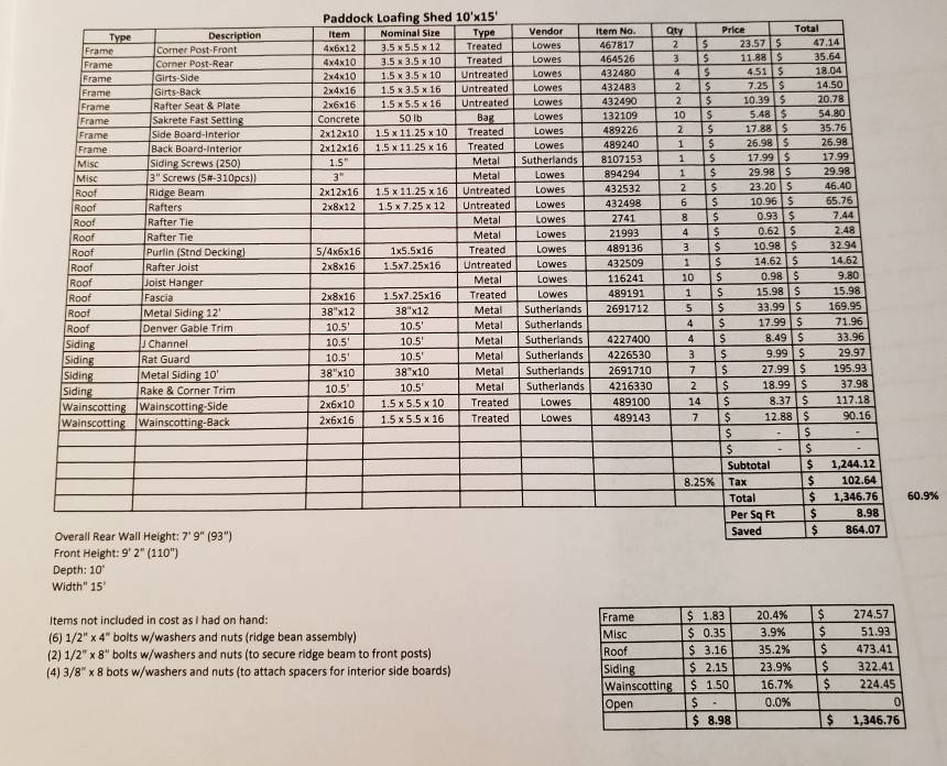

My finished cost will be approx $1300. I probably could have shaved off $100-$200 with lesser quality products, but I wanted something that would last and have value. I originally got quotes to have it it built and those came in at $2200 to $2300 and used only untreated 2x4 for everything except the corner posts and no wainscott.
I will post a complete material list with costs this weekend.

That is a darn good price for a very useful shed.
I thought the same. When I first costed it out and then compared it to the quotes I had gotten, I thought maybe I had made a mistake. Double checked my numbers and quickly decided I would build it myself. A better quality shed for roughly 60% of the cost to have someone else build it. Besides, it's been a fun project and I have learned a lot about building this type of structure.

Picked up the trim yesterday, but will have to wait till next weekend to finish....had some minor freezing rain during the night and expect more rain today. However, I was able to finish the material/cost list so I thought I would get this posted. I also broke the costs down into the basic components (roof, siding, frame, wainscotting, misc). This might help identify where costs could be reduced. For example...2x6s for rafters instead of 2x8s might be an option. Another example...plain corrugated panels instead of painted premium siding panels for the siding and roof might be an option.
Will post pictures when the trim is finished next weekend along with some better pictures of the interior and ridge beam/front post setup.
