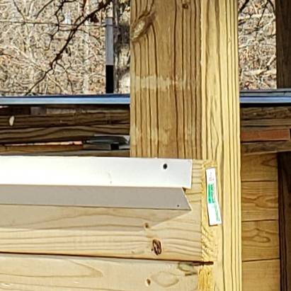

What is a "rat guard"?
   / Loafing Shed Build: Day One and Two
#32
Rat guard serves two purposes; provides a shelf for the bottom edge of the metal siding to sit on and keeps pests from entering. I use it as a shelf for the siding. Here is a close-up picture: 20190128_101236.jpeg

Rat guard serves two purposes; provides a shelf for the bottom edge of the metal siding to sit on and keeps pests from entering. I use it as a shelf for the siding. Here is a close-up picture:View attachment 589112
Thank you. All of my experience with metal has been doing roofs. I've never installed it on a wall before.
