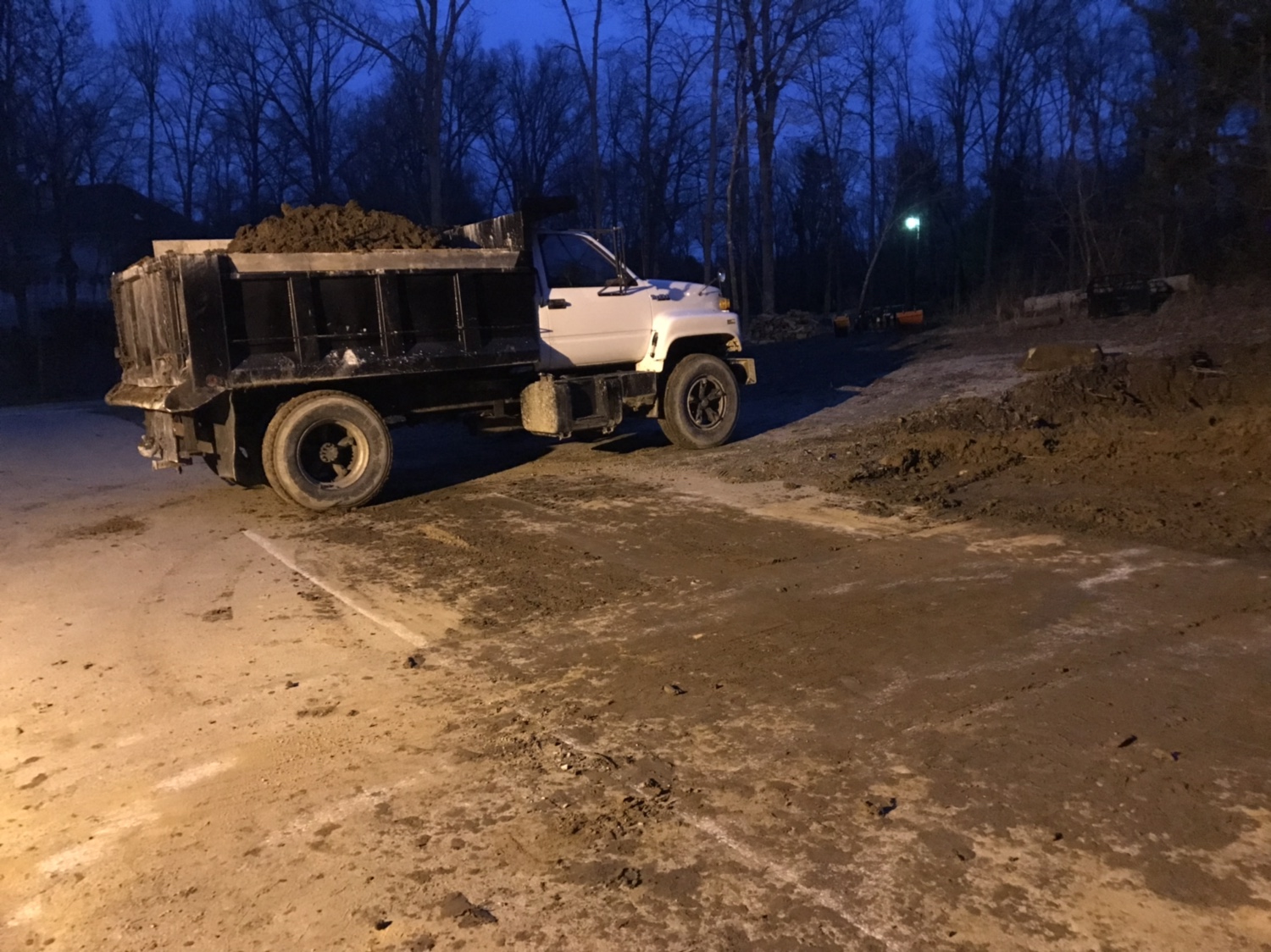

I load my single axle dump with my M59. I don’t think there’s much difference in bed height with a tri axel. IMG_7955.JPG

Here’s my M59 over the side of my 6500 which has sides a little over 50” on it. It’s easily a foot over the sides. You can’t put on a heaping load unless you built a ramp but it’s loadable. IMG_8521.JPG
