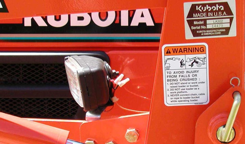

Here's what I did. The lights are mounted to the fixed part of the loader frame. My tractor sees a fair amount of "night shift" work. The position of these lights keeps them protected. Another benefit in Summer is having bugs attracted to the engine area instead of the ROPS. The (flood pattern) lights are angled out slightly and provide almost 180 degrees of good lighting.......................chim

From the front. The combo of the factory lights and the add-ons work pretty well for loader operation. The factory lights by themselves are pretty worthless. When I mow at night, I use the added lights only....................chim
