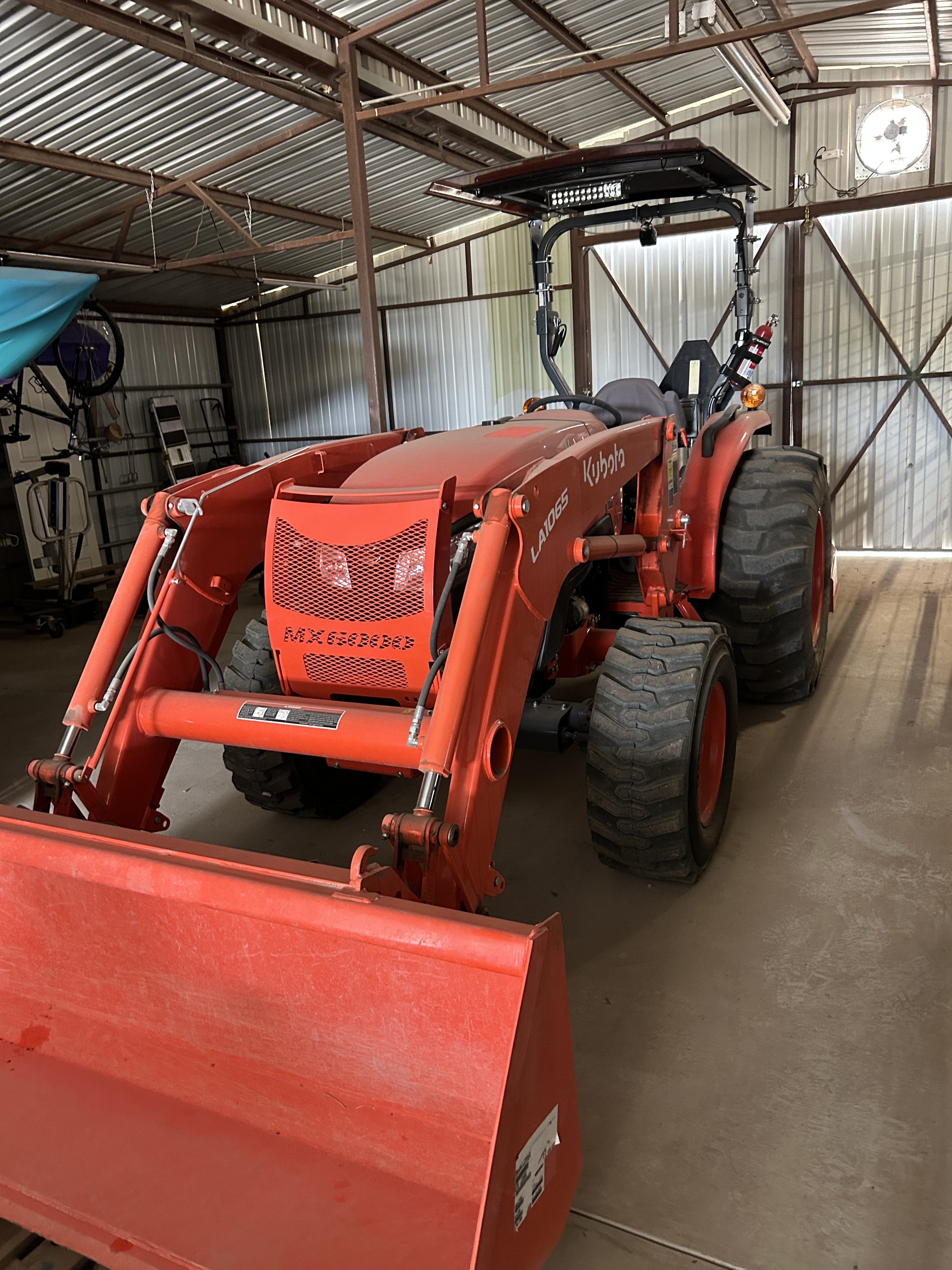

Dieselsvout80: “how helpful is that attic fan at controlling the temperature in your metal building?”
It does help some and is on a thermostatically controlled switch. It comes on when the temperature reaches 78 degrees. During the peak of the summer, we are in the 90s and it may drop the temperature about 5-10 degrees. Of course it shuts off at night. Next year I’m going to run it continuously so it can pull cool nighttime air through the building and see what that does.

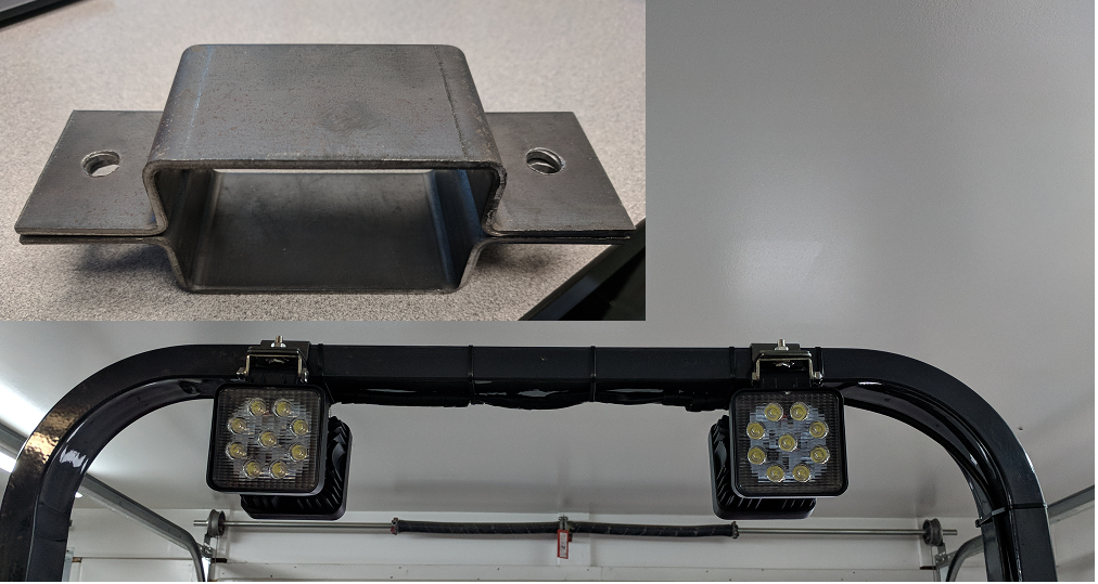

Made these pinch brackets, mounted forward and rear facing lights, no drilling into ROPS.

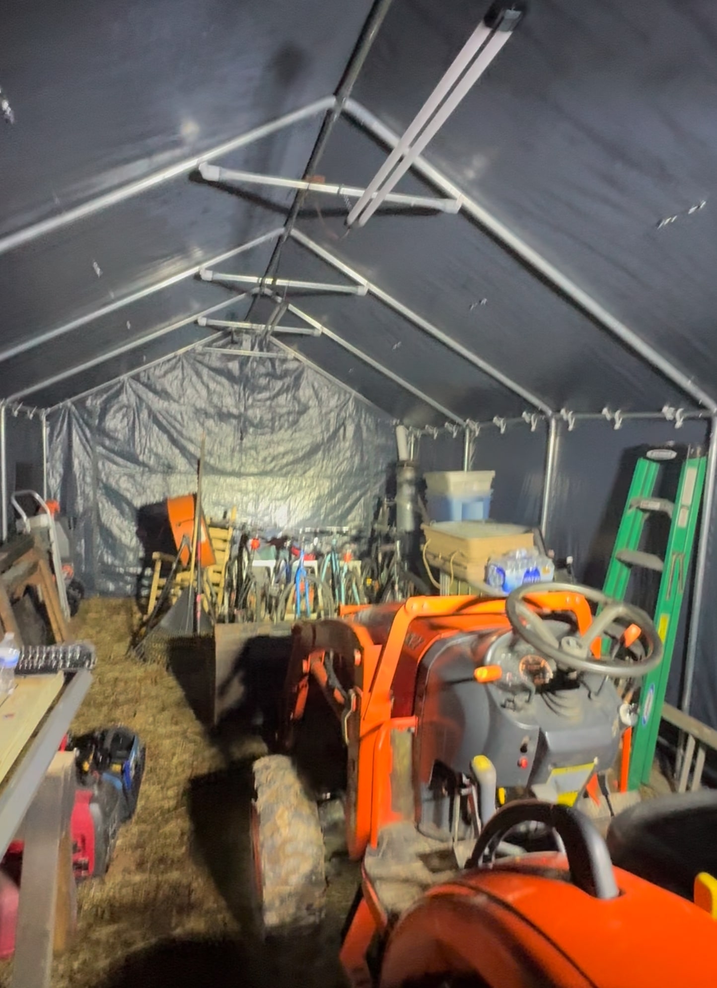

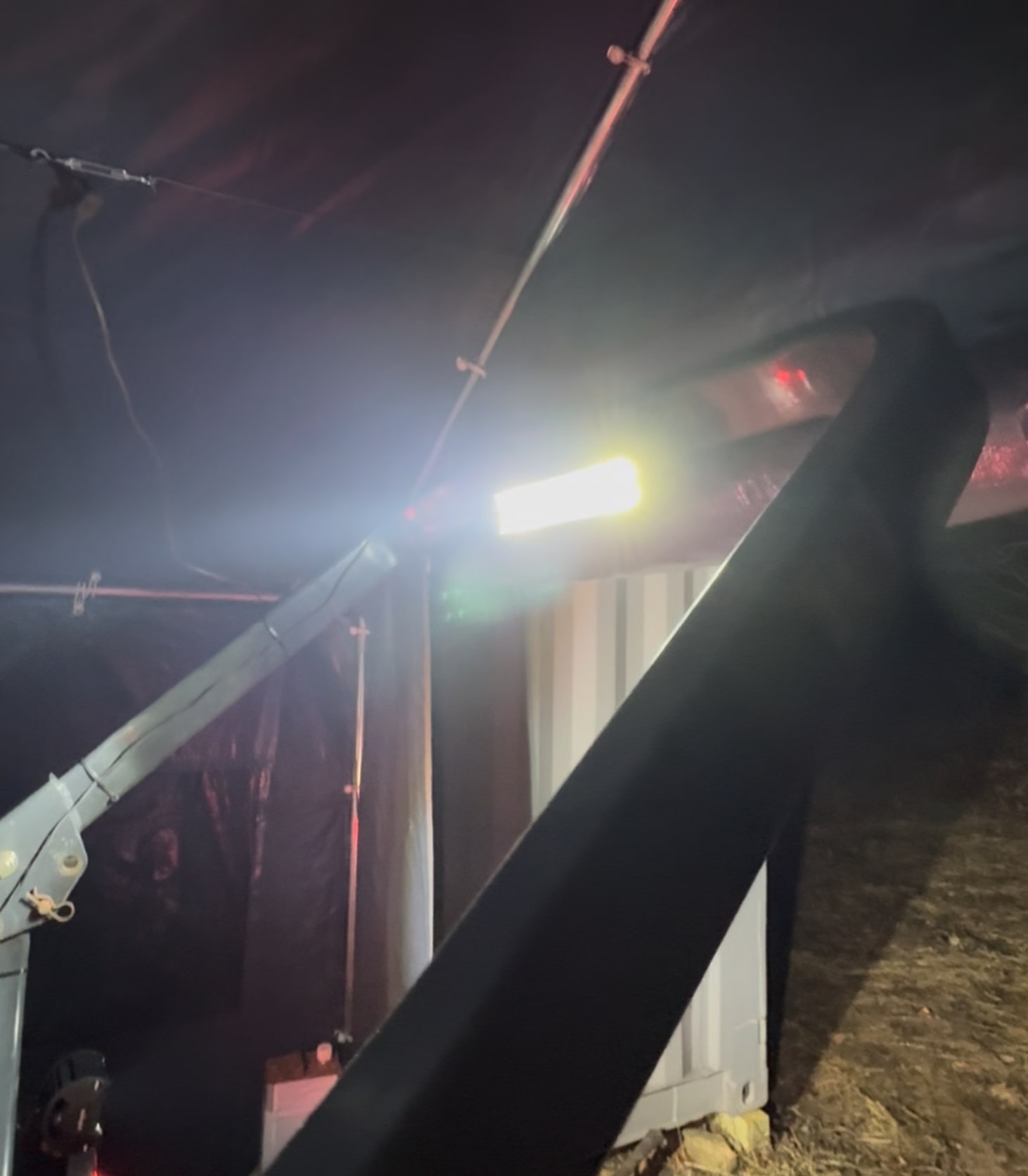

New here, new to me tractor. Kioti CK 27. I'm pretty blown away by my $37 Nilight 3 light combo I installed last weekend. It's getting dark about 4:30 in my valley in the winter and I'm just getting warmed up usually by then. I'm sharing this because it's a great value and taylor made for a small tractor. I only had to extend the wiring for the top 12" light bar, the rest was plug and play. I did borrow a few ft. of wire from the worthless original ROPS side lights that everyone tears off. Mine were already long gone.
I wired this directly to battery on my tractor so I can leave the lights on with tractor off. What I can't show is how well the kit is sized and made for a tractor this size. Happy to take more/better pics of the install for anyone interested in a cheap and effective solution.
