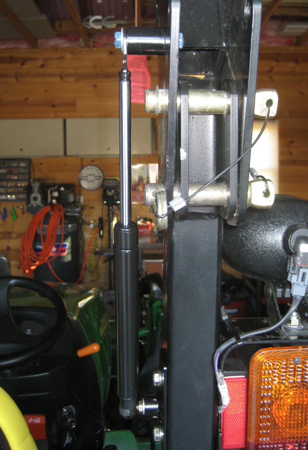

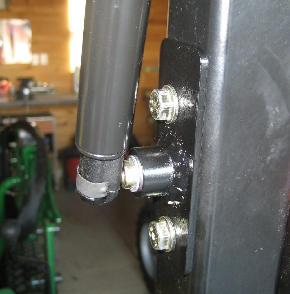

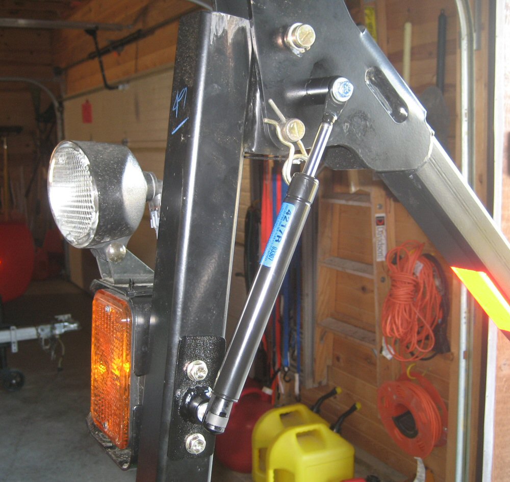

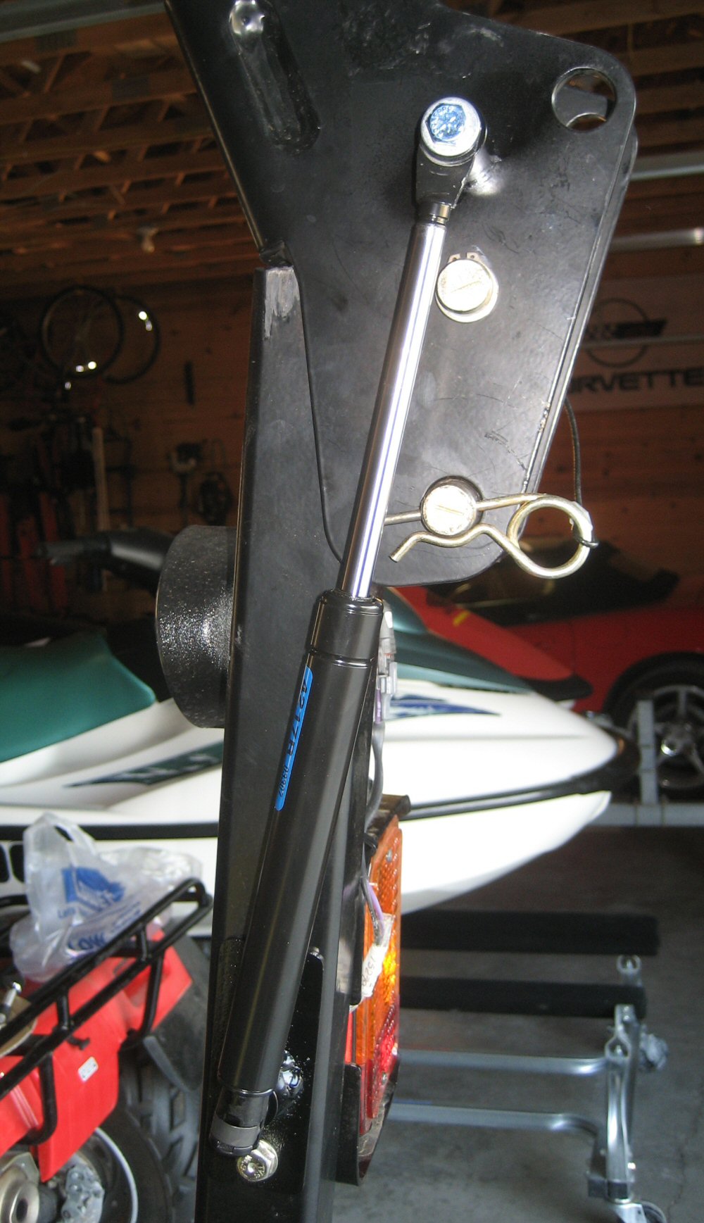

Okay, I am lazy. I hate to get off the 2520 before and after mowing to raise/lower the ROPS. I fabricated a gas lift assist and wanted to share. The total cost was about $30 in parts not counting scrap metal and 2.5 hours to do the math and fabricating.
I bought a heavy duty gas lift so I would only need one cylinder. Once I have the math done, I fabricated the bracket and spacers. The entire install only required one hole be drilled in the ROPS bracket and not the tube. I used the existing light bolts to install the lower mount.
Now I can lower and lift the ROPS without it trying to rip my shoulder out of place. I can even drop the ROPS and it won't slam down!

Great job! Great Idea! Looks like it belongs there!

Could you tell me what size, brand and store you purchased the gas strutt from? I am also wondering if you could indicate the "math" measurments for drilling the hole in the top ROPS bracket. This is a fantastic idea and would like to do this also on my father's new unite.

Great Ideal on the lift...
I notice in the pics you have aux lights mounted above the turn signals. Do these work good there. I was thinking of hanging them upside down from the top of the ROPS but not sure how that would work when the ROPS are folded.
