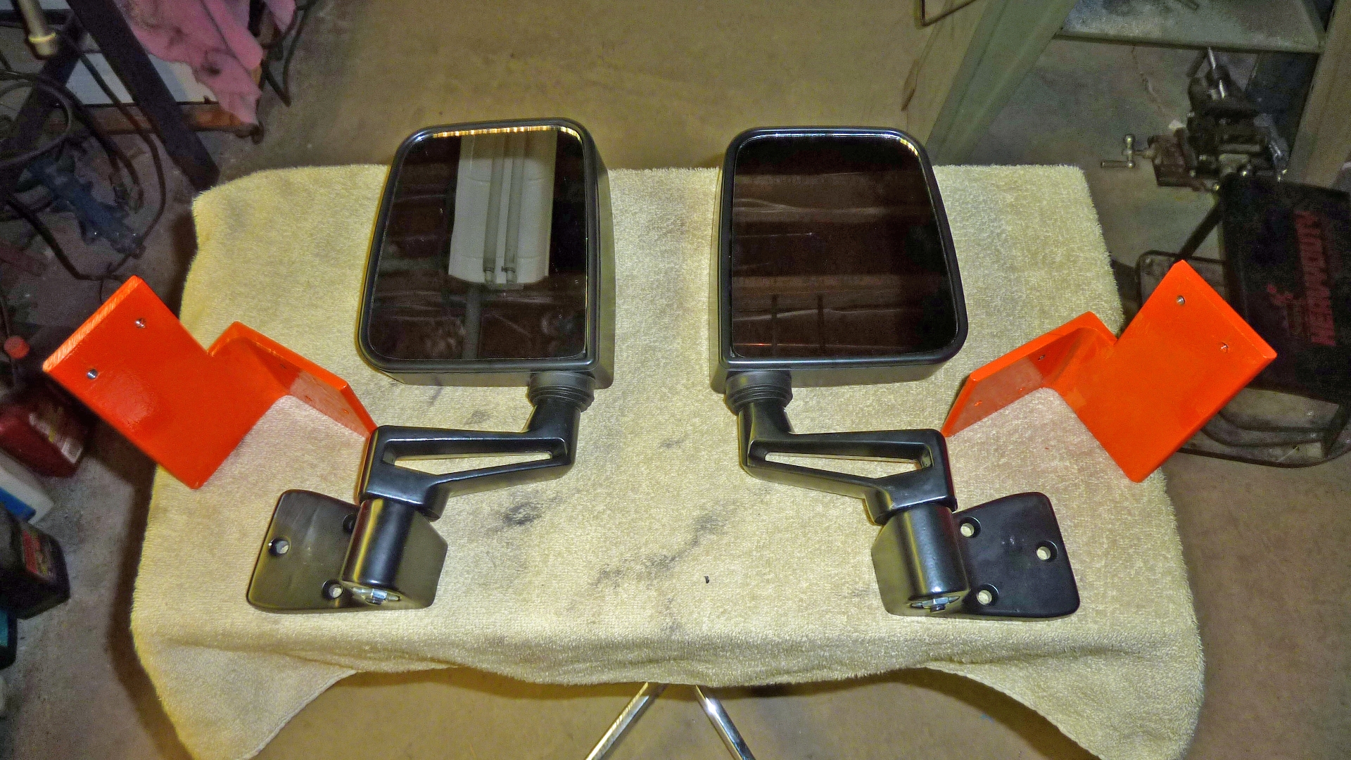

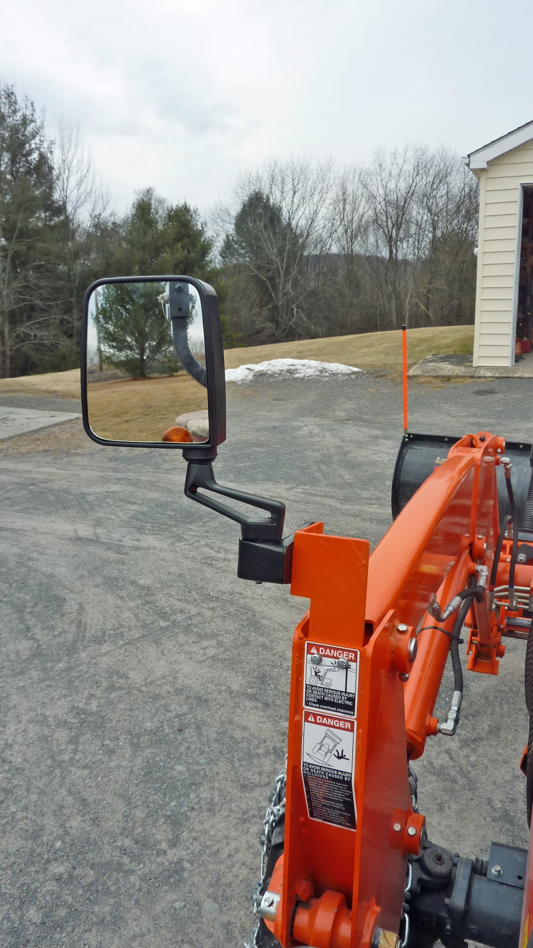

I used readily available and easily replaceable Jeep Wrangler mirrors. I bolted them to the loader supports using angle iron brackets:
They articulate and easily fold out of the way for woods work.
