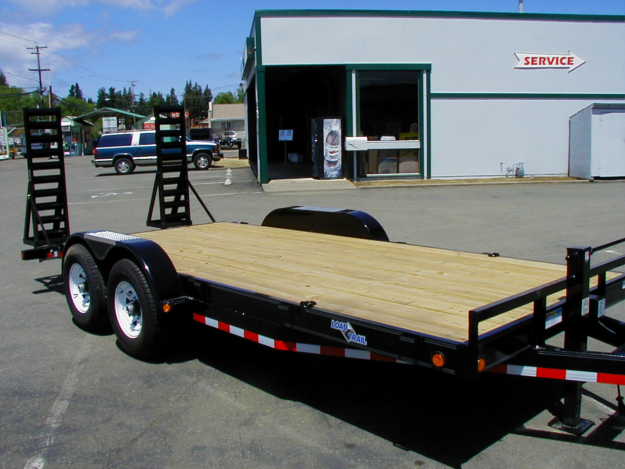

Has anyone had experience with this specific trailer. I love everything about it. The only concern I have is that it is so low to the ground... about 12" at the rear. That makes for a lot of dragging in and out of gas stations with dips at the driveways.

looks like a nice trailer, just not sure you need a low slung trailer to be easily able to load a Bobcat CUT, the tail dragger height could be an issue.
Also it only has automotive paint.
Lots of brands out there now with powder coating
Take a look at Novae Sure Trac trailers, lots of choices, and features
It is what I am looking at

I own a 7000# 2004 LoadTrail car hauler style trailer. I bought largely on price, and it was the cheapest 7K trailer I could find with 82" between the fenders. It has served me very well, and probably has less than 12" clearance at the rear which is a concern sometimes, but not a major one. The few times it has dragged have caused no damage to the trailer. I suggest if you are worried about 12" of clearance being insufficient, you buy a deck-over trailer.

I would take a good auto paint over powder coat anyday.
/ LOAD TRAIL "BOBCAT" TRAILER #5
I agree. I order all my trailers in black with paint, not powder coat. Its easy to touch up with just about any $3 can of Gloss Black Spray Paint. Powder coat looks great until it chips and rusts.

When loaded, is your trailer level? Lowering it at the hitch will raise the rear. I used to have a car hauler with a dovetail. It would drag in alot of places, but it never hurt it. I just did not like people looking my way with all that drag noise. JC
I have seen some steel wheels you could weld to the rear of the trailer to help with dragging.

Thanks guys. I settled on a Load Trail 14K 18' footer with fold up ramps and dual brakes... bumper pull.
