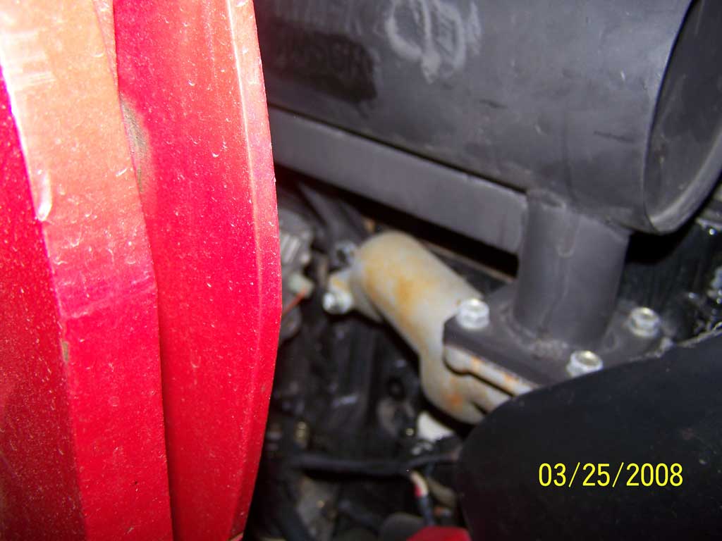

The only nit'pic issues I've had are ..... the rubber mat slipping, and the lower muffler mount rattling.
I fixed the lower muffler mount by using an extra washer, and will do the floor with spray on truck bed liner.

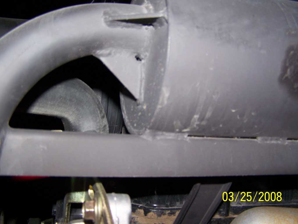

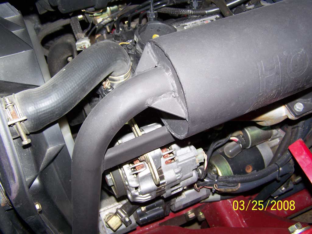

Looks good flyer. I'll try to post some pics of my muffler. Last summer TYM redesigned it putting a extra brace on it. My original one broke within the first month. You can look at the pics and see if you have the newer one. If you don't, I'd request it from the dealer.

Here you go. The long flat brace that runs the length of the muffler on the very bottom is the new part. My first one didn't have it and ended up in 3 pieces within the first 15 hours.

/ LITW backhoe on T273
I do not have that brace under the muffler. :eek:
I'll contact TYM and see if they will send the braced muffler before it breaks.
Hopefully they will send the new one (with the brace) and let me send the one I have back "after the fact". If not I will probably just make a brace using your pic's as a guide, and have my brother weld it on.
Thanks again for posting that Roady.
