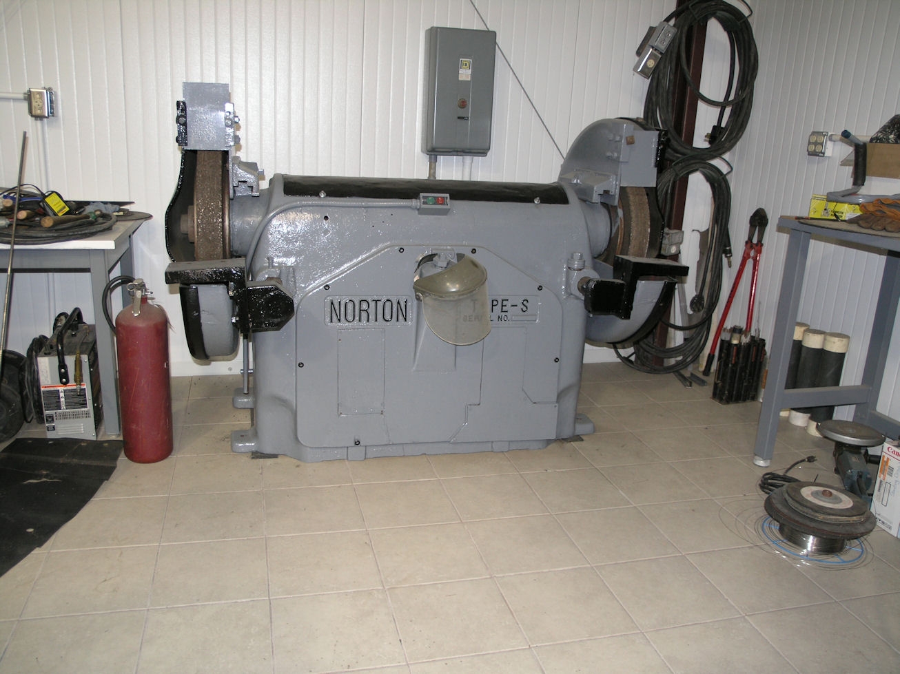

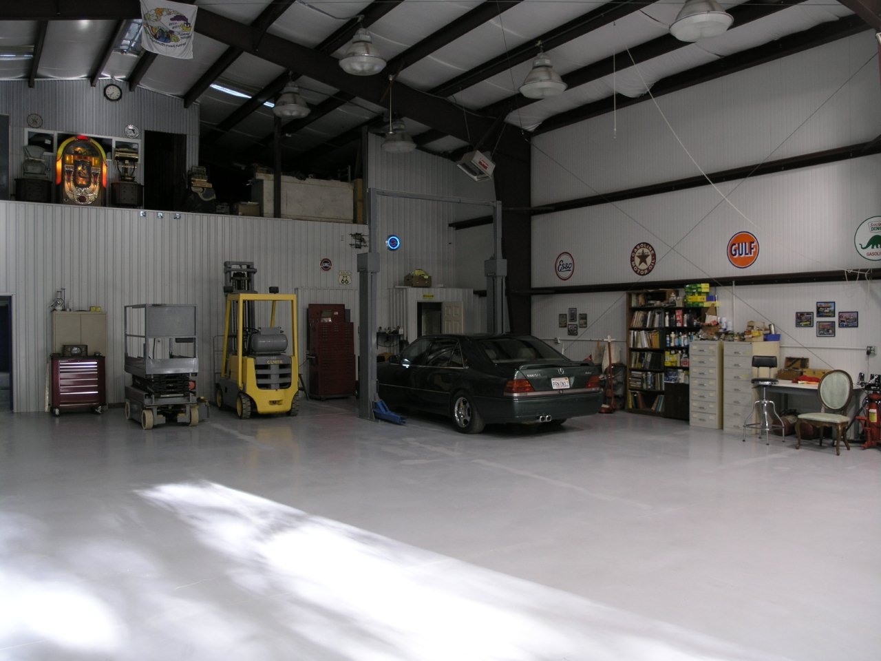

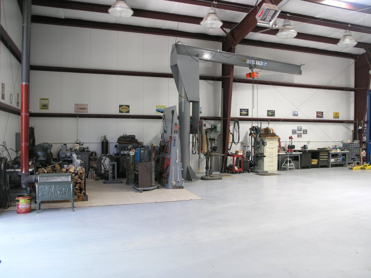

It’s called planning when you build if you want to work inside. I went with a 14’ door and 23’ inside. Also good for my pedestal indoor crane. Plus much more. Always build the shop first so if you run out of cash it will happen on the house. Excuse if needed is it’s a place to stay while building the house and save money by storing materials while on sale!
What do you use a huge grinder for ?
