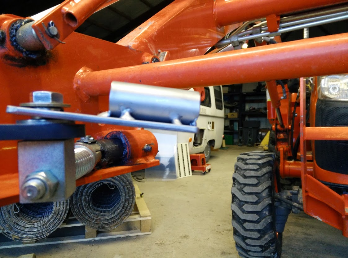

I'm looking at shoulder-bolts or studs threaded into the levers, and that's the only mounting, one at each end. We'll see if that works when I get farther along with the details. $250 for a drop in actuator vs. $150 actuator plus 1?,2?,3? custom "machined" pieces seems (on the surface) to be a no-brainer, at least to me. To each their own.

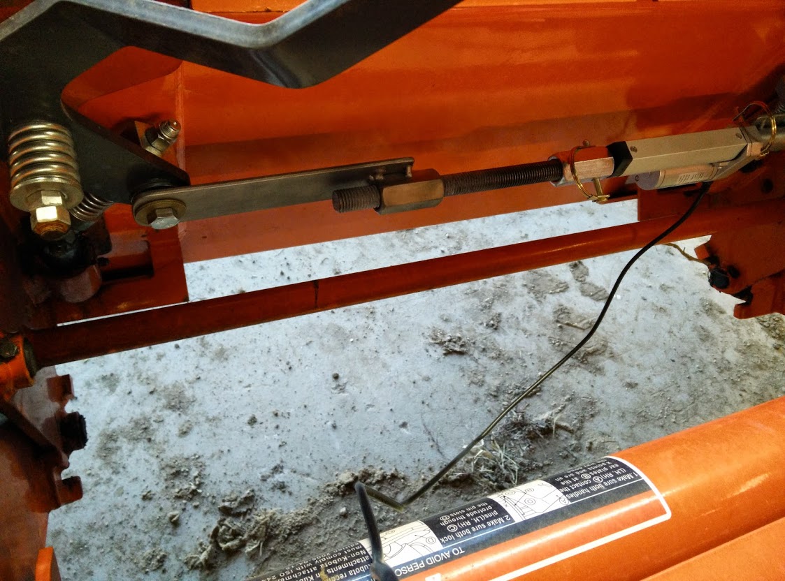

Wow. I had the 400lbs one in my Amazon cart just waiting to go on my next Amazon order. I ended up actually using the tractor a bit today moving a few things around & can't believe how handy this mod is. The really surprising thing to me is the fact the cycle speed isn't that relevant to using the thing. I flip the switch 30 seconds before I go to dump the implement & it's ready to go when I get there. Latch time is similarly irelevant. Grab the impliment, tilt the SSQA carrier back so it tightens up a bit, hit the switch & go. By the time I'm barely even turned around, much less where I'm going it's latched (or at least as latched as 4" is going to get).
Really happy with how this mod is working out.
Also the 4" while clearly not enough actually gets me 90% of the way latched every time so far. Safe enough for puttering around for now until I get the 6".
I need to put some more thought into what actuator I'm going to get now. I had more or less decided to upgrade, but am not so sure now. The $60 Ebay special seems like it might very well be up to the task (6", not my current 4").

7.5" of travel from levers (not pins) fully up to levers fully down, including them going way over center.
There is a little over 5" of travel between pins fully up & pins fully down, the remaining couple of inches is things throwing over center to latch. As the actuator takes care of preventing the pins from coming loose, the extra distance is moot for my purposes.
At any rate I think I'll have to modify my current brackets (or make new ones) so the bracket will hit the loader arm & bottom out (say 1/2" of free play before both brackets bottom out). That way the actuator will be forced to push both pins down rather than one down & one half way. It doesn't seem to be an issue with the 4" actuator, so I doubt it would be an issue with a 6", but better to be safe than sorry.

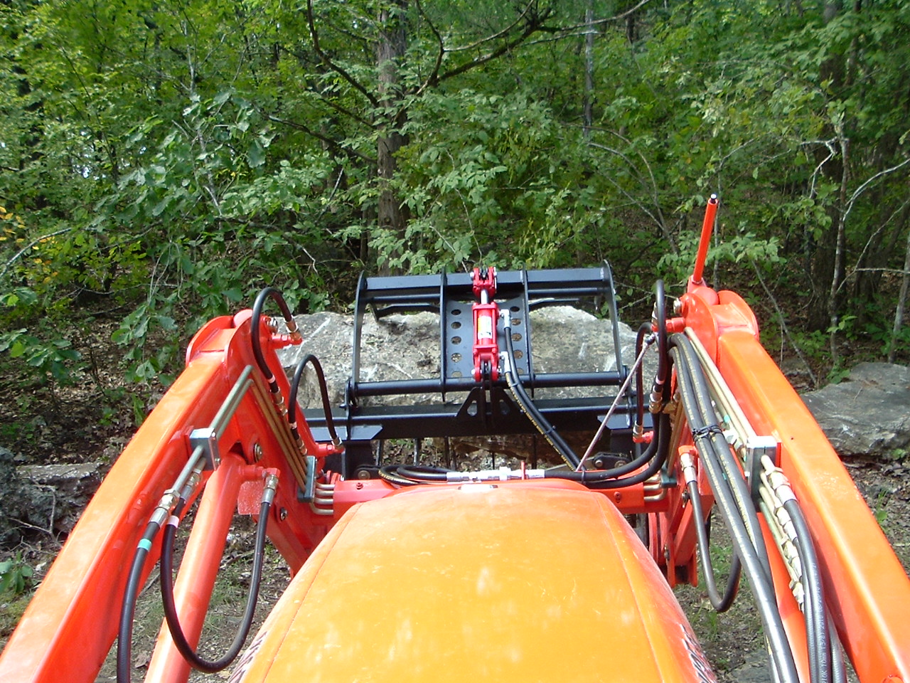

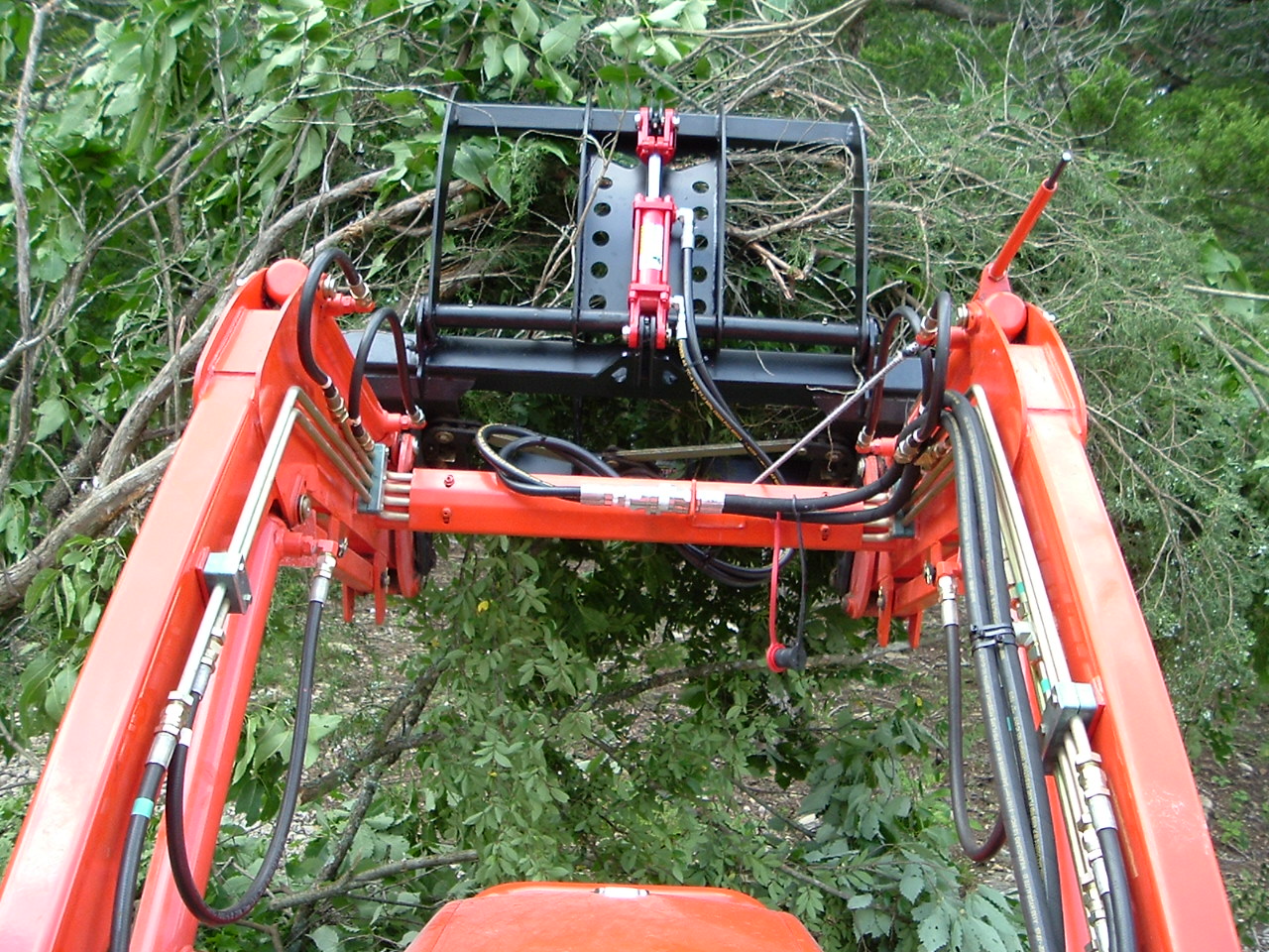

Yes our DK series (and probably the NX series too) Just have one Handle. Hopefully this will show up in these pictures. I can't tell much from the "thumbnail" pictures.
View attachment 418630View attachment 418631View attachment 418632View attachment 418633

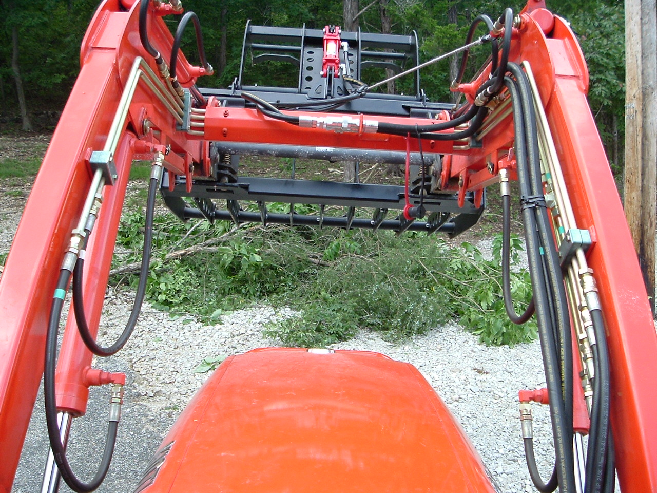

James, I love looking at pictures posted on here. I usually get side tracked and forget the purpose of the picture because of some detail I see that has nothing to do with the subject. Happened with yours. I like the bungee cord holding your hoses up out of the way!!!! When I'm running flat on the ground my Grapple hoses are lightly dragging the ground. Goin to town today to find a cord to hang mine with!!! :)
Yep, in mid span of the hoses, I put a couple of black tie-wraps, and hooked one end of a cheap bungie cord in the tie-wrap, and closed the eye of the bungie with a pair of pliers so it stays with the grapple hoses. Then hook the other bungie hook over a fitting and you are all set. When the grapple comes off, the free end of the bungie hooks to the grapple, and helps keep the hoses up off of the ground too! I like it better than the expensive spring idea. Cost about .50 cents
Great idea. And would probably simply break without any hose damage when you forget to unhook it from the tractor when dropping the Grapple. Not that I'd ever do that.....

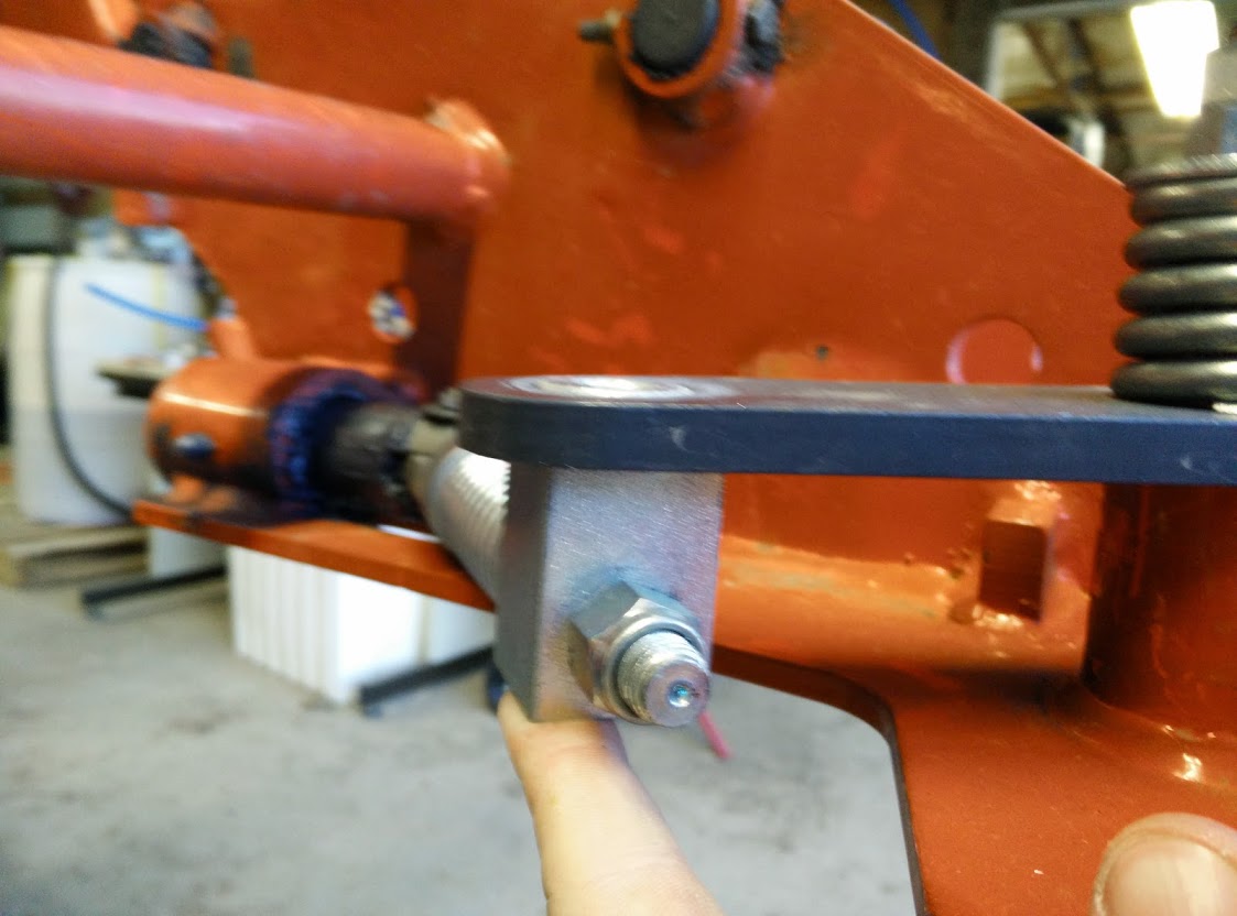

Apparently I left the 400lbs actuator in my amazon cart when I checked out & it arrived on Friday. I built the new brackets & tested everything out. Brackets are hanging while the paint dries. Only thing left is to let the paint dry, put it back together & get a bungee cord for a little better cable management.
The new brackets are just 2 chunks of bar stock each with 2 holes in them. 1 big hole with a bushing (thanks JMC) & one smaller hole to put a pin through to connect to the actuator. I left overhang on the back of the bar so the bar hit when the motor side was about to go over center. My first try extending the first bracket connected to the actuator & another bar on the other end ended poorly. The 2nd bar/bracket was a hair to long & as soon as both brackets hit the loader arms, unsurprisingly, the 15@ actuator popped the 10@ fuse. Replaced the fuse & trimmed the 2nd bracket so that there was at least 1/4" of slop total between the loader arms & the end of the brackets when at full extension. Works great now. I'll probably blow a fuse if I try to run the actuator with my ROPS lights on (same circuit), but it will provide good positive protection before breaking things.
The cheaper actuator works fine (as long as you get the 6", not a 4" like I did) if you don't mind it taking a little longer & my functional testing indicated that was not a problem. If anybody wants to pay shipping I'll send you my original brackets & the spare bushings I no longer need. You'll just need some longer bolts for the SSQA lever arms & a pair of captive pins or bolts to attach things to your actuator. Paint would be a good idea too.
