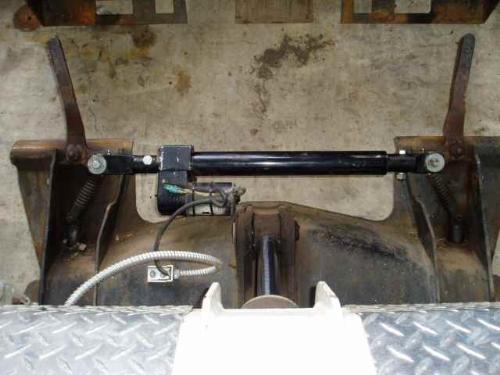

Well, it's mostly together & working about as expected. I'm happy with my mechanism & the linear actuator seems up to the task, barely. It struggles a bit, but doesn't seem to have any serious issues. The arms move unevenly, which really isn't a problem, unless you have to short of an actuator. It seems to work at the moment, but I could see it being a problem down the road ending up with one pin all the way down and the other only half. Probably going to end up getting a 6" actuator at some point & reuse this one for a different project if it ever becomes a problem.
Will post the video clip when it finishes uploading to YouTube here in a bit.
