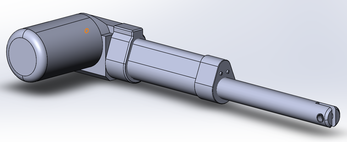

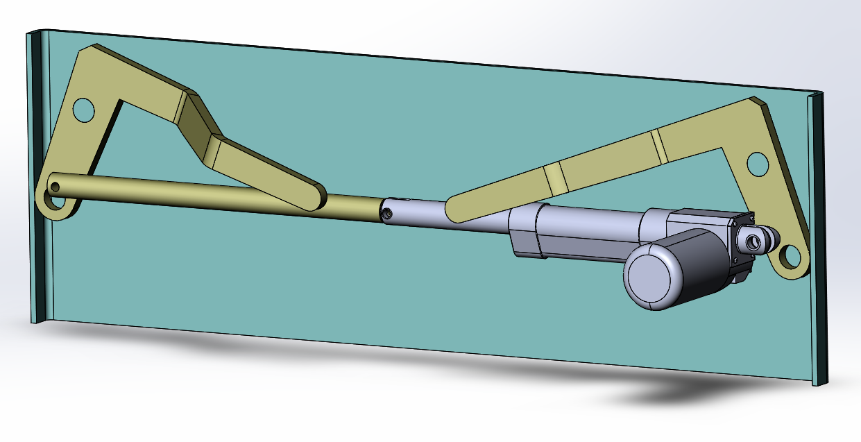

I measured the travel on my SSQA. On mine, the bottom bolt that attaches to the spring/pin etc. travels "exactly" 4". It is a 12x1.25x25mm bolt, according the the parts diagram.
As such.....
8" travel 100lb force actuator from here: Linear Actuator IP66 | Progressive Automations for $149
Replace the bolt that is there with a longer bolt and a nut (mcmaster numbers 91180A731 ($7.48) and 91415A235 ($9.41)).
Probably some washers 98023A033 at $6.00 or locally by the pound.
Seems like this should be able to be cheaper, but some tubing 7767T53 @ $45.16 (or, for another $100 they will make me a custom length shaft). Maybe some black pipe or something? Needs to fit over the 1.1" shaft without "much" slop.
Cost: 149+7.48+9.41+6+45.16 = $217
Still need wiring, plugs, and switches.
See mockup of one end mounting below:
Notes:
  • There isn't a quick-removal if the thing screws up. That was one goal I had originally, to be pinned on for easy removal.
  • With the 8" actuator, I am maximizing my leverage. As such, I'm pretty comfortable using the lower force (and faster!) longer travel actuator. I just didn't like where the 6" travel actuator needed to mount.
  • I don't have to drill holes, tap, or anything.
  • I DO have to lengthen the threaded section of the new bolt, I think. A tap is $6.
  • I am using the intended mounting (including fastener size) of the actuator
Thoughts?
EDIT: A chunk of 1" schedule 40 black pipe will work out real nice cause the O.D. is a bit less than my mcmaster number'd pipe above. Just need to drill/ream/flapper wheel the I.D. a little bigger to slip over the actuator's shaft. Likely easy enough. It's 1/2 the cost of the pipe listed above. Both prices from mcmaster. I think I need a 16" length, so this 18" piece for $8 is even better... LDR Industries 1 in. x 18 in. Black Steel Schedule 40 Cut Pipe-306 1X18 - The Home Depot
So the price would be more like $180.

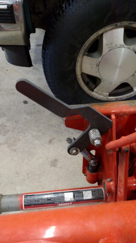

Looking at the lever, I may be talking myself into the 400lb version.....
The lever is probably 3x as long (or longer) where I pull on it, vs. where the actuator will be. I've had to put some oomph into it before.
Then again, that was cause one of the pins needed grease.
I'm torn........

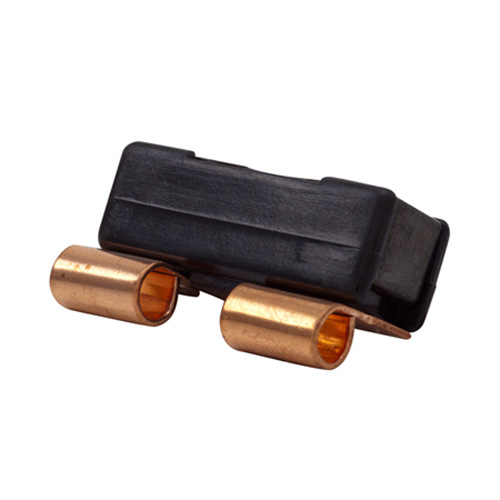

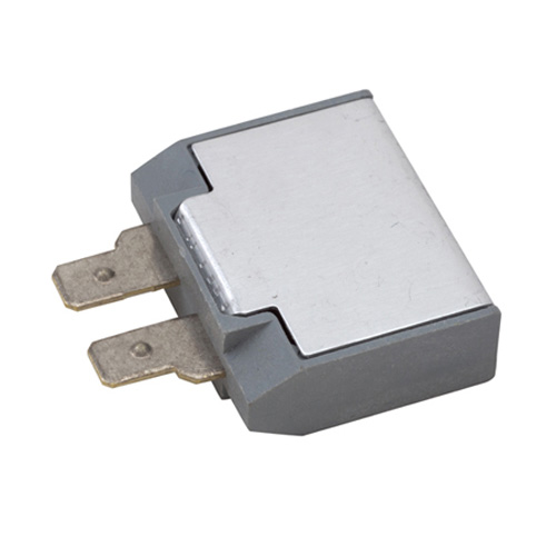

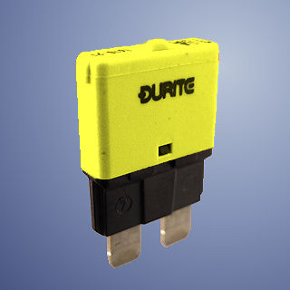

You may not have to rewire, depending on clearance, replace the fuse with a plug in circuit breaker.
0-380-20-blade-fuse-replacement-circuit-breaker-yellow-20a-3418-p.jpg12vcircuitbreakers005006.png72425_primary.jpg72605_primary.jpg
/ Linear actuator for power SSQA?
#113
View attachment 422620View attachment 422621View attachment 422622View attachment 422623
I looked at those briefly a day or 2 ago. The micro style breakers are auto-resetting & really tall. I'm not sure if they would clear the cover for the fuse box. I'm also not a fan of auto-resetting in this use case. If I forgot the switch down, or didn't notice it jammed, the breaker would continually reset itself every so often then immediately pop again negating some of the value. It's handy to have my bucket cam on the same circuit as it will turn off at the same time.
