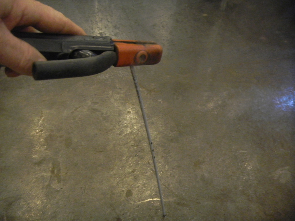

when i first learned to stick weld i was sticking every time i tried to start an arc. someone told me to hold the stinger loose grip, like really loose grip the rod would swing if you moved your shoulder. then strike it like a match. worked for me. just had too tight a grip.
