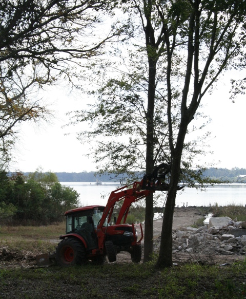

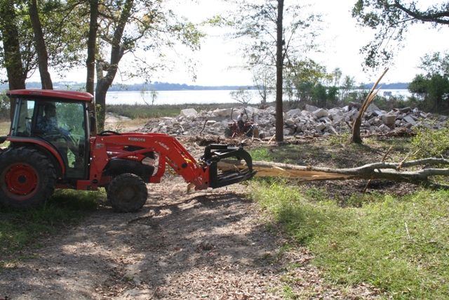

I have a L4240 Cabbed Kubota with the LA 854 loader. Tractor weights about 4K plus whatever I have on the back. The loader is rated for just under 2K. I have a Markham 48" Light duty grapple with double spacer tines on the bottom. I've down right abused this grapple and she's a bit dented but for the money and what I've put it though, it's way beyond light duty. I can understand a 68 hp tractor needing more and I agree with that. But the only damage I've done to the grapple has been my own fault and due to handling way to much concrete with it. Now I have R4 tires so I probably don't have the traction some do for pushing trees or uprooting but I really think you'd be fine with the light duty. Most anything big enough to damage the grapple we can lift. Here are just a few pictures of some work with it. That was a 10" Hackberry, and my pile of bulkheading material I'm moving. I've done alot more with it but the wife wasn't around for pictures.
