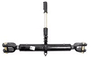

The new ratchet jack is set at 11 threads the original ratchet jack is set at 7 threads.
You are correct. I will make the exactly even before if do any mowing. I think I've pinpointed the bigger issue to phasing the lift cylinders.

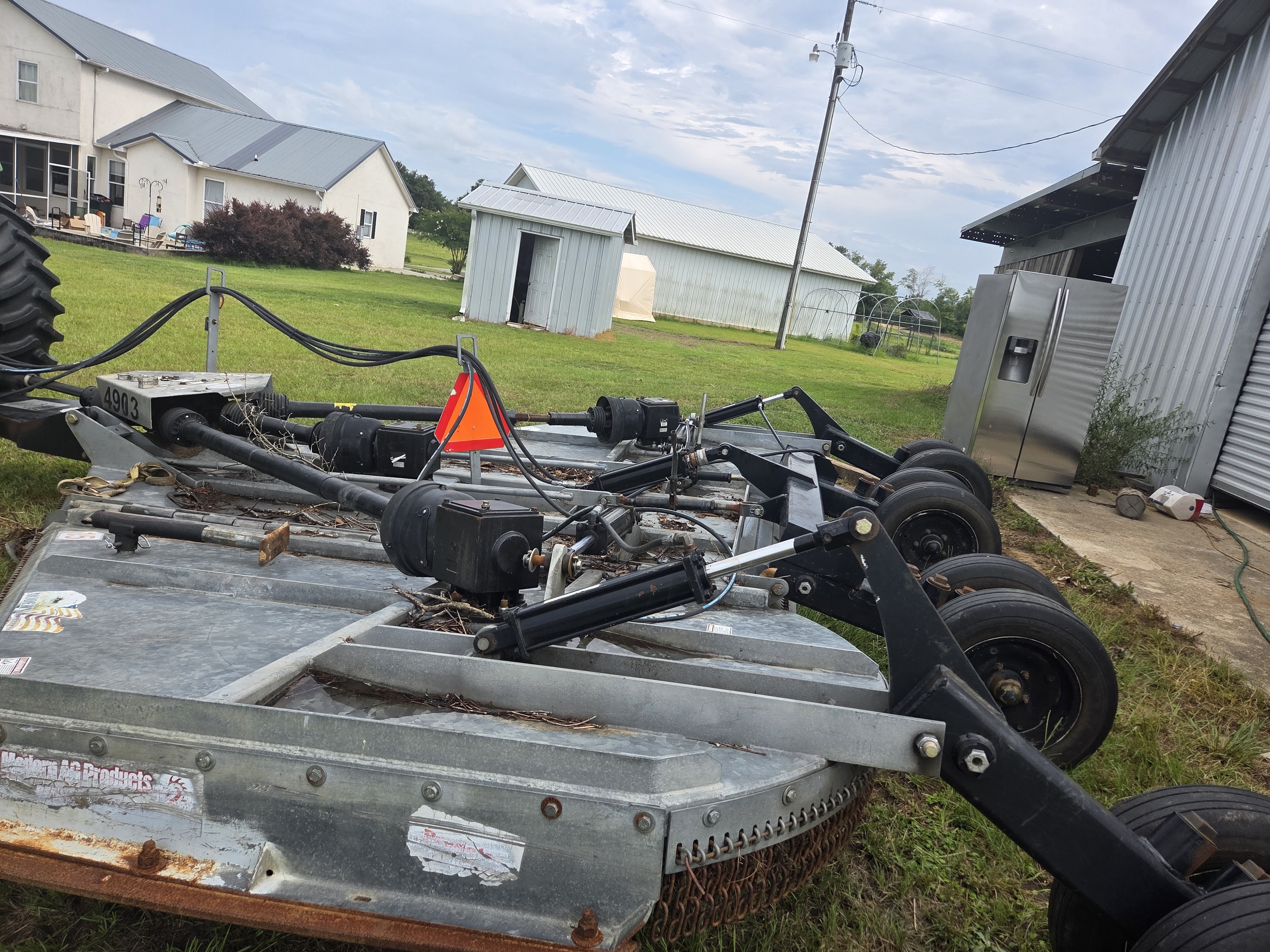

Found in the manual the rephrasing procedure. Your are correct it is extending, but doesn't seem to make a difference. I think it's definitely the issue though because I can't get wing cylinders to fully retract. It's making me wonder if there is a blocked passage or something.

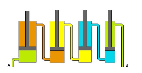

The bore diameter of the second and third cylinder should be smaller than the bore diameter of the first cylinder in the circuit of rephasing cylinders. Can you measure the cylinder diameter and see if they are all the same. If they are all the same bore OD then someone has replaced the rephasing cylinders with standard ones as rephasing cylinders get smaller as you go down the line.
I had a friend who did that with a planter and we had to plumb the cylinders in parallel to get the planter to lift. Occasionally it would lift unevenly, but there was nothing we could do since we did not have the original cylinders.
Here is a photo showing how rephasing cylinders work. If they cylinders are the same size then the ones down the line will not extend / retract all the way as the butt end of the cylinder has less displacement than the rod end.

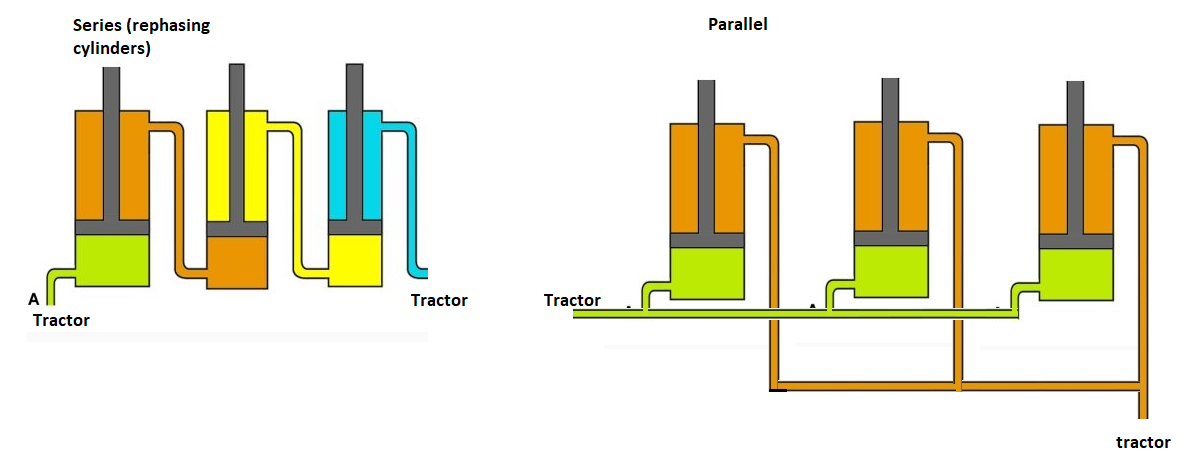

It can be made to lift lower by connecting all of wheel lift cylinders in parallel. I.e. connect all three blind ends together and to one of the lines going to the tractor. Connect all three rod ends together and to other line going to the tractor. Now they will all extend and retract but possibly at same speed and distance.
Again same as sportsman stated.
/ Leveling Modern Ag Batwing #37
Here is the two ways to hook up the cylinders. I think @oldnslo identified the OEM setup as rephasing. However if the cylinders have been replaced I would try plumbing them in parallel. The issue is that they might not lift/lower evenly as I had mentioned about my experience with a planter.
Below is a diagram I made. Please excuse my poor graphic skills.
The last resort option is to replace the wing cylinders with ratchet jacks and not be able to adjust wing height.
I think your graphics are good! I think I'm going to plumb them in parallel before I try ratchet jacks. We'll see.
