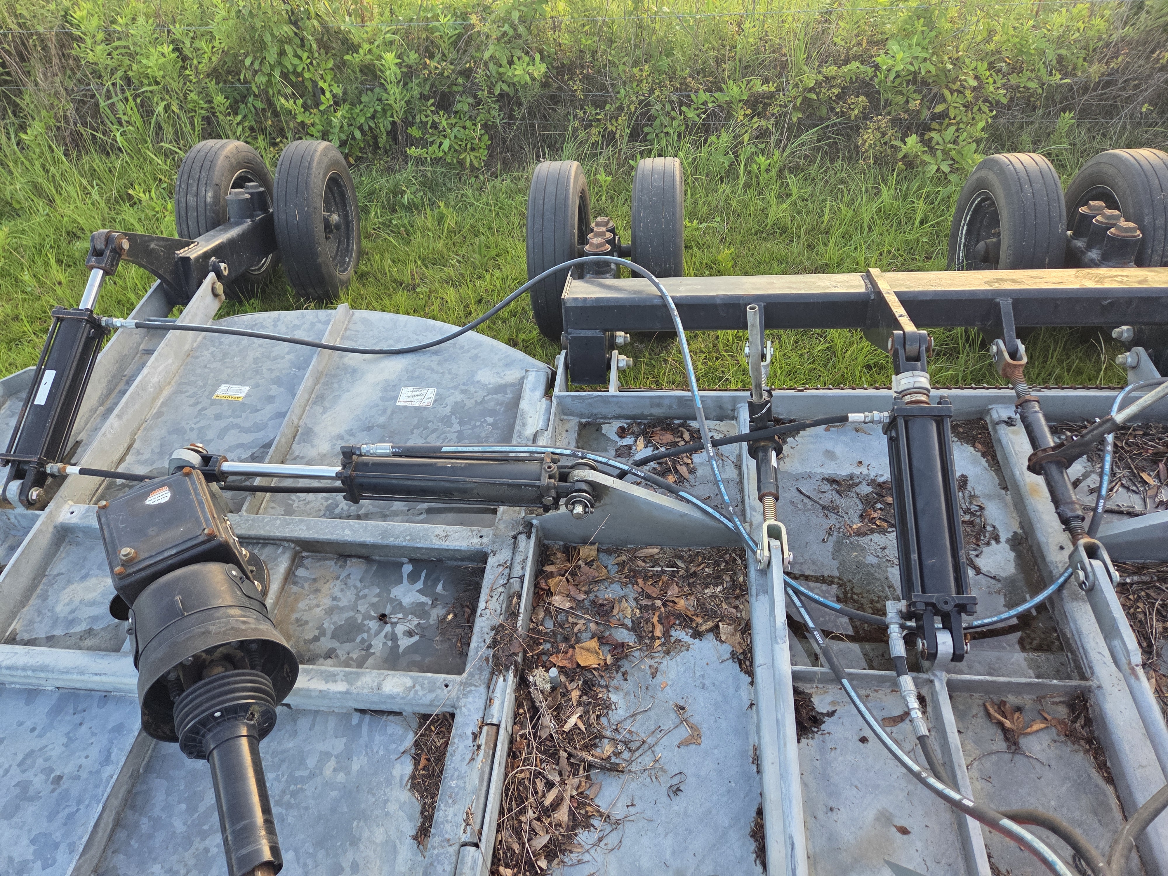

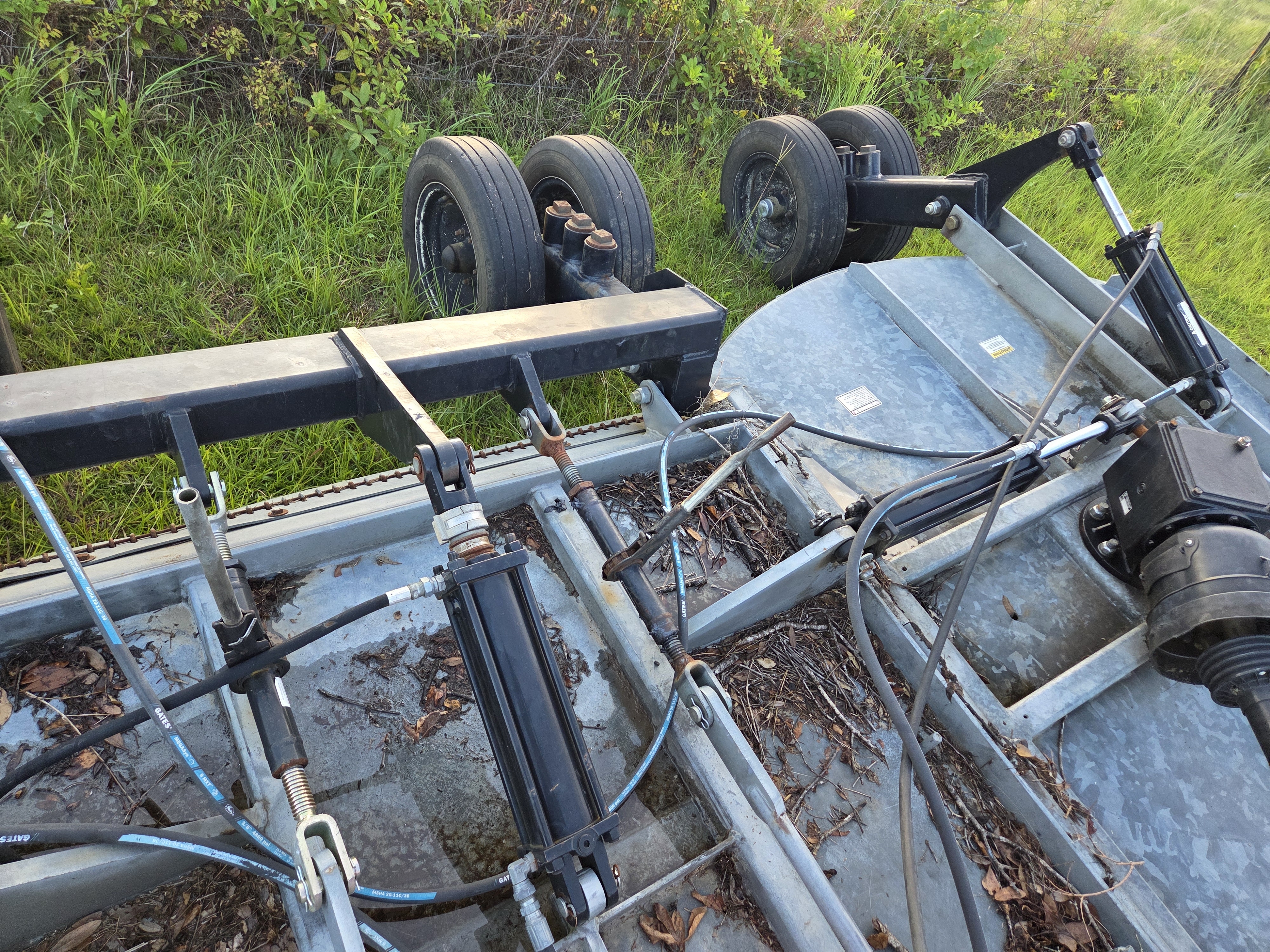

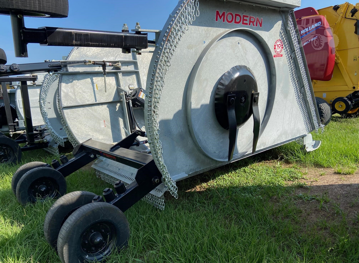

Not sure how much you can see from the pictures. The cylinders to list the wings are as simple as can be. One line from the tractor to lift each wing (retract the cylinder). No return, gravity down (extend the cylinder). Each on their own remote.
The lift/phasing cylinders are a bit more complicated. They make a loop around the the cylinders. I'm the from the tractor to the center cylinder, out the center cylinder to the right cylinder, out the right cylinder to left cylinder, and out of left cylinder back to the tractor on the other side of the same remote.
Matt,
Pictures and your hose routing provides the required detail on how this lift system is designed to work based on the assumption plumbing and cylinders are as left the factory.
To raise mower:
Oil from tractor feeds blind end of center lift cylinder. As this cylinder extends the rod end oil is forced into the blind end of the right wing cylinder causing it to extend and lift. Oil from rod end of right wing cylinder is fed into blind end of the left wing cylinder causing it to extend and lift. Rod end of left cylinder goes back to tractor. Theory of this system is that all of the lift cylinder raise and lower the same amount keeping the deck level.
Problem with this type of master slave cylinder system is they can get out of phase for multiple reasons so the cylinders do not extend and retract fully. Typically there is a "rephasing" feature that allows you to get all of the cylinders fully extend or fully retracted. I do not know how the "rephase" is on this mower works but would suggest try raising and just hold the lever in raise to see if all the lift cylinders slowly fully extend.
If extending doesn't work try retracting or lowering and keep lever or valve in power down (lower) position to see if all the cylinders fully retract.
If neither raise nor lower rephase then you may have to contact dealer or factory to find out how to rephase those cylinders.
At present I suspect main lift hardly moves since both wing cylinders are partially extended.
Note: If any cylinders have been changed to different size from stock the system will not work properly. Reason being is that rod end volume of center lift must match blind end volume of right wing left. Right wing lift rod end volume must match left wing blind end volume.
Hope this makes sense and is a simple procedure to rephase the cylinders and get you back to cutting.

Makes a ton of sense. I've been looking up rephrasing, and I have a few things to try. Thanks for the help, I'll let you know how it goes.

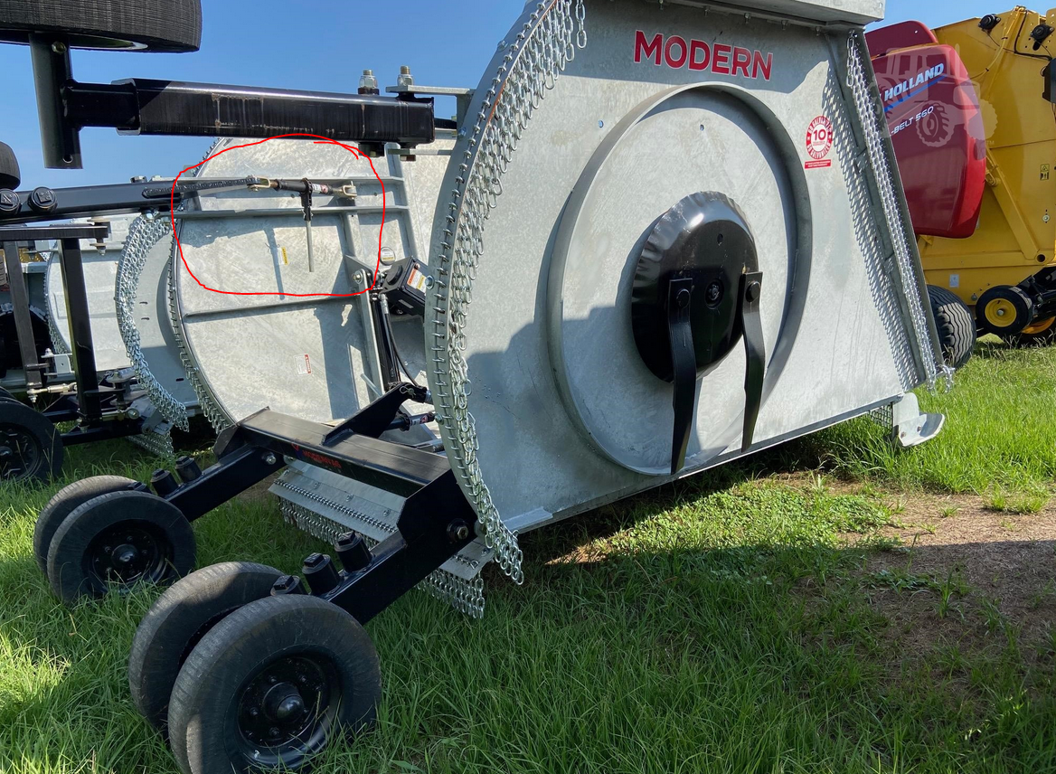

Good morning Mr. Maxwell,
If you look closely at picture 836 you can see where the right ratchet jack
is causing the rear wheel carrier to bind on the right side.
I neglected to mention this last evening and I apologize for not doing so.
The tie rod type of hydraulic cylinders on your mower allowed the designer/fabricator
to use a less expensive hydraulic cylinder for their intended use making for a more
cost effective design of mower.
The cylinder rod eye has internal female threads allowing for a greater flexibility
in the range of linear movement/extension to allow the cylinder and cylinder rod
eye to operate. The adjustable rod eye is held in place with a set screw that is
tightened against a nylon ball that is squeezed into the rod threads if my memory
of the design is correct to hold the rod in place

Good evening Mr. Maxwell,
The new ratchet jack is set at 11 threads the original ratchet jack is set at 7 threads.
You are correct. I will make the exactly even before if do any mowing. I think I've pinpointed the bigger issue to phasing the lift cylinders.

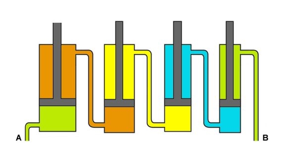

The bore diameter of the second and third cylinder should be smaller than the bore diameter of the first cylinder in the circuit of rephasing cylinders. Can you measure the cylinder diameter and see if they are all the same. If they are all the same bore OD then someone has replaced the rephasing cylinders with standard ones as rephasing cylinders get smaller as you go down the line.
I had a friend who did that with a planter and we had to plumb the cylinders in parallel to get the planter to lift. Occasionally it would lift unevenly, but there was nothing we could do since we did not have the original cylinders.
Here is a photo showing how rephasing cylinders work. If they cylinders are the same size then the ones down the line will not extend / retract all the way as the butt end of the cylinder has less displacement than the rod end.

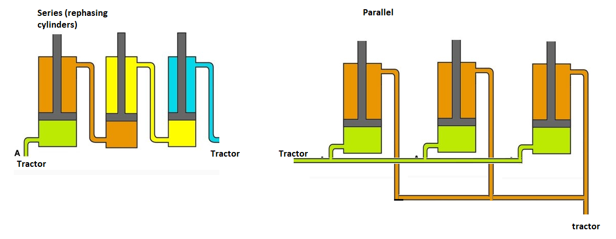

Here is the two ways to hook up the cylinders. I think @oldnslo identified the OEM setup as rephasing. However if the cylinders have been replaced I would try plumbing them in parallel. The issue is that they might not lift/lower evenly as I had mentioned about my experience with a planter.
Below is a diagram I made. Please excuse my poor graphic skills.
The last resort option is to replace the wing cylinders with ratchet jacks and not be able to adjust wing height.
The wing cylinders are smaller diameter than the center cylinder, but appear to be the same size. The first two cylinders in series (center and right wing) seem to phased correctly now, just the last cylinder (left wing) is still off.
I think your graphics are good! I think I'm going to plumb them in parallel before I try ratchet jacks. We'll see.
