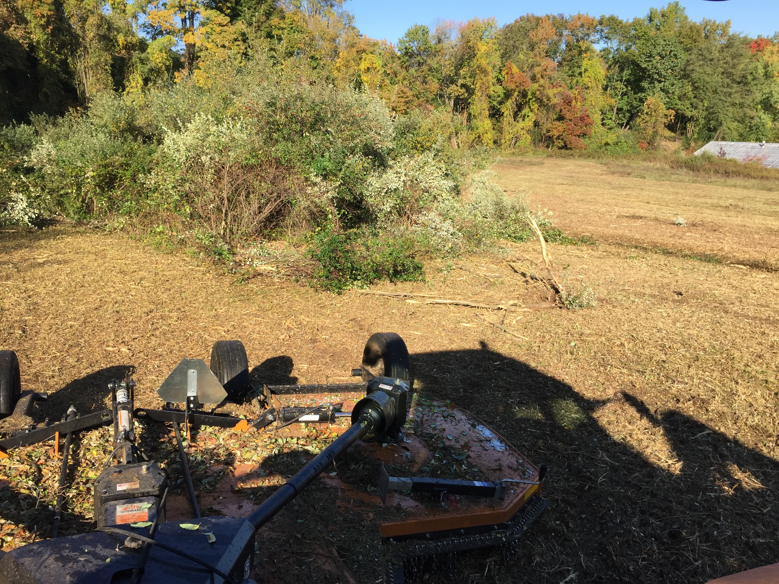

I have a 2810 bush hog. It has no problem cutting grass and saplings eye level with me in the cab of my m5-111.
Yeah, Woods makes a single wing HD cutter as well.
For what I do, I really need 2 wings, with a total cut of 12'
