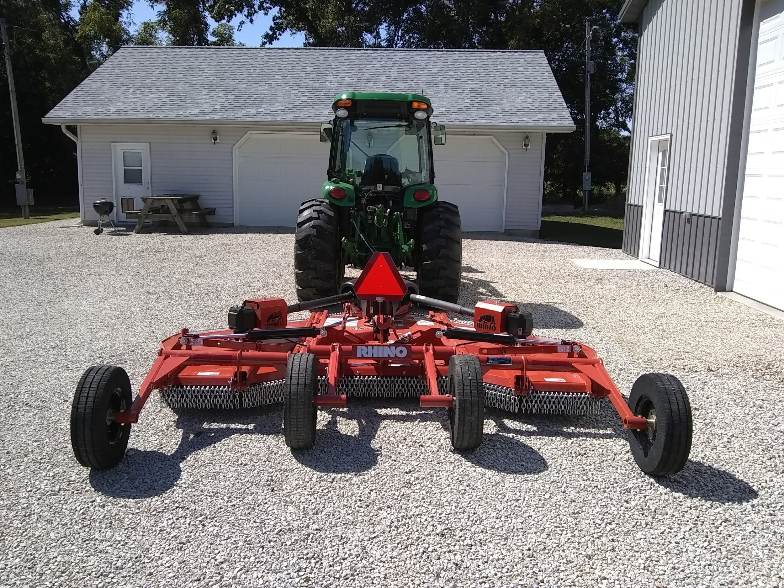

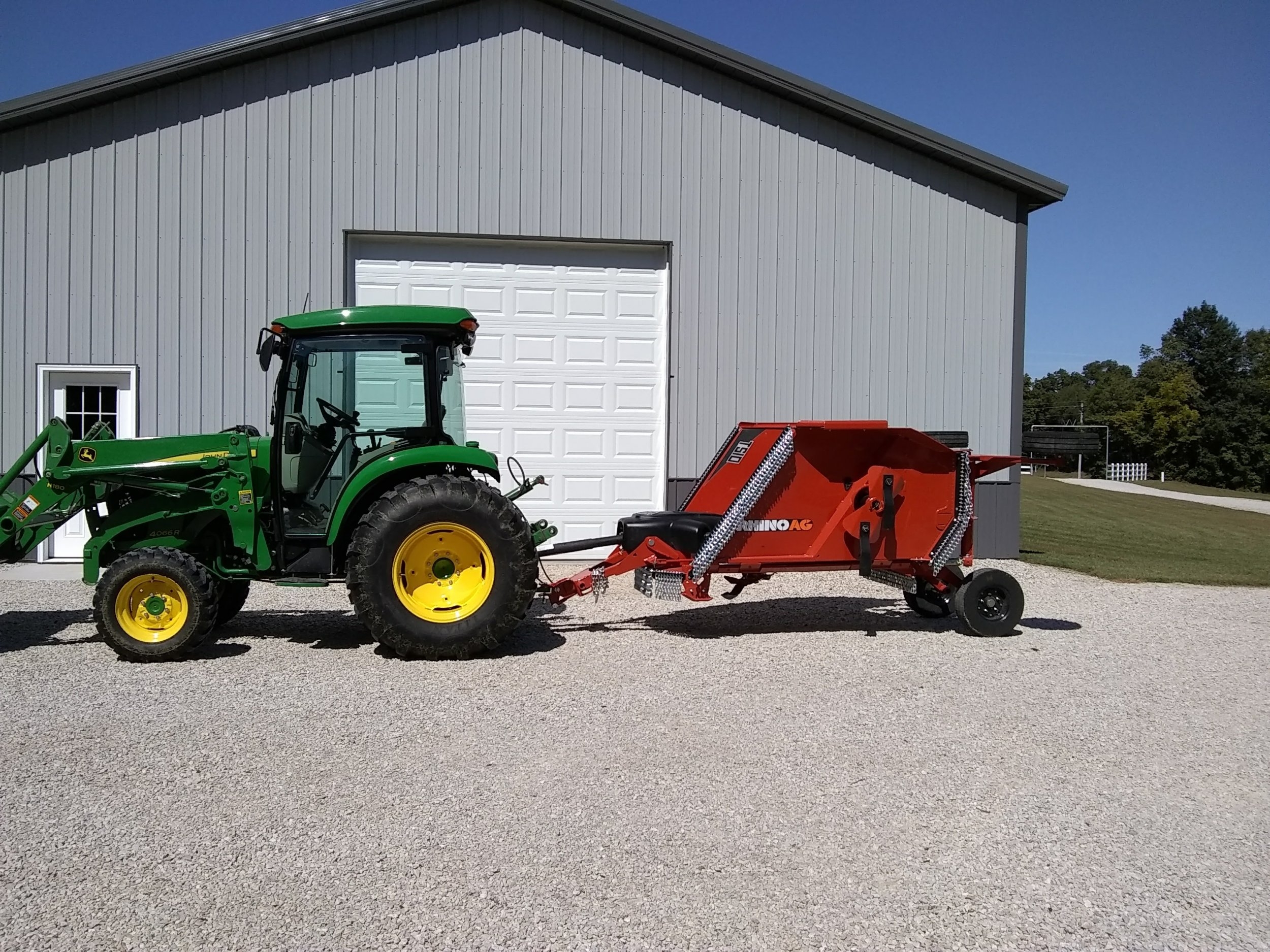

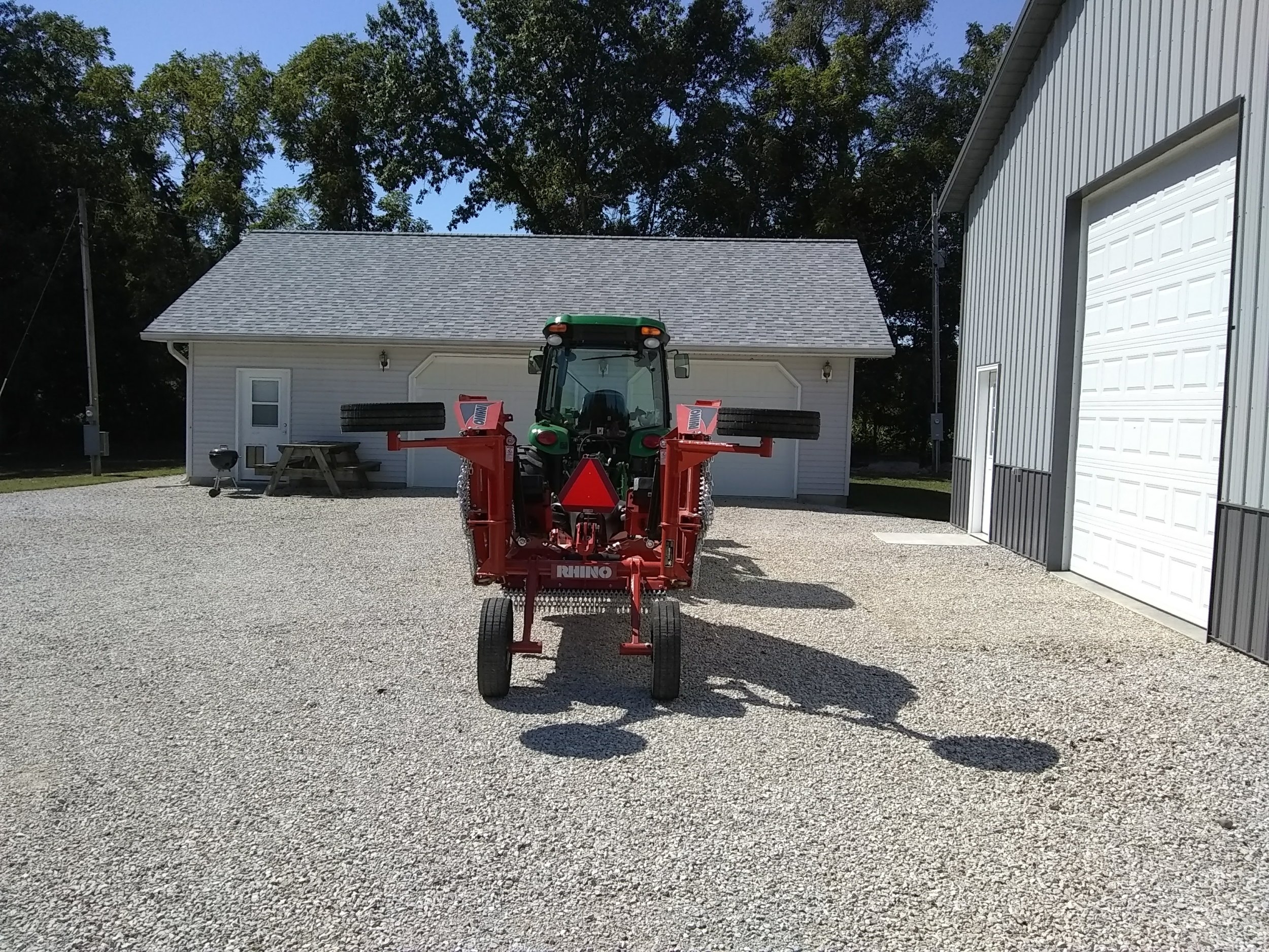

Works for me

My only complaint would be that the wings throw the cut material to the inside, which makes a window. It is my understanding that our government requires this so if you are mowing alongside the road, it won't throw material out towards the road. I tried to pull the bowtie (stump jumpers) off to switch the gear boxes on the wings. Could not get them off without heat from a rosebud. I did not want to mess up the seals so I stopped. If your dealer can do this great. My dealer ran an extra hose so I can lift the wings separately from the main body. Thanks John

My rhino TS10 actually starts up easy compared to my land pride 2572 cutter. Keep in mind that the tongue weight is 720 pounds and mower weight of 2200 pounds. So mowing on steep hills or uneven terrain could be difficult. My 4066R had 52 PTO horsepower and it would mow hood high material with no problem.
