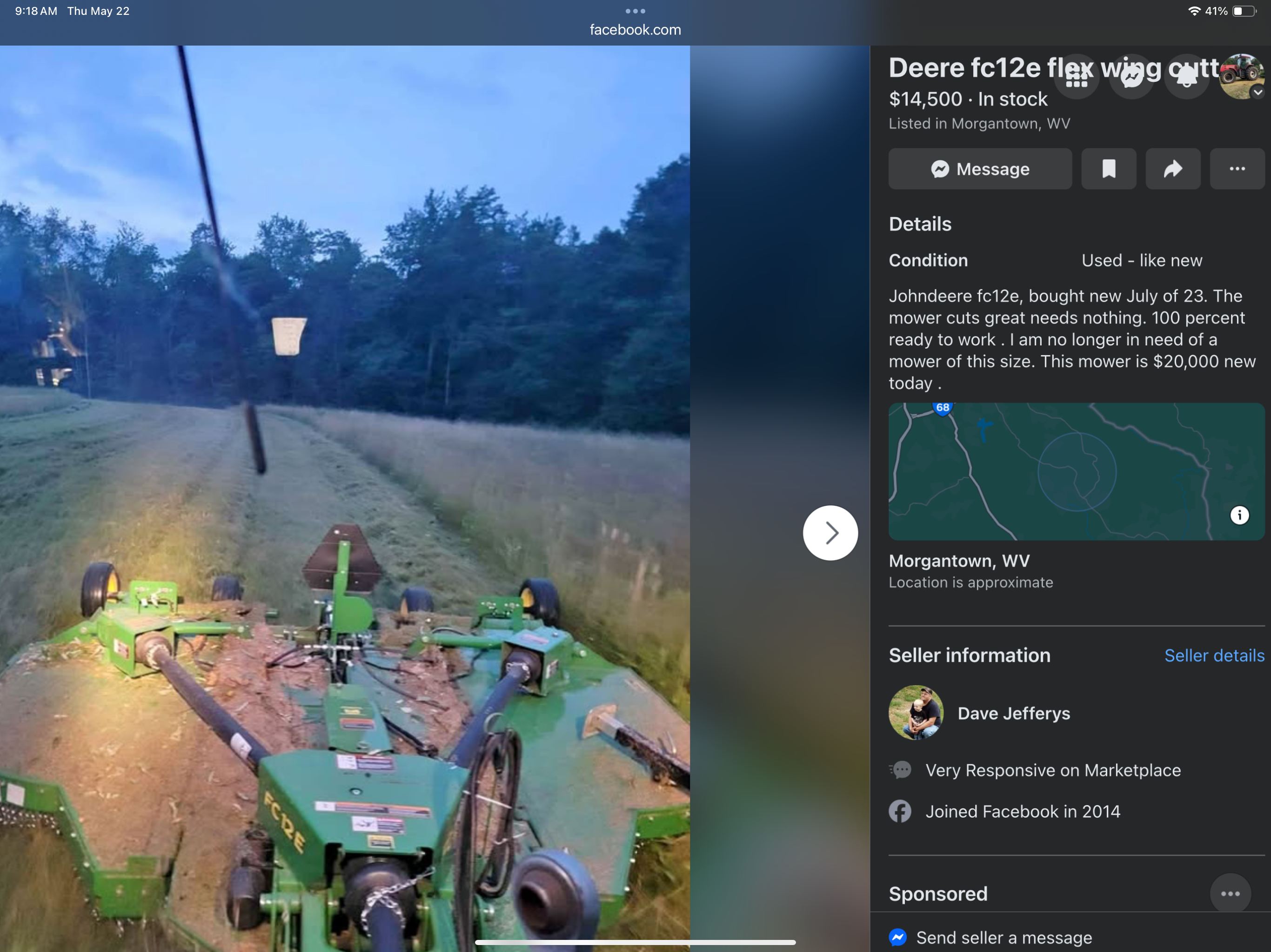

This is a great 12’ mower. I’ve had 3 different types of commercial Deere mowers and they have gone far above and beyond what I would expect. My CX-15 and a former MX-8 and a 390 offset flail.
And no, I am NOT a paid spokesman for Deere 😁

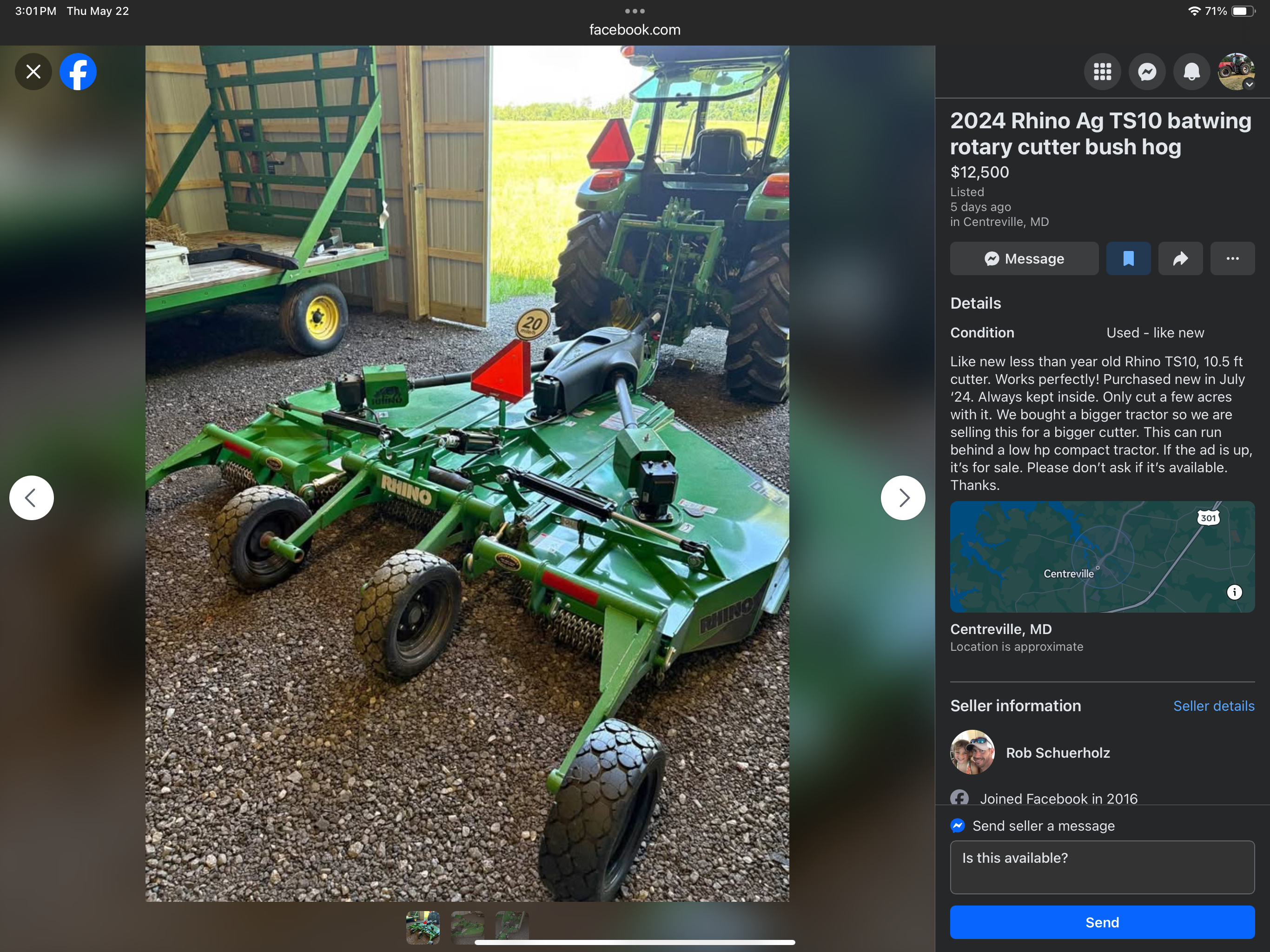

I thought this one looked pretty nice, too.

They probably are real good cutters for lighter duty projects.
Looked at the JD awhile back, but it's light duty as well.
May end up taking anther look at the Bush Hog 12' because it has the drive lines and gear boxes to rate cutting 3" growth.
Interesting that my 12' Viper and the Bush Hog are the same frame and design. I think the difference is that the Viper has cheap Chinese gear boxes and hydraulic cylinders. Probably would have been better off with the Bush Hog than the Viper, but when I got the Viper, Bush Hog had suspended production on theirs.

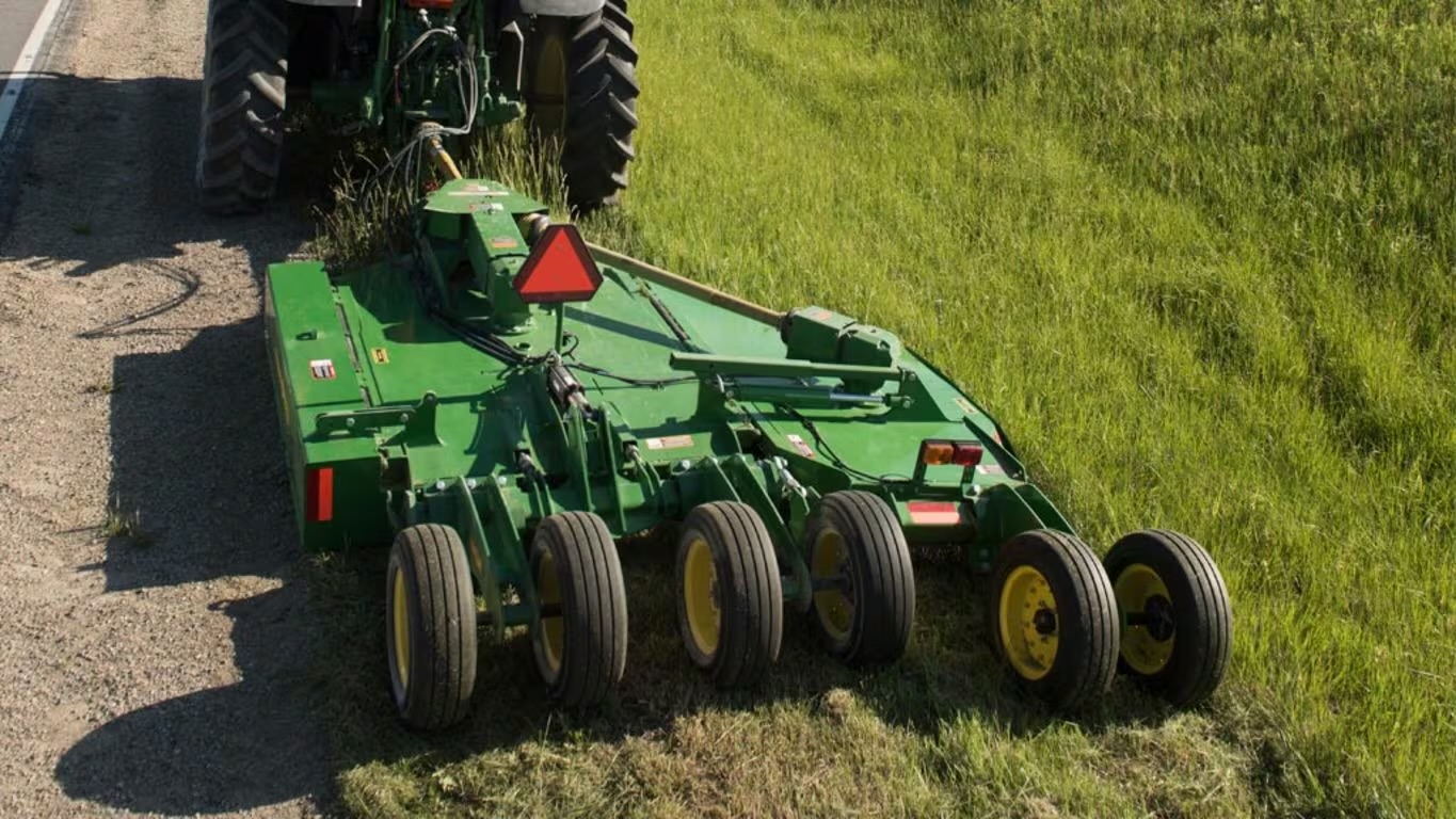

According to Deere’s website, the “FC” cutters are good to 2” material. I can tell you first hand, their cutters are very conservatively rated. If they say it’ll handle 2”, it’s probably good to 3”, although I wouldn’t advise anyone to use a machine beyond it’s rated capacity.
I think all gear boxes are “cheap Chinese”. I know my Woods gear boxes and Deere gearboxes are made in China. Last Bush Hog I looked at had Chinese gear boxes, too.
I haven’t seen an American made gearbox in decades, but that may have changed.
My CX-15 is rated to 4” with standard blades, but I rarely try to cut 4” material with it. Mostly grass and brush.
Another option is to order their heavy-duty FC-10R model with a deleted wing. It’s only 10’, but it’ll be extremely heavy built. It’ll cut up to 5” material with a high impact blade, but if you do that with your tractor, you’ll cook your PTO pretty fast.
These mowers are sick. They will cut just about anything.
You need a real heavy duty cast iron PTO box to do consistent heavy 3-5” brush cutting. Those are small trees and they put a huge shock load on your PTO.
