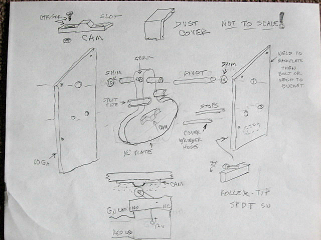

Channeling Rube Goldberg here for DIY light control setup. :D ... (Hey, it's raining .. no spray, no mow, no fertilize ..)
Cushioned pendulum stops limit travel, noise when moving or bucket not level. Please add suggestions, comments, criticisms, dope slaps, etc. (must go take my meds now..) :eek:
