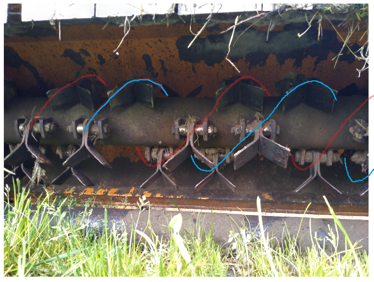

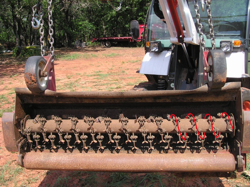

Anyhow. I have 4 rows 8 blade stations each. Not spiral arrangement obviously. --------------------
Mine is a single spiral. The hangers are evenly spaced in the row:
Yours is a double spiral arrangement. Two hangers closer in the row, in a double spiral around the drum:
