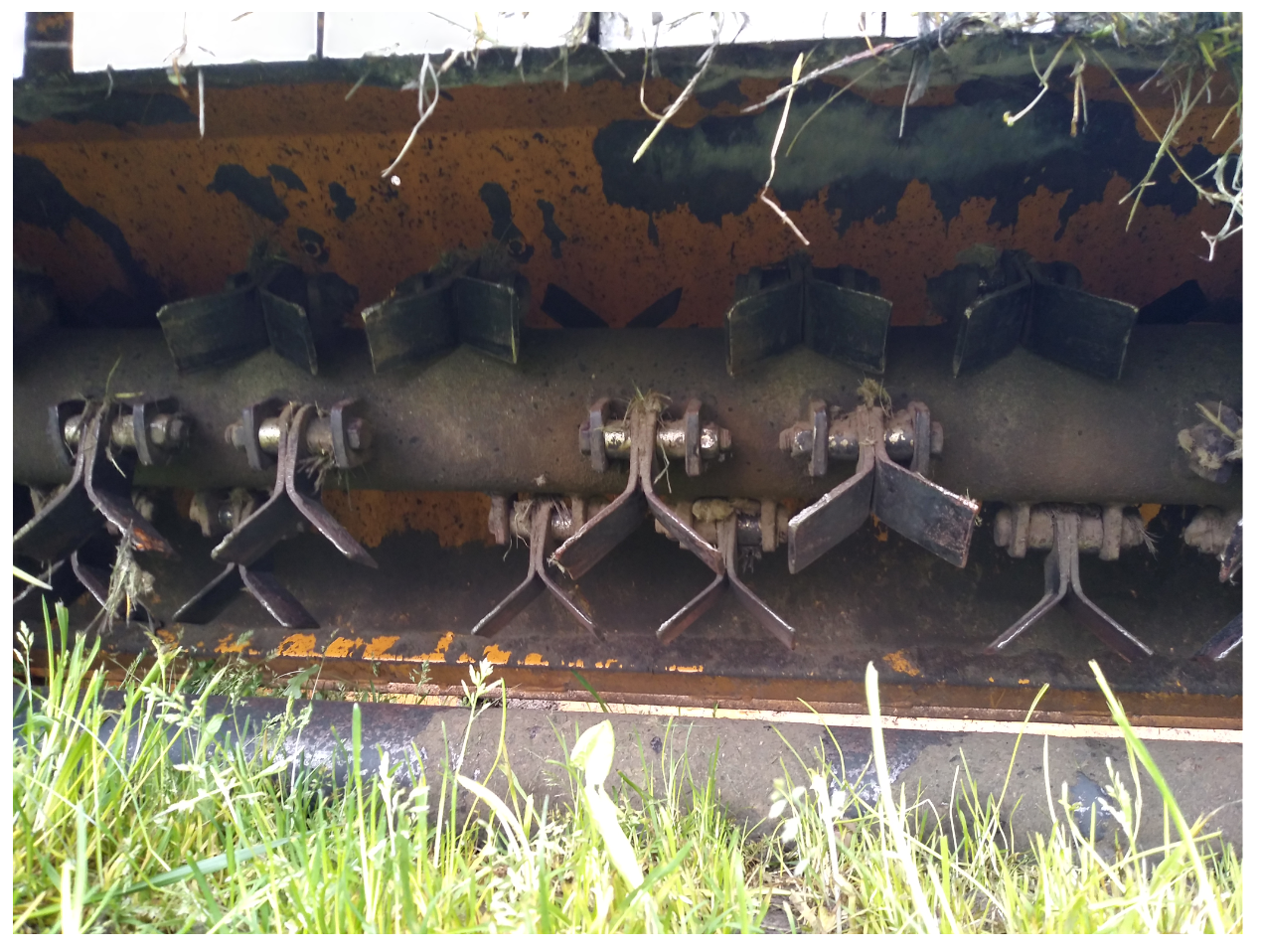

If you could upload a few picture images of the flail mower rotor that would help me and the members that have your flail mower in their stables as well.
The full width of the scoop knife is what will determine your number of knife edges per row of knife mounting stations if your flail mower rotor has mounting stations that are linear-straight across.
The scoop knife will be a lot more forgiving as far as terrain goes and will still give you a good cut but you will need to mow at right angles to get a better finish and reduce the amount of waffle cut look after you mow.
The scoop knife will be mounted in the center of the mounting station with the spacers on either side of the mounting hole in the scoop knife to hold it in place and prevent it from sliding back and forth.

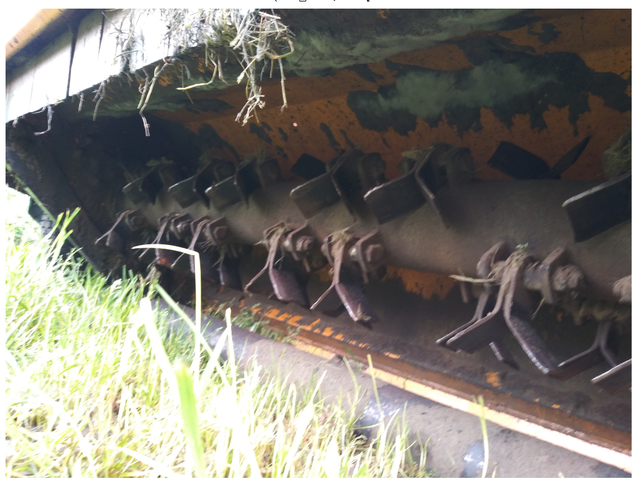

Anyhow. I have 4 rows 8 blade stations each. Not spiral arrangement obviously. Checker board.
yes, waffle effect is quite observable. Give it about 5 -6 days, and it clearly shows itself.

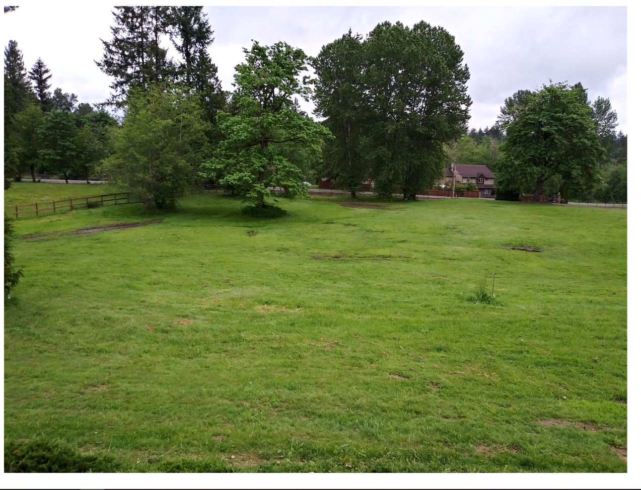

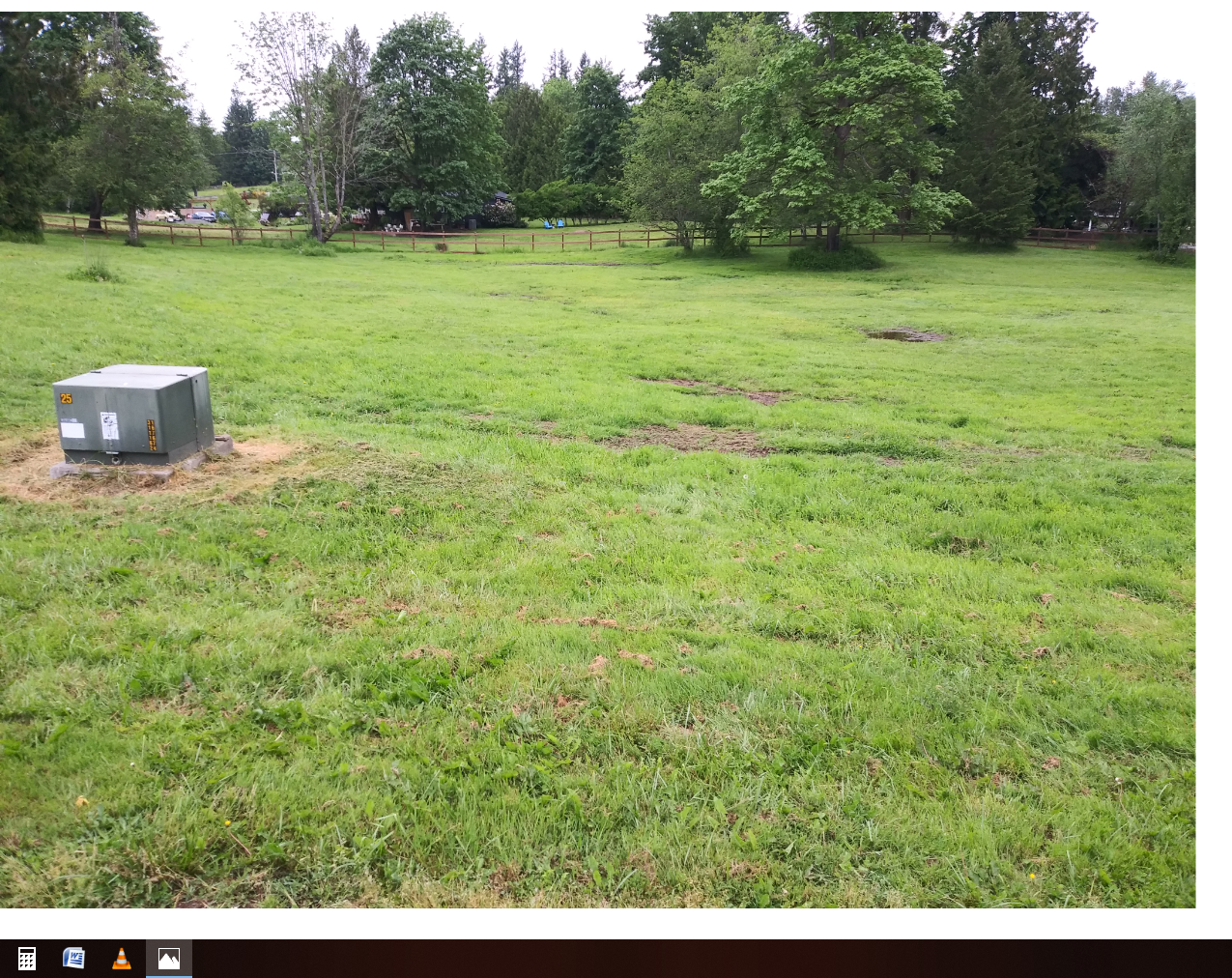

Also, pics of part of the property that is hills and valleys and wetland, for better understanding of what I mow. Needs dozer and nuking it into flat surface, except that wetland is not permitted to be changed. Plant on it, mow, sure. Nothing else.
So I am all for horizontal cut blades, just not sure which ones.

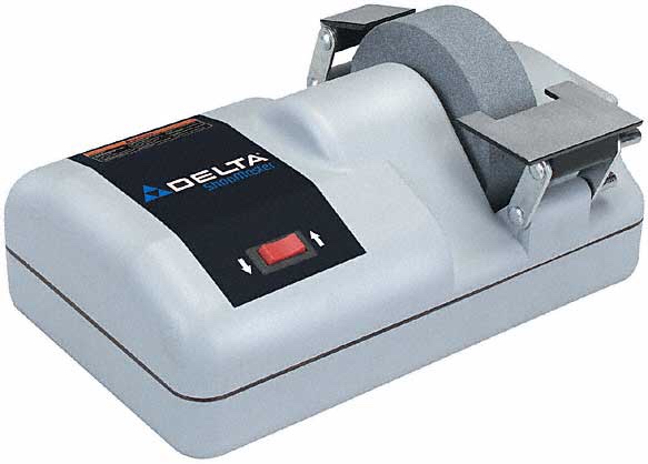

Delta also has similar in their GR050 Shopmaster Utility Wet Dry Grinder. I've had mine for about 15 years.
