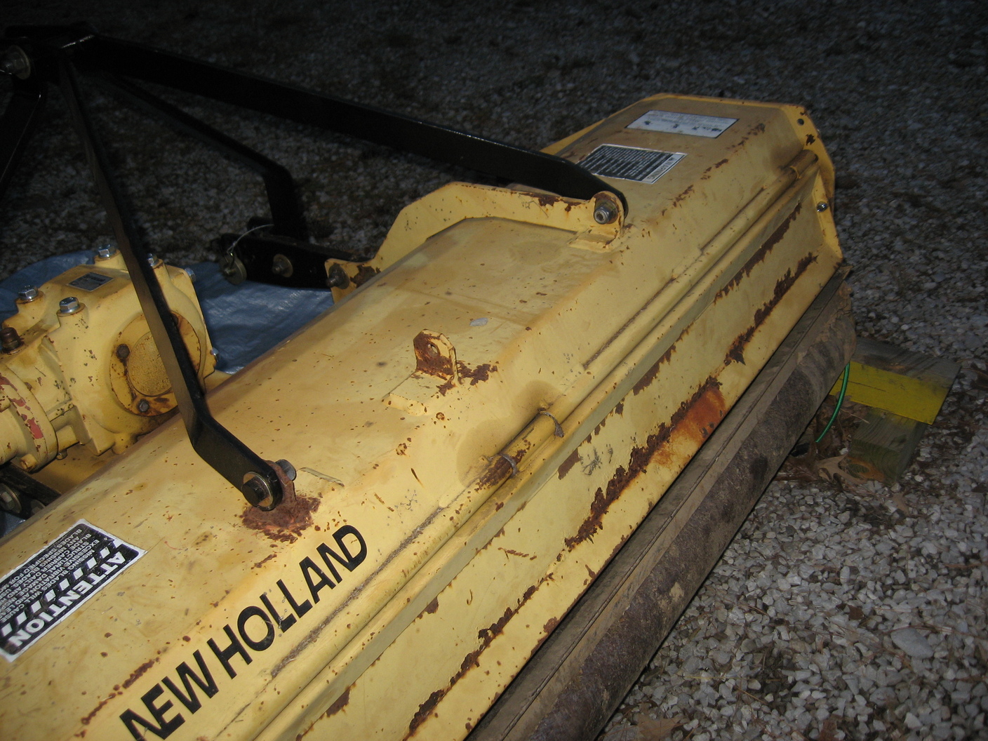

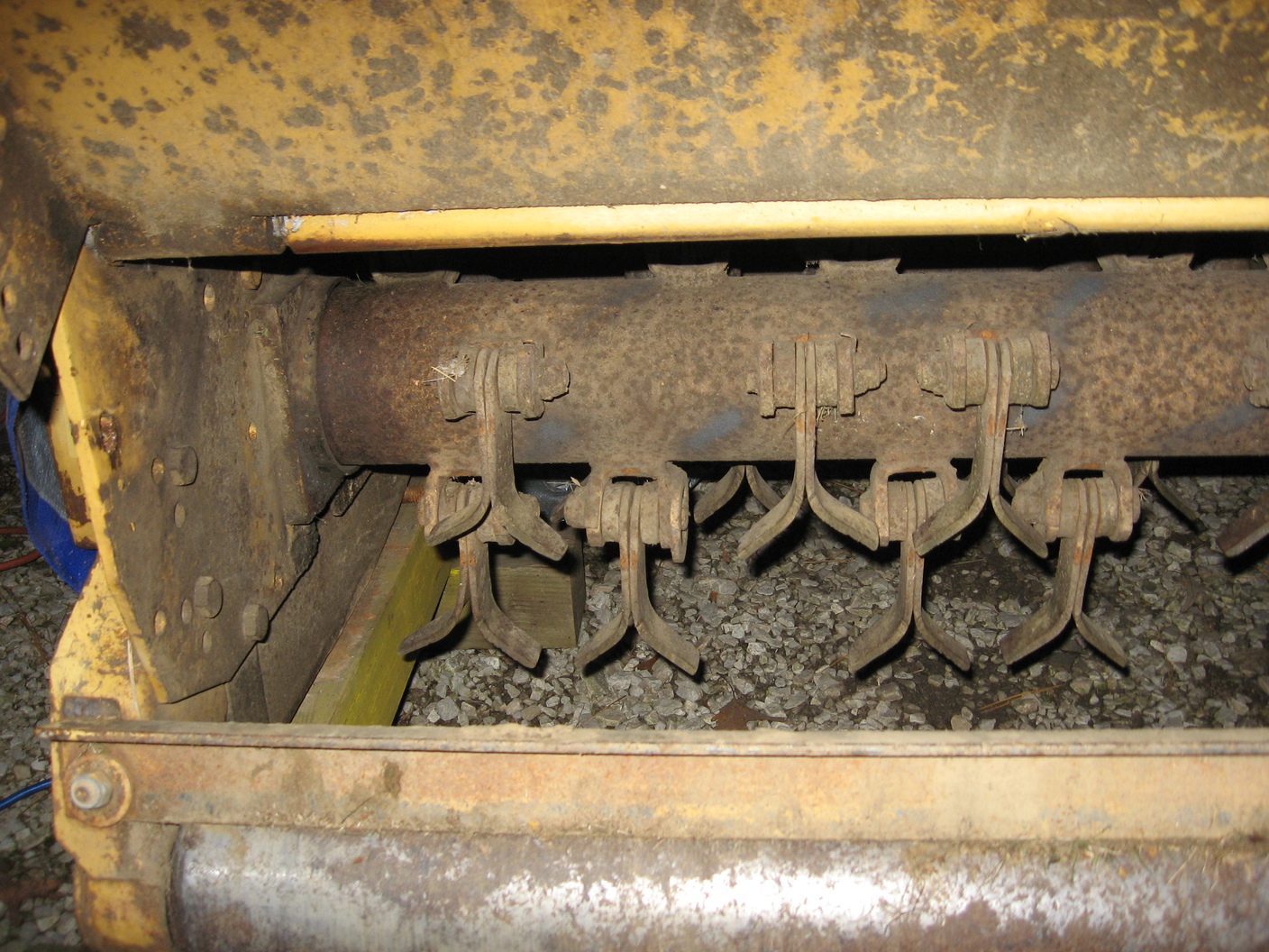

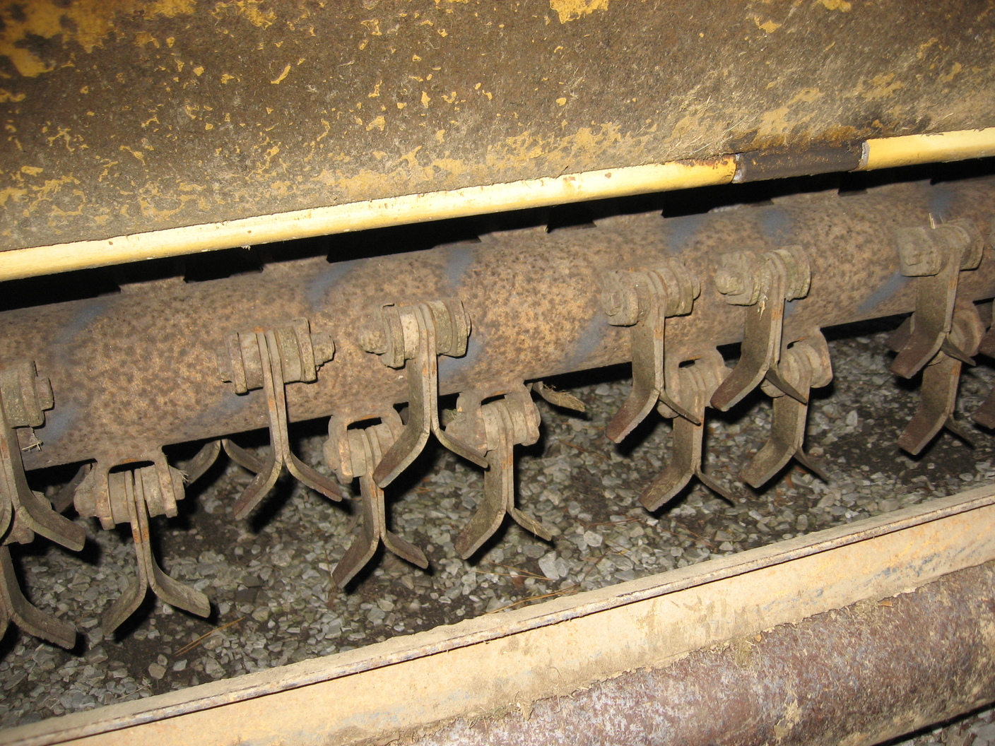

A little more info, it is a 74" cut with 48 stations, 96 blades. Here are some pics I took of it right after I got it home. Any and all help is appreciated as I would really like to get this to leave a mostly smooth cut.

Hello and good morning John0829,
The cutting edges are pretty dull john, I would flip the side slicer pairs and see how
well they look. you may just luck out and have a good set of edges on the opposite side.
Its nice to see that you have a trash election door on your flail mower as you can mow in deep thick brush and eject it quickly without clogging the flail mower.
Just be sure that there is no one within 300 feet of the flail mower when mowing with the trash door open.
If they are not damaged they will spin fine.
The last time I checked micromark was selling their wet well grinders for $99.00 Plus tax and shipping and the folks at master craft were selling
their gauge setting tool for $25.00 plus tax and shipping and you will have a perfect edge every time as the wet well grinder spins at a very low
rpm and the temper on the steel will not be ruined.
My father used a table belt sander in his wood shop to sharpen his side slicers(not crazy about that but it worked).
Be sure to have the swear jar handy :^0
It will be worth your while to invest in fine thread allen head bolts and use blue Loctite to secure the fine threaded nuts to replace them as needed.
Using a long handled Allen wrench will give you more leverage to loosen them if and when you need to change side slicer pairs.
I would suggest that you
1. wear good thick leather gloves
2. invest in a new pair of high quality 12 point box end wrenches as you will have an easier time in removing the nuts and bolts.
3. a big bottle of blue Loctite(don't let it freeze)

I will flip the slicers pairs first chance I get, raining here for the next several days according the the forecasters and the shop is to full to get it inside, then will report back on how it does. I did take a side grinder and touch up the slicers though the rear door after I got it home thinking it would help. If this improves the cut I will purchase a new set to have on hand for next time it needs it.
I will check into a wet grinder, its about the only tool I do not have, I tend to do all blade sharpening on the belt sander since I discovered YEARS ago how nice an edge it put on them.
