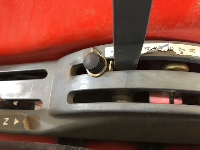

So lets get back to the way these things are adjusted to mow. I have the Caroni also so I have a hole or a slot to hook the top link to. I've tried both and not sure how much difference it makes.. AND apparently having the skids at the same height/level as the roller is not correct either and I have the grooves all over the place to prove it.
So how bout a tutorial/discussion on how AND why everyone adjusts and hooks up their flail..
thanks...
Below I describe my way to set the height of my Caroni flail mower. I do not pretend that is the only way or the right way, but it works for me:
Assuming the skids and the bottom of the roller of the mower are on the same plane.
Firstly, I ensure that the tractor and the flail mower are on a level and hard ground. After attaching the Flail mower to the tractor, I set the top link length so the pin will center into the slot of the mower hitch frame (so the mower can tilt back and forth slightly when going over bumps).
Then I raise the mower to top position and slowly lower it down with the control lever until the skids barely touch the ground. Next I move the stop against the control lever and tighten it.
This will be the lowest position the mower could go, and it will (most of the time) prevent the skids to dig their way in the ground and making grooves in soft terrain.
See attached picture of control lever and the stop.
So... that sound almost EXACTLY the way I do mine, but I end up with grooves from the skids all over the place! Trying to figure out how to avoid that. Now granted, my place is almost like beach sand so it is very soft so maybe I'm just stuck with the grooves!:confused3:
