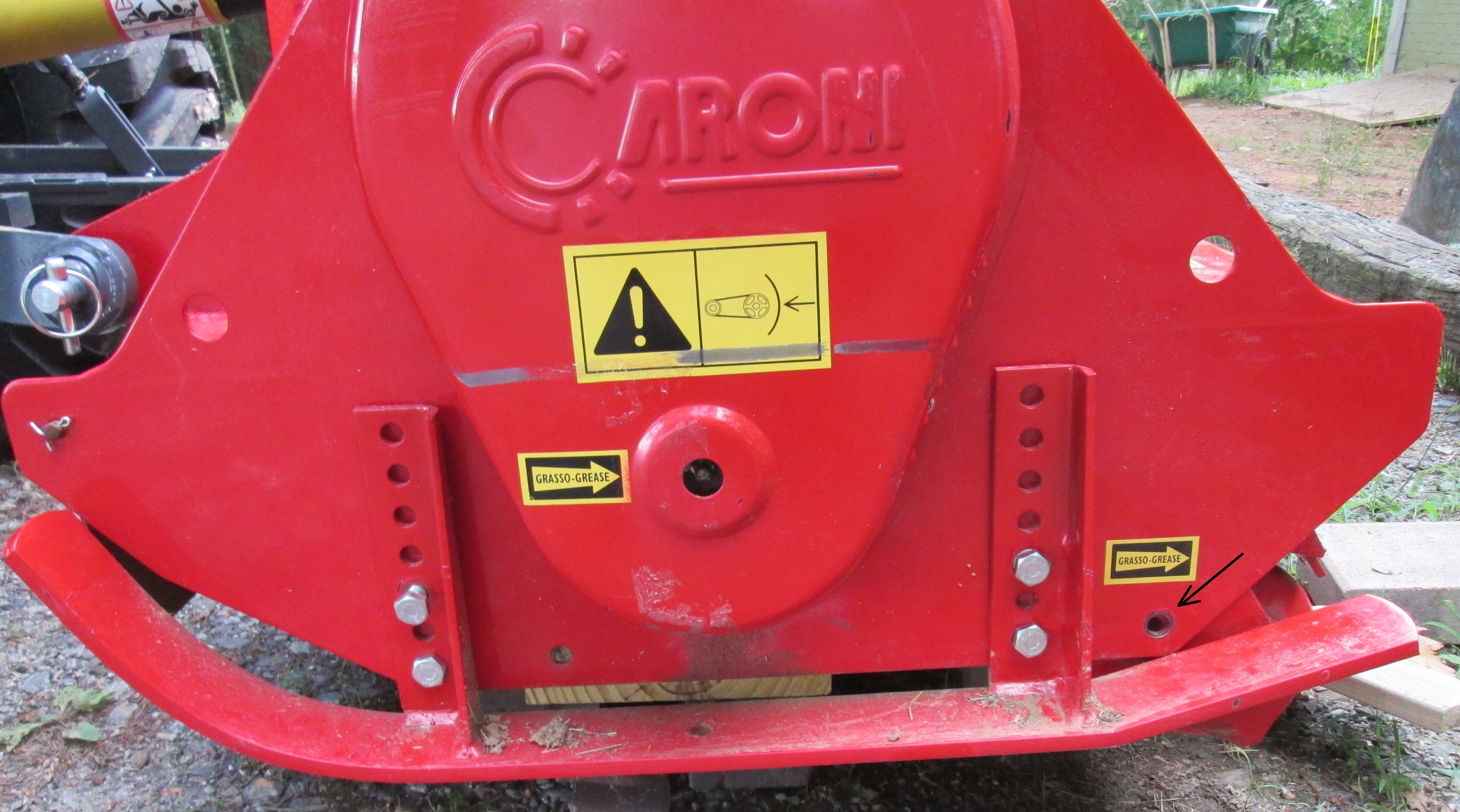

My current issue is setting the cutting height. What I've read here is to generally have the skids up high and put the roller where you want for cutting height. But the Caroni manual says to keep the skids and roller at the same height, and I can't see how to adjust the roller separate from the skids. There are two bolts on each side of the bracket for the guides and another bolt for the roller. If you remove one fo the two bolts to pivot the bracket down, then it doesn't look like you can get that bold back in. Can someone weigh in on this, please?

The skids on the flail mower protect the flail mower rotor by preventing it from nose diving into the ground and damaging the knives and knife hangers.
The skids must be level when mounting them in a lower position
Lower the skids 2 bolt holes and then lower the rear roller- the new drawings for the flail mowers are not the greatest and I will check with Ms. Caroni about this too.
Apparently they have changed the old design for the rear roller mounting to attach it to the skids making the skids a sacrificial wear part also making it a ground engaging wear part of the flail mower.
Bear with me I will be back in a couple of minutes.
I am back,
The ends of the rear rollers ride on the tail portion of the skid when mowing so they have changed the design of the skids making them skis being wider and a bit longer with upturned ends to protect the mower more.
Lower the skids two holes and then position the rear roller lower as you should have plenty of room to work after lowering the skids where you can bolt the rear roller back to the side weldments.
More than pissed off I cannot watch the hockey game, I have to listen to it on the internet!!!!!!!!!!!!!!!!!!!
The design for the rear roller mounting has changed and the rear roller is "not" part of the skid and also bolted to the side weldment's of the flail mower.

I believe I have figured out how to adjust cutting height on the Caroni TL1500, and hopefully this will benefit future users. My original thought (indicated in my previous post) was that I couldn’t adjust the roller separate from the skids. But it is possible. On the side of the mower are the skids, each attached via 4 bolts, as shown (I had already removed the bolt for the roller from the hole with the arrow).

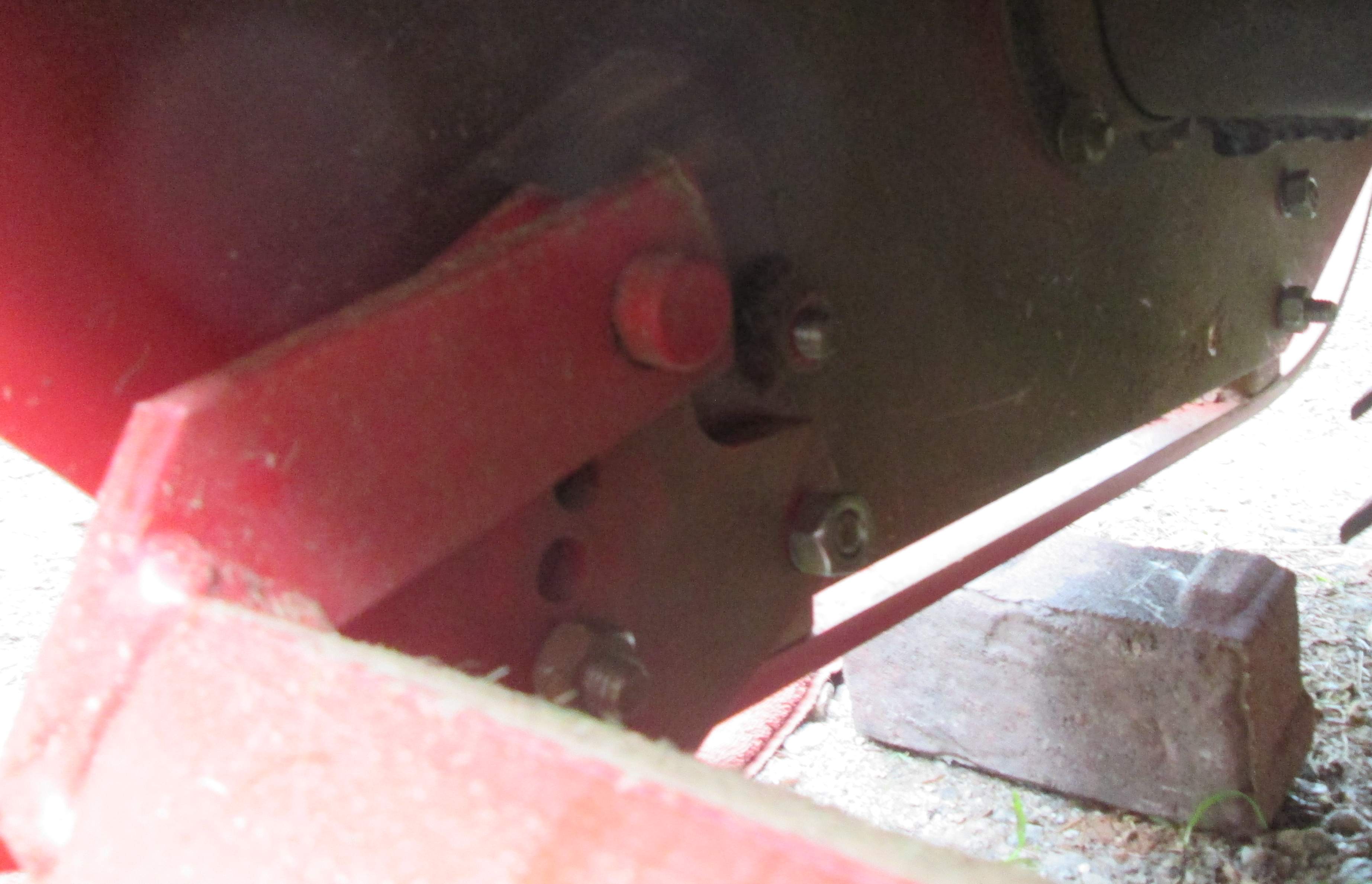

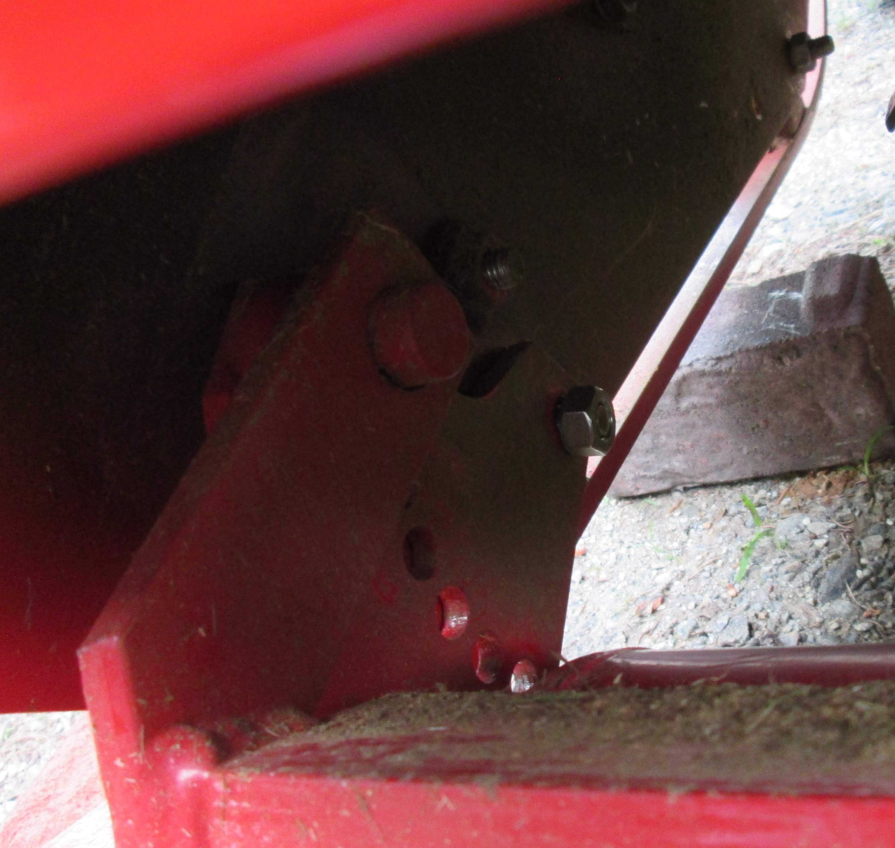

Each support for the skid has 7 holes, where the two bolts are 2 holes apart. So there are 5 possible positions for the skid (#1 & #3, #2 & #4, etc.), and the mower comes with the skids attached at the highest point (bolts in the lowest holes). The bracket holding the roller uses the bottom skid bolt (roller side) as the pivot point on the roller bracket, which has a series of 5 holes in an arc to set the cutting height.
You can see the four bolts for the skid. So if you want to leave the skids in the highest position (as recommended by a number of people in this forum), then all you have to do is to loosen, but not remove, the pivot point bolt on the skid support. Then remove the roller bolt and reposition it to a higher hole. I put mine in the middle hole, which puts the roller about 3” below the skid.
