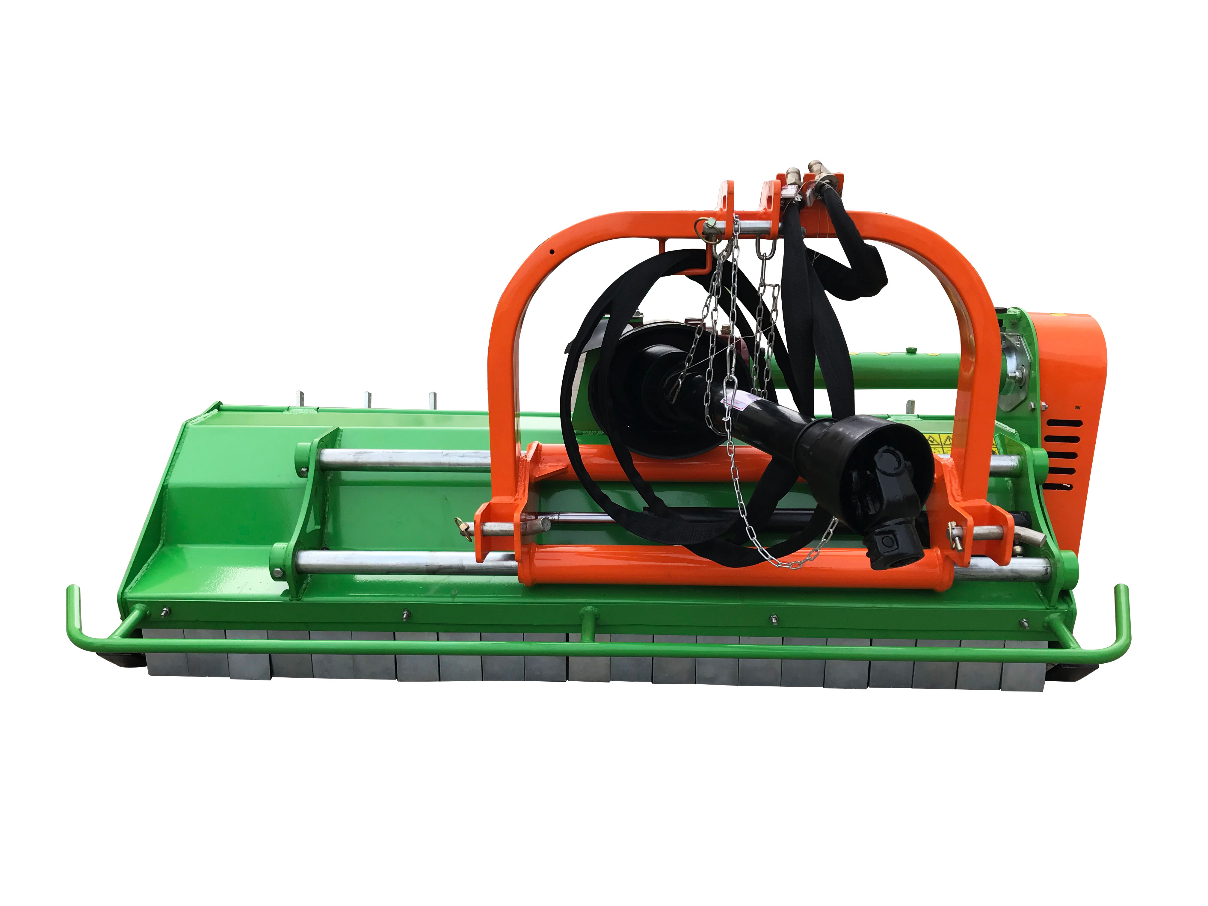

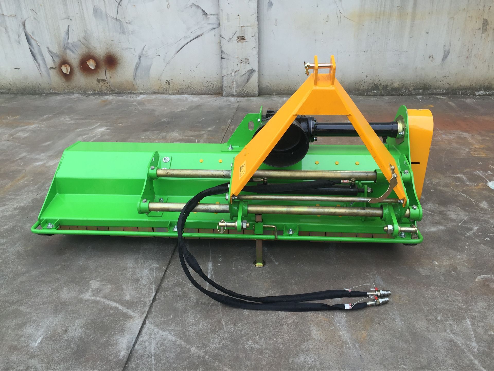

Both two side shift rails should be lubricated. Because although the shift rails have to be gavalized or chromed when manufactured, its surface will be worn out soon during working, then the shift rails surface will start oxidation(like rust), then this will wear the nylon of the shift rails faster.
The old style side shift flail mower doesn't need to lubricate the rails, they were like this: QQ图片20161223145956.jpg
After I got some feedback about nylon defect, so since two years ago, I produced my offset flail mower to be with the rails which need lubrication. It is easy, use the two tubes on the rails and drill holes for grease, just increase some production cost.IMG_3023.JPGIMG_3231_20180520110735.JPG
As the result, I got few nylon worn out feedback on the new model mowers in last two years.

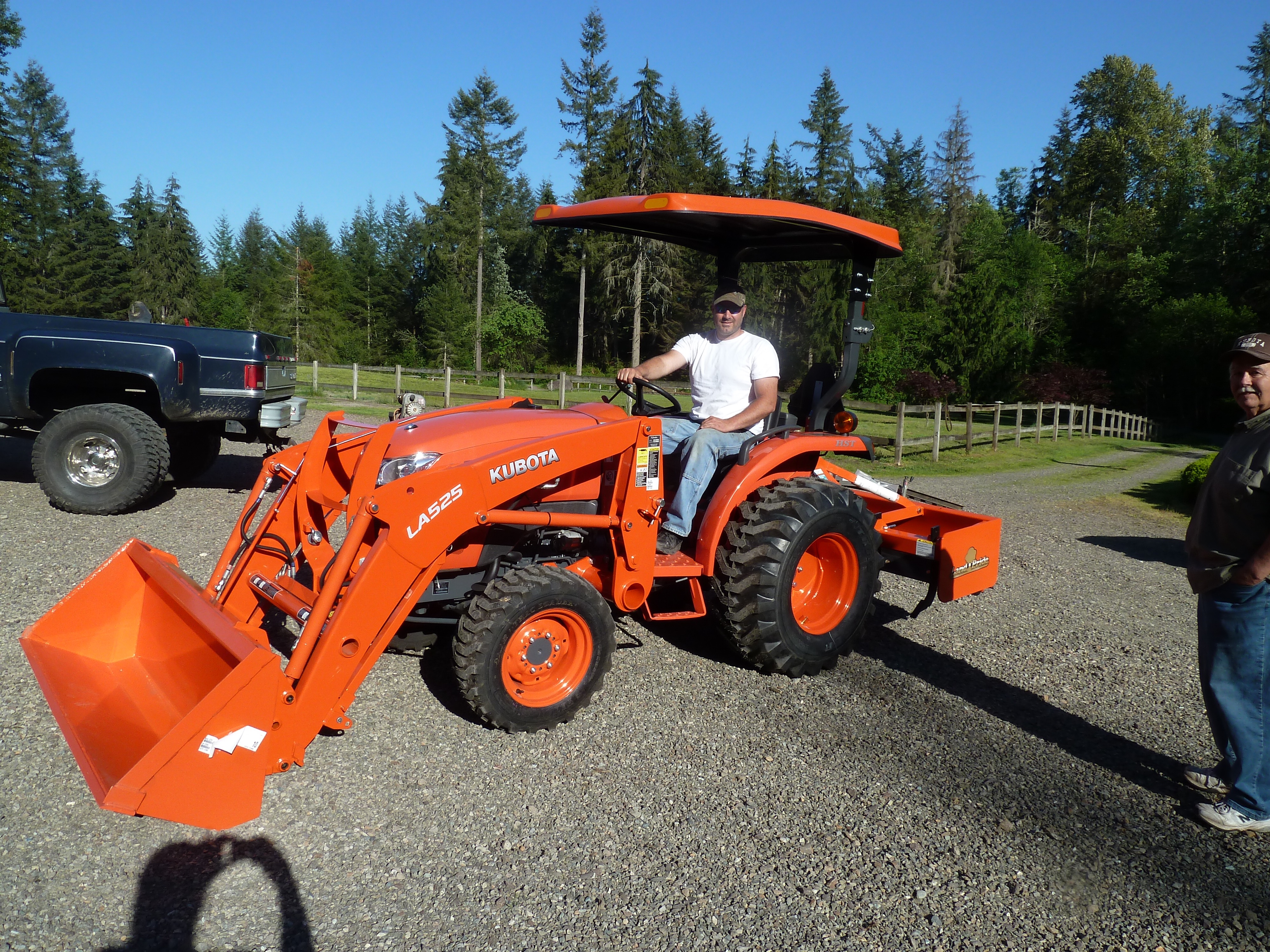

Looks good: had two hrs myself yesterday. So how does that quick hitch work for you? I want one! Same mower but on my L2501 and about the same hook up as yours.
