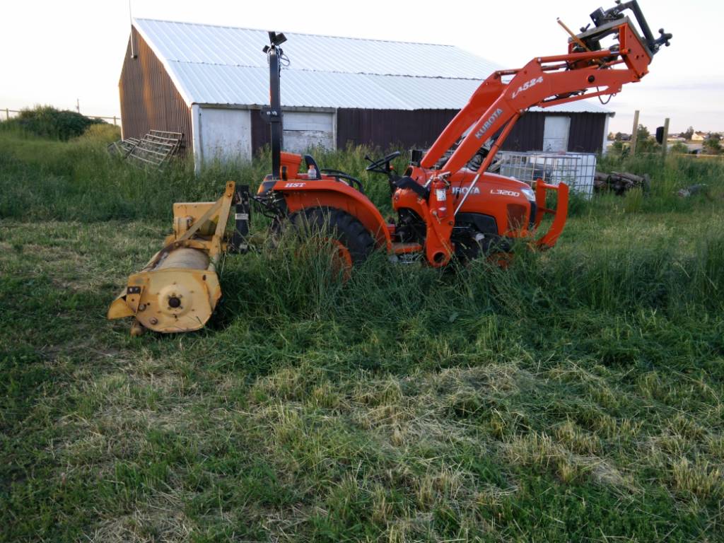

Looks good: had two hrs myself yesterday. So how does that quick hitch work for you? I want one! Same mower but on my L2501 and about the same hook up as yours.
Ricn
Get the Quickhitch....makes life so so easy....worth every penny. I do need to get some bushings fabbed up for each implement and for the top link.
I got the Speeco QH which came with one bushing set.....had to chop the end off to make it work

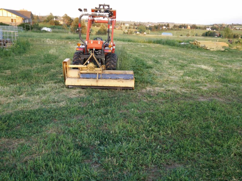

So my Woodmaxx FM62H got dropped off by the shipping Co last Tues and now Sunday got back home to finally get it mounted to the B26.
Stupid me after reading what StuartDK45SE posted about shearing off the grease nipples when adjusting the roller height, I go and do the same dang thing DUHhhh... oh well easy fix.
Shortened up the drive shaft by 3" (using a quick hitch as well),
