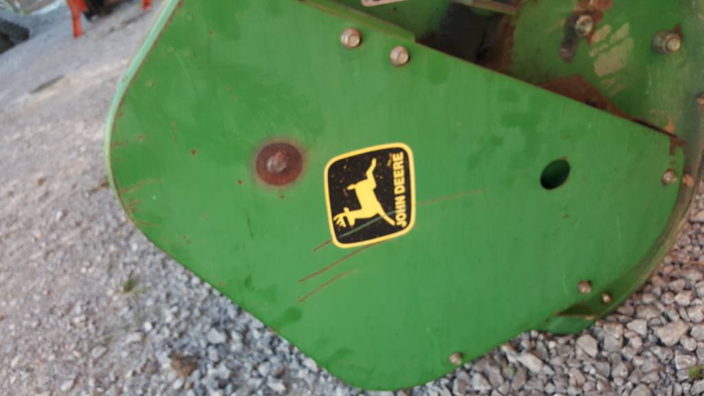

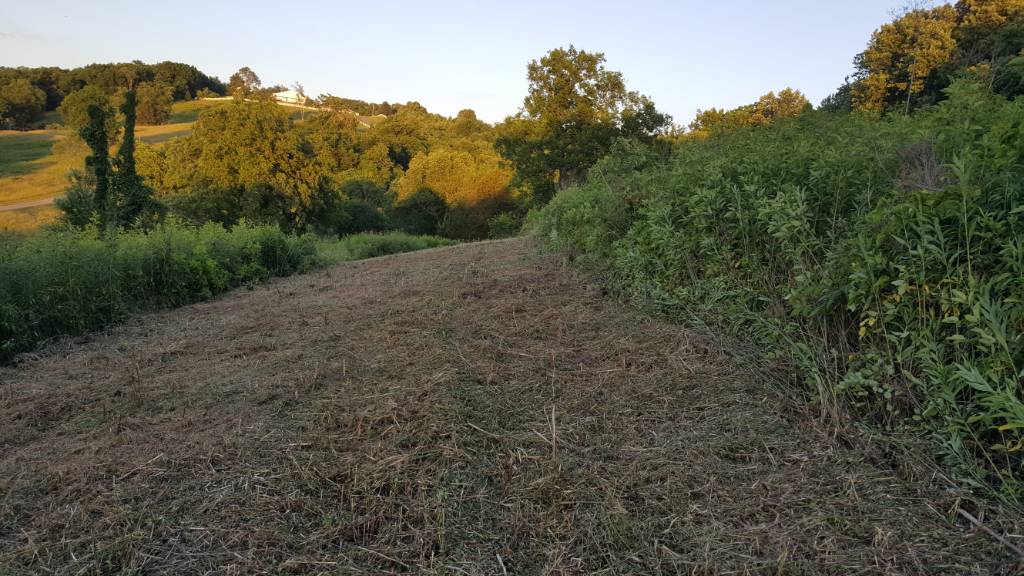

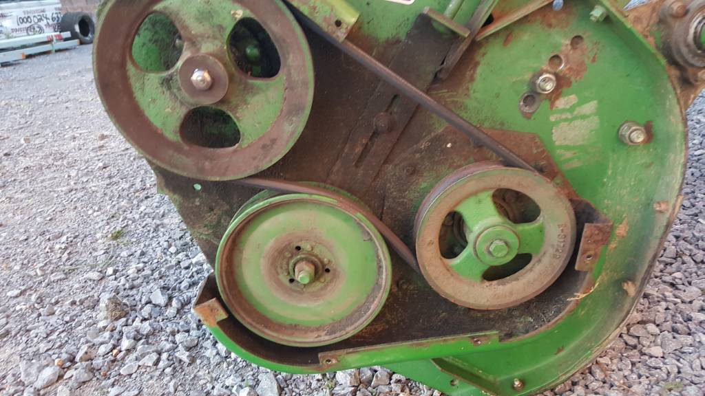

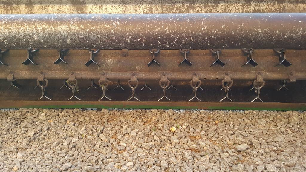

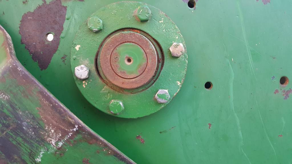

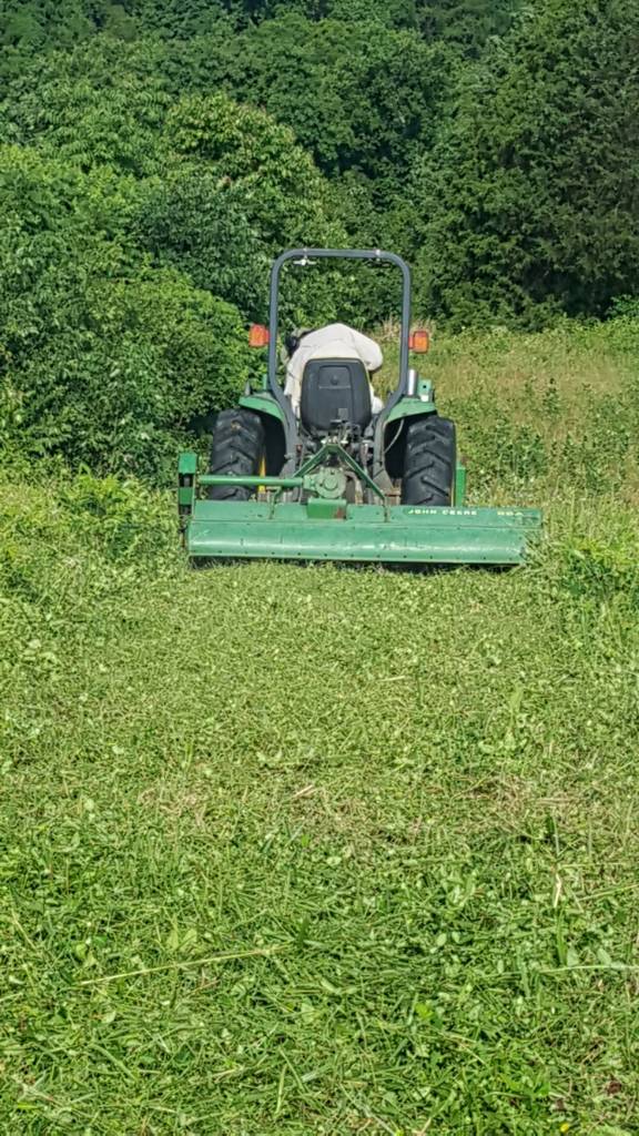

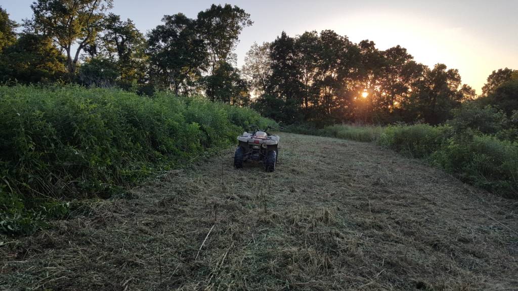

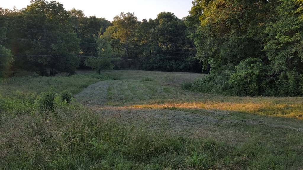

Thank you LEONZ. There are 36 hangers, 72 blades. I replaced all 36 scoop blades with 72 side slicers. I test ran it today. I love this thing!!!!. I cut an overgrown pasture beside where my wife cut yesterday with a 5' rotary cutter. There is no comparison. Clean cut with no wind rows! Ì then cut a few passes on the heavily overgrown side hill. This hillside is covered with 5' tall briars and scrub. Cut it clean on the 2" setting. I did have to occassionally slow the tractor when the RPMs started to drop in the really heavy stuff. Did I mention it is attached to a JD 4300HST with 12.4 R1 tires filled with Rimguard. I mow the fields with the 430 FEL attached.

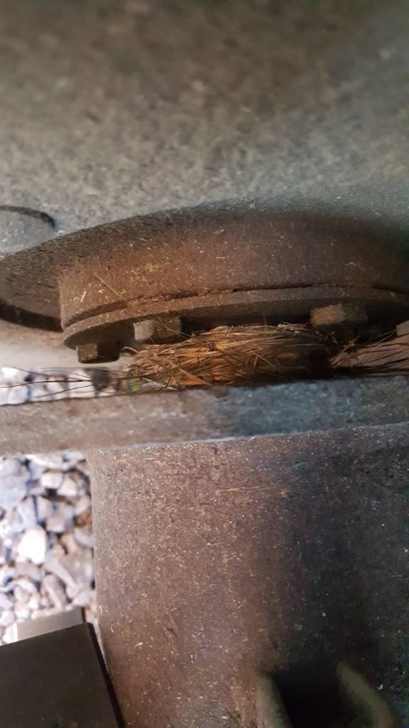

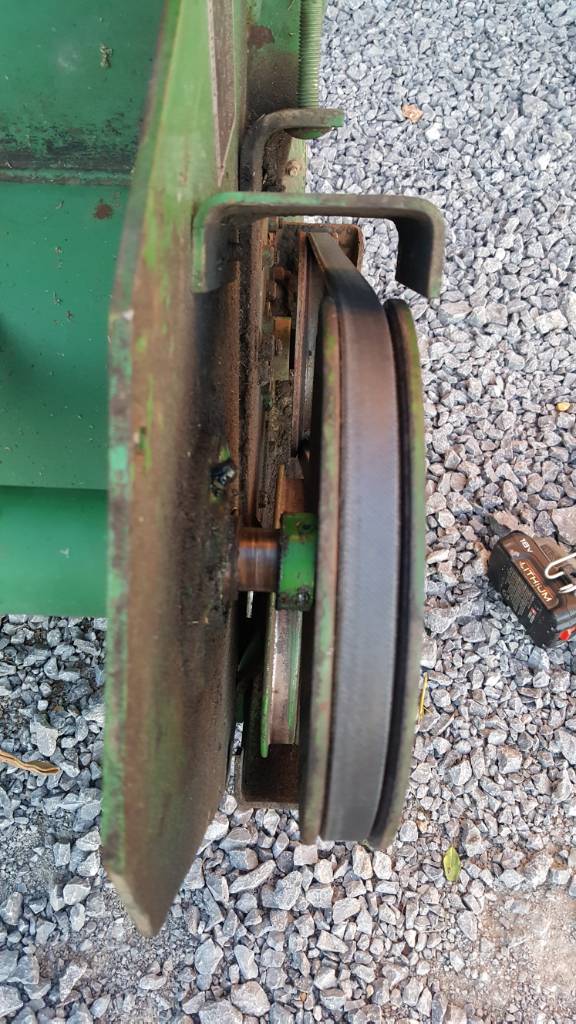

Now for the down side. I didn't replace the hangers and D-rings for my trial. Wound up loosing 5 D-rings (10 blades). A full set of new D-rings and hangers already ordered. I definitely do not have any grease fittings on the bearing housings that i can find. I dont see how the housings could be installed backwards. Also, the drive shaft keeps walking out. It was contacting the safety cover when I bought it, and I reset it to the correct location and secured the lock ring. It walked back out with about 4 hours running. Photos of my mowing and mower below. 20180603_193443.jpeg20180603_193225.jpeg20180603_194424.jpeg20180603_194147.jpeg20180603_193447.jpeg20180603_194437.jpeg20180603_193912.jpeg20180603_194258.jpeg20180603_194513.jpeg20180603_085800.jpeg
   / Let's talk flail mowers #5,119

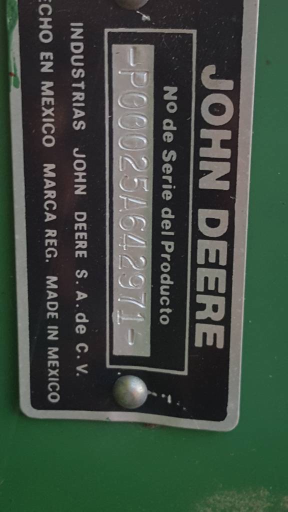

Hello Mr. Thibodeau89,
If at all possible and if the identification tag is still intact you need to visit a JD dealer and see about purchasing a replacement operators and owners manual as well as a parts list.
About the moving flail mower rotor shaft; both set screws are going to be removed and a small dimple drilled in the shafts to assure the shaft does not walk anymore.
I believe that JD did make a flail mower with sealed bearings at one time and that was a bad idea for many reasons.
Please keep us in the loop with your progress with it as you need a bit more work to do and you will have a forever mower.
Leon
Happy mowing
   / Let's talk flail mowers #5,120
S/N tag is preseng and legible. I already picked up the operator manual. The drve shaft bearing is a cam lock type with a single set screw on the collar. The set screw is tight to the shaft. The collar came loose from the cam on the bearing. Perhaps I secured the cam in the wrong direction. Will resecure so that the forward rotation tightens it. I didnt think that the bearing drag would be enough to loosen the cam. May just need a new bearing.
Will pick up new hangers today from Flailmaster. I work a few miles from thier shop.20180603_194208.jpeg
