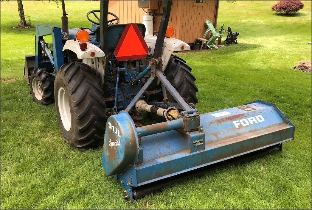

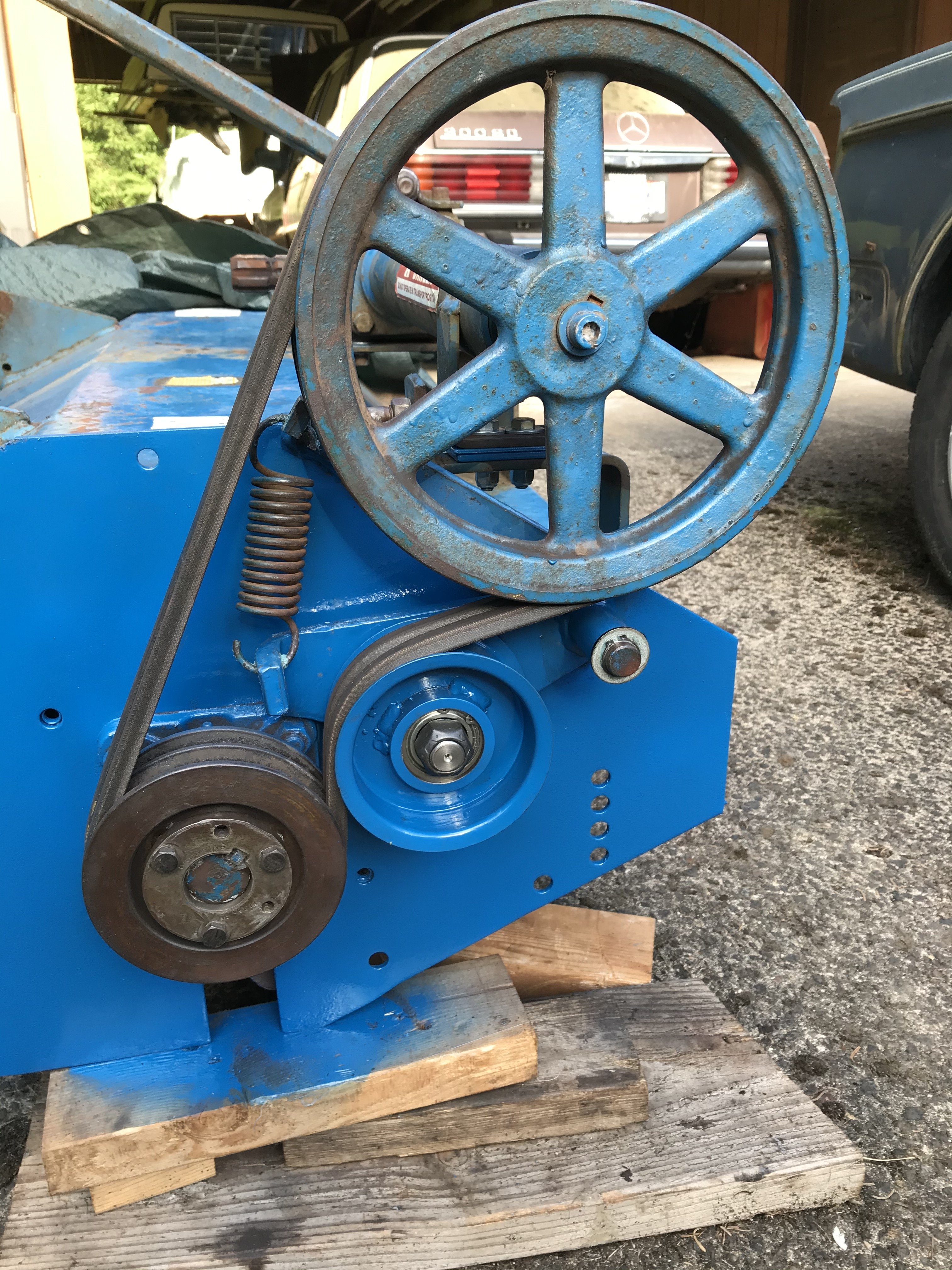

I see often mentioning of V-belt tension gauge which makes me wonder why are the manufacturers not using spring loaded tensioner, like shown in my old Ford 917L Special below - perhaps it's just cheaper to make them without one?
I bought this mower five years ago as a fixer upper and it has worked out very good without any need to mess with the belts, once I figured the correct belt length.
This is obviously light duty mower with side slicer flails and it does a nice job in mowing a field, as well as forested area, without any scalping.
This thread has been very helpful for me!

The European manufacturers use the same side frame weldment frame design for
thier rototillers so they do not bother with designing in a spring tensioner which
requires a snubber pulley arm with a spring.

Interesting both of the 917 flail mowers (74”) I have owned were NOT spring tensioned belts.
I want to convert the current one and I was wondering if a serpentine belt tensioner would work to tension the belt.

My old 917 has a threaded rod & not a spring loaded tensioner as well. I'd assume patent issues or just being cheap.

There were 50" and 60" versions made of 917L Special flail mower.
The 60" model like mine, came with spring loaded tensioner, the 50" model did not!
From the Ford manual:

I had a 917 with the threaded rod as the belt tensioner. i drilled a new hole for the "L" bracket further in and put a rather stiff spring between the bracket and the adjusting nut with a locknut behind it.
