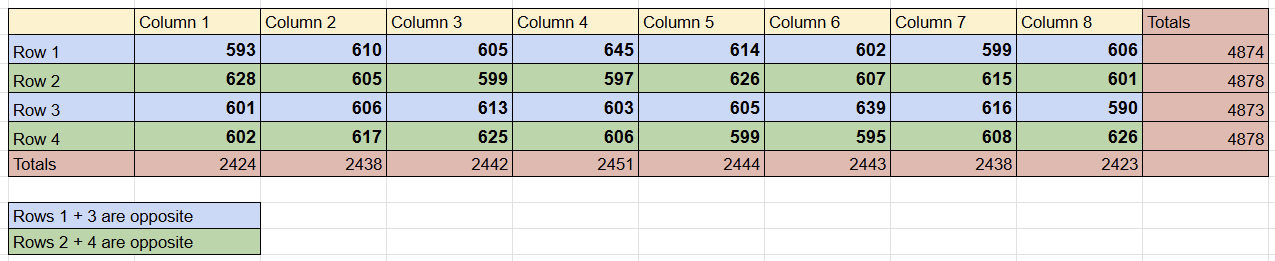

Over the weekend I decided to take the flails off my mower and give them a good sharpening. I then became OCD about the balancing and decided to weigh (measured in grams) every flail and toss the weights into a spreadsheet and calculate the most balanced combination I could come up with. For reference, the mower drum has 4 rows of 8 hammers/row, 32 in total. Rows 1+3 are opposing. Rows 2+4 are opposing. The hammers are staggered on the drum for overlap. I focused on getting the opposing sides balanced and keep the difference across all 4 rows minimal. I could definitely get better results if I ground down the 645 and 639 flails as they are the heavy outliers but all in all this was the best outcome I could come up with. Do you guys do anything crazy like this, or do you just grind em down and toss em back on?

I don't mess with them until they stop cutting well or throw off the balance.
That level of precision isn't necessary. The first time you come across a big stick or a small rock, your spreadsheet would have to be reworked.
I'm a big spreadsheet guy, but that's tilting at windmills.
/ Let's talk flail mowers #8,170
I can appreciate your efforts balancing the blades etc.
I hit them with a flap disc grinder without removing them annually.
Simply raise the mower to waist height hanging from chain using the forklift. It's a 10 minute job. ;)

UGHH!!!!!!!!!!!
Are the flail mower rotor weights used to balance the flail mower rotor
"by itself": and after "the mounting stations were welded to the flail mower
rotor" still welded to the flail mower rotor???
Did you clean the hammers to bare metal with hot water and
Dawn dish soap??

Only reason for removing them is I made the mistake of clearing some brush in the woods and made contact with some big rocks sticking out of the ground that I couldn't see and some flails got pretty beat up. None broken luckily but the edges were bad enough that it would knock down grass instead of cutting it.
@leonz, it's a Betstco flail mower so whatever the Chinese do to balance these things are probably not that accurate anyways. I would like to think the rotor would be balanced after the mounting points are welded on. No way of knowing though. It's not like you get a balancing sheet with these things. But, I do know the hammers on my mower are marketed at 27oz and not a single one is anywhere close to 27oz. Chinese products in a nutshell. Hammers were cleaned with soap and water prior to sharpening and weighing. Used a flap disc and grinder to sharpen. I'm not OCD enough to measure an exact angle, just following the factory edge by hand.
I'll be putting the flails on tomorrow and I'll let everyone know if any issues come about with the balancing so others know what not to do if it doesn't work out. Lol
/ Let's talk flail mowers #8,174
An update on the "balancing" after sharpening.
No issues found. Mower operates smooth and cuts far better than it did when new. I'll probably continue to use the method I did if I need to sharpen them again. Hopefully not anytime soon. No more using it as brush mower.

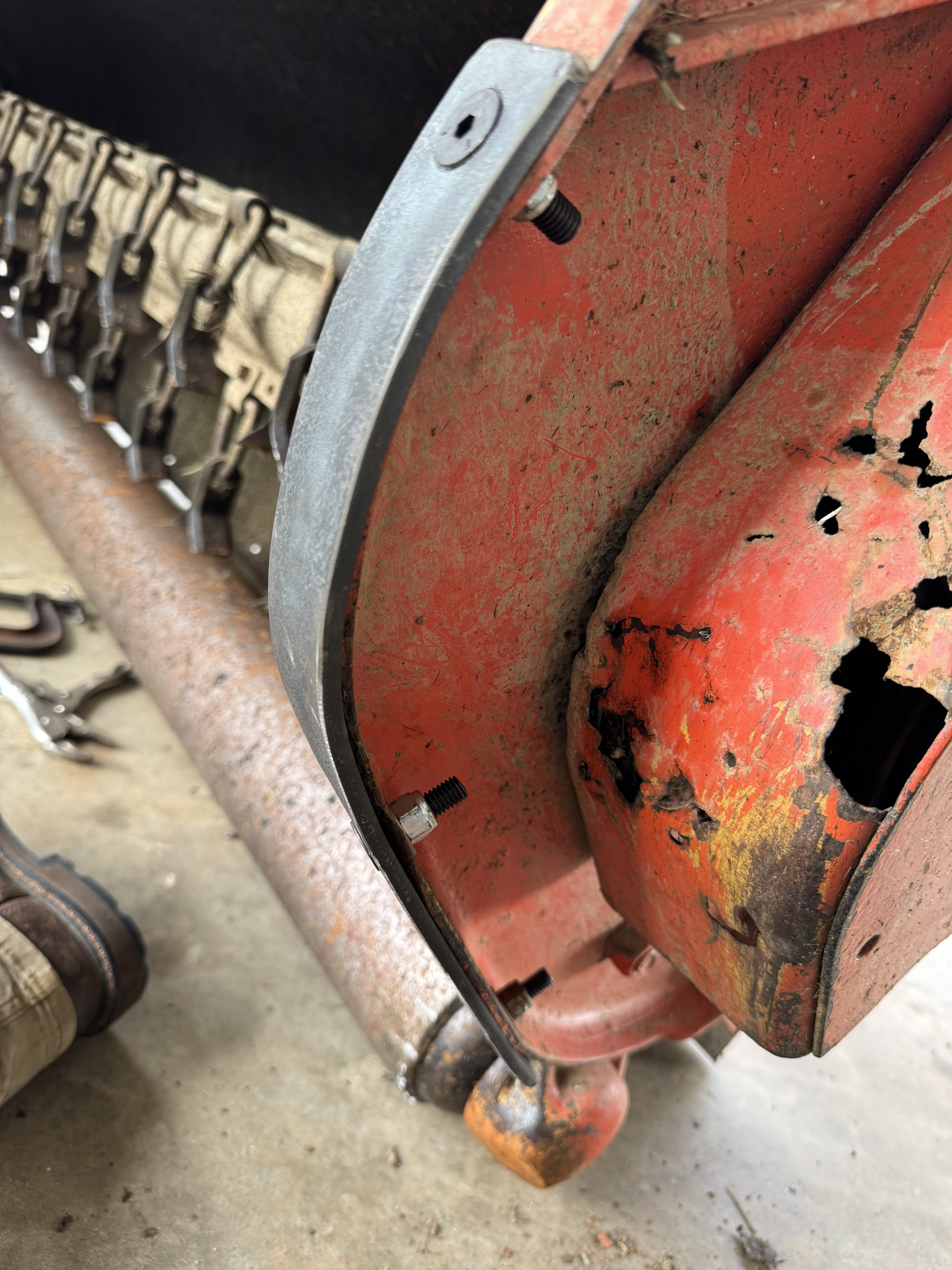

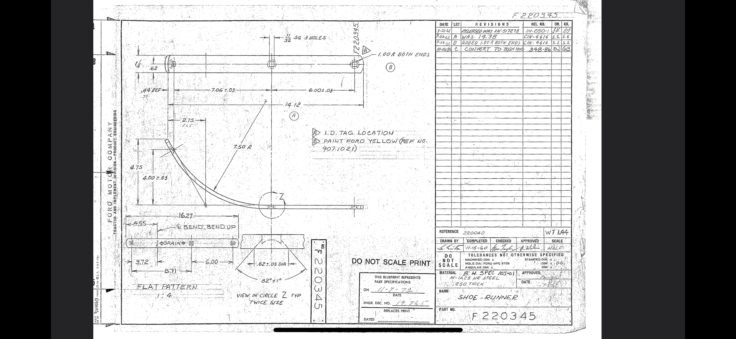

FYI 917 (aka the Bush Hog FH174 or FH188 also) the skid shoes that go on either side are no longer available.
Here is a drawing of them.

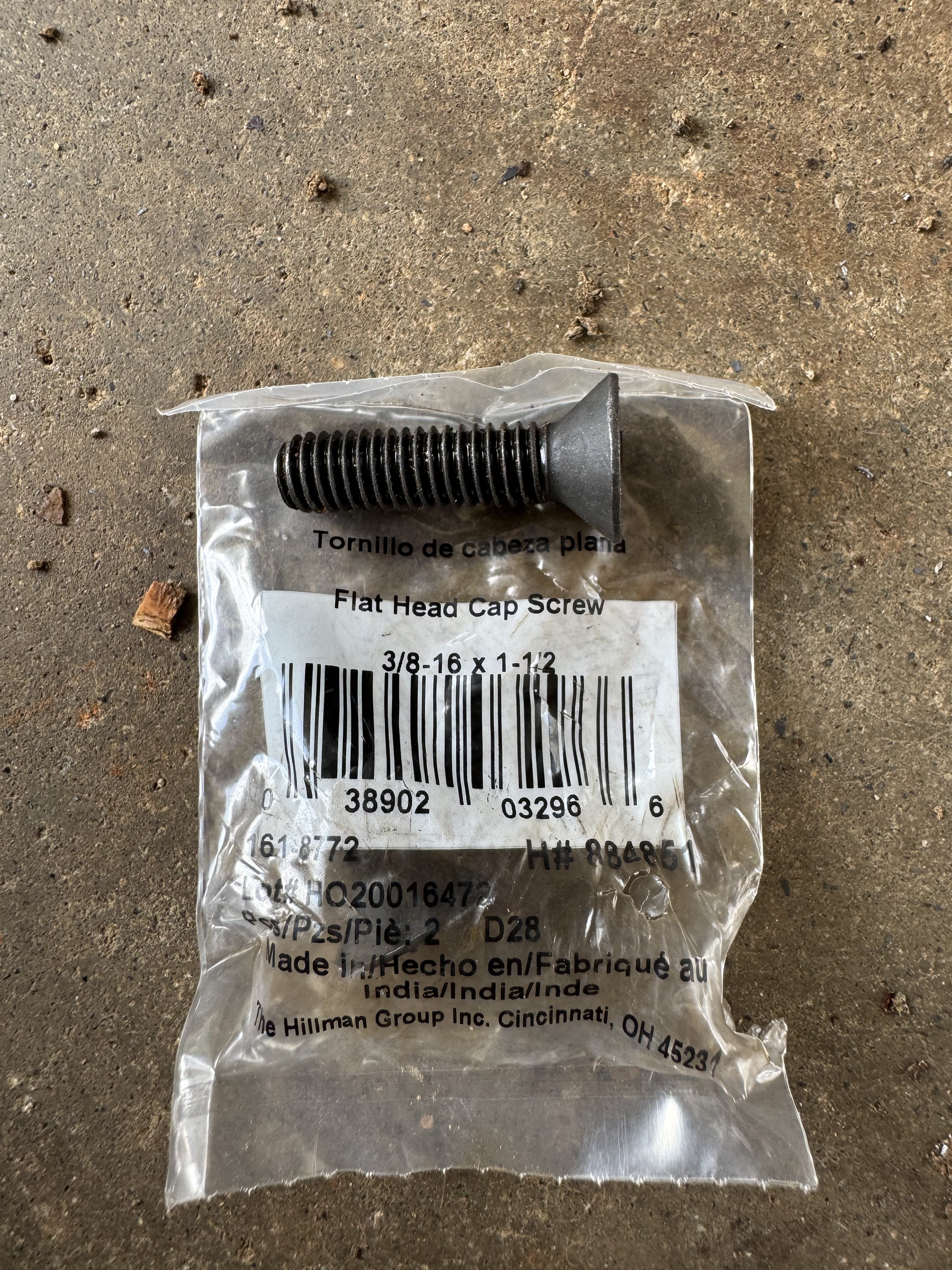

They come from the factory with 5/16” plow bolts. However I couldn’t get any, so I used a 3/8” flat head cap screw/bolt.
I used 1.5”x.25 strap steel 36” long to make them.
Bush Hog said they made the 917 for Ford.
