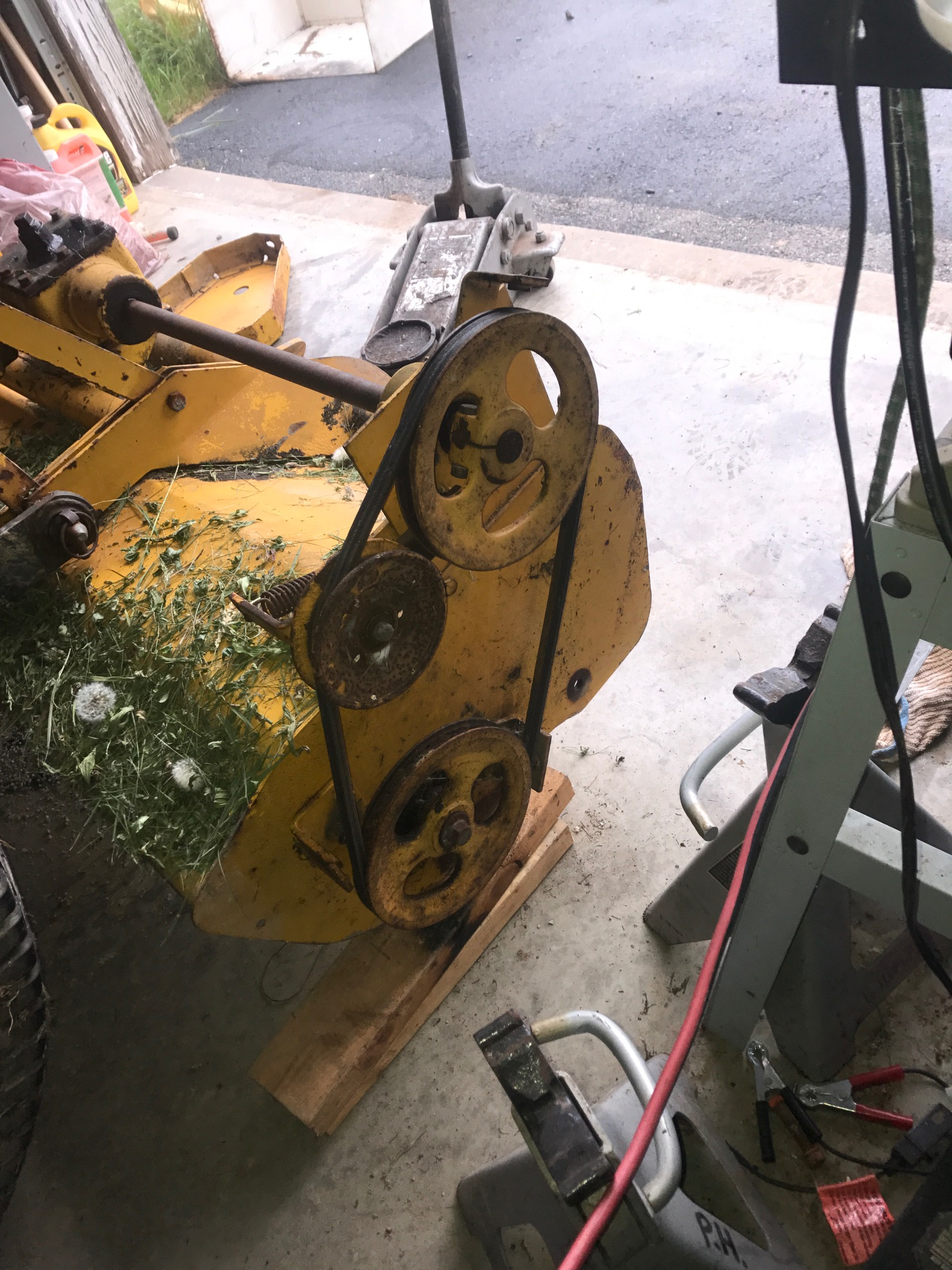

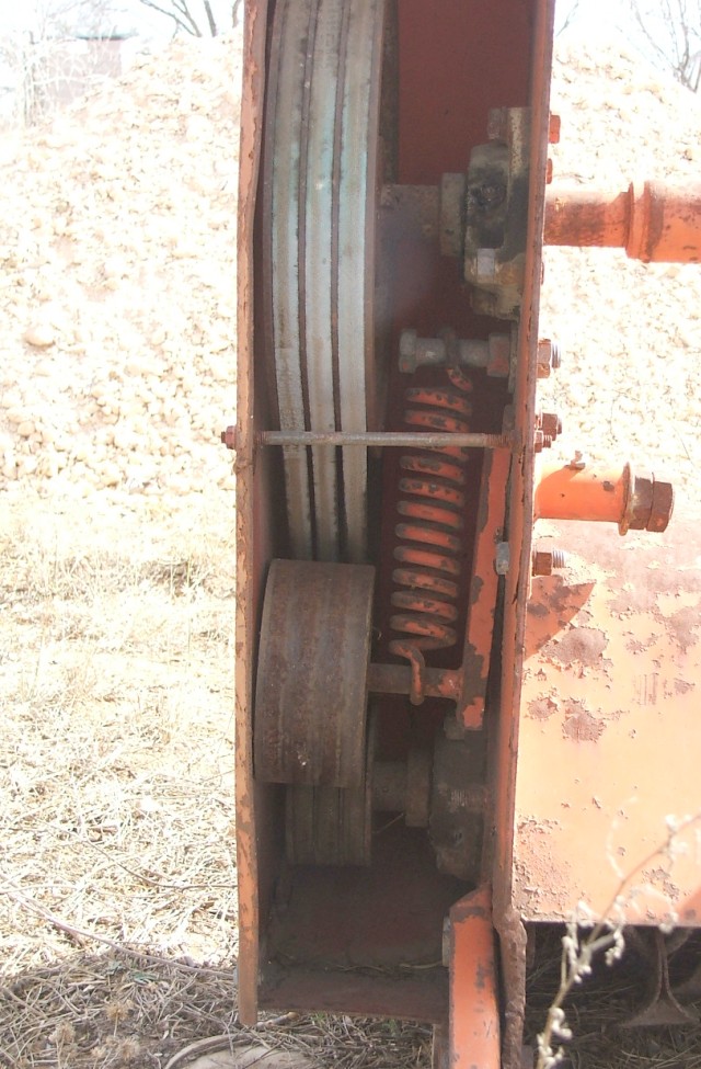

They did sell toe guards for the reverse rotation machines to keep that debris from hitting the back of the tractor. I doubt you'll find an OEM unit now, but you might be able to knock one out if you're decent at fabrication...
So yea, looks like the idler should be inside the belt on your unit. Still think that's a higher input RPM gearbox, but if it works for you otherwise, have at it once you get the belt on.

Thanks toolslinger. I think what you are saying makes good sense.
Thanks Xfaxman: agreed that the belt seems short. Thanks for the picture.

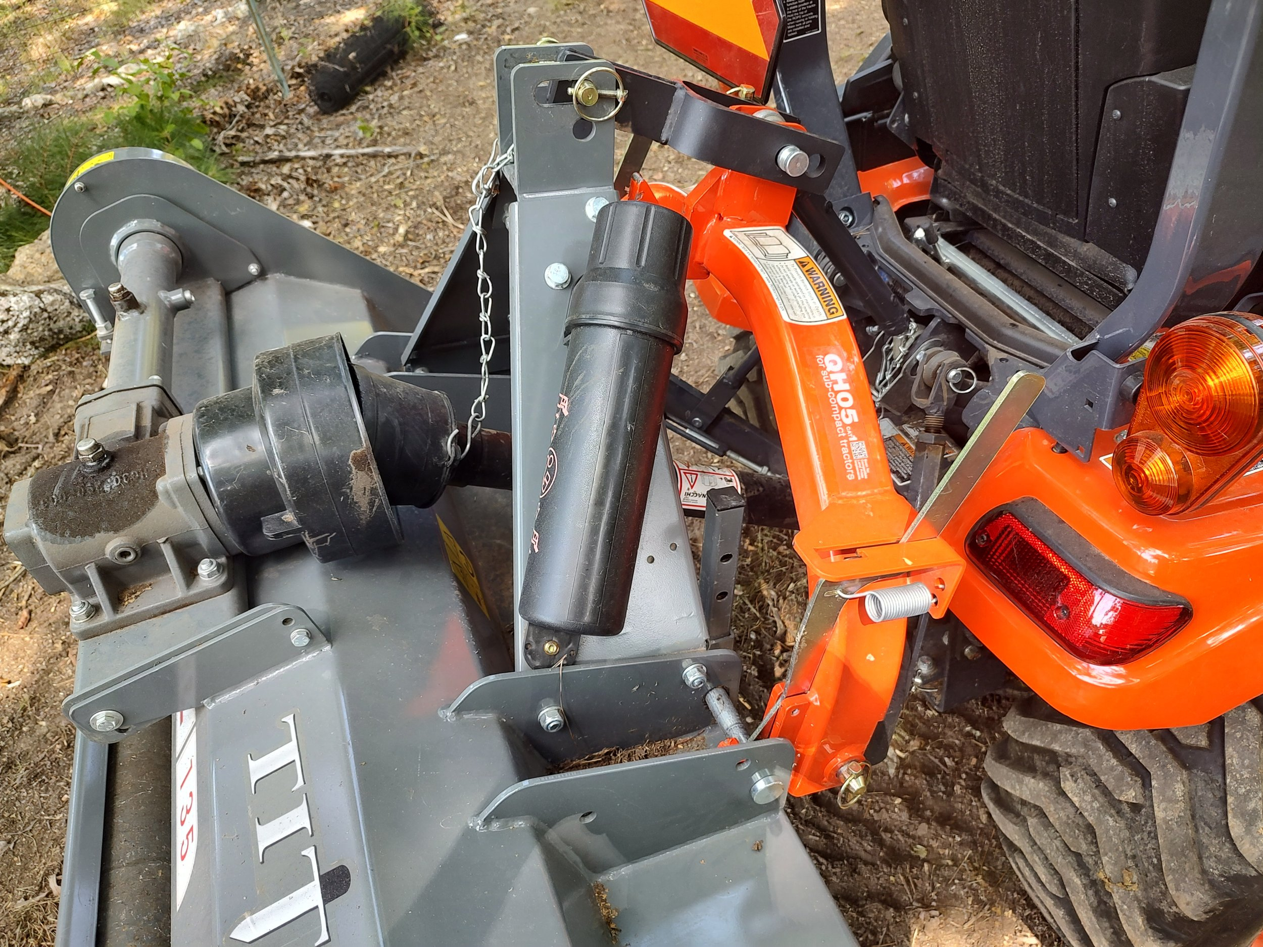

New tractor owner and first time poster here.
After reading a lot of this thread and some others, I settled on a flail mower instead of a brush hog.
I ended up getting this Titan FL135 from a dealer in my state. Apparently these are not very popular in Alabama and this dealer was the only one I found that stocked small flail mowers.
I haven't seen much info out there on this model, so I thought I would share.
This is an Italian mower made by Cosmo and imported by Titan Implements (not palletforks dot com). I paid $2000 for it at Dixie Horse and Mule Company. It came with hammers installed but also included the Y blades. I wouldn't say it's QH compatible but I was able to connect it to my QH.
My little Kubota BX has no problem at all running it and I have been abusing it quite hard clearing some woods. I have been very pleased so far.
View attachment 756753View attachment 756754View attachment 756755
Axleman, u will like that mower. My post right before yours is exact same except older. I have switched to y knives since I got my area cleared and it does good job. Check bolt tightness every so often. Even the locknuts will work loose

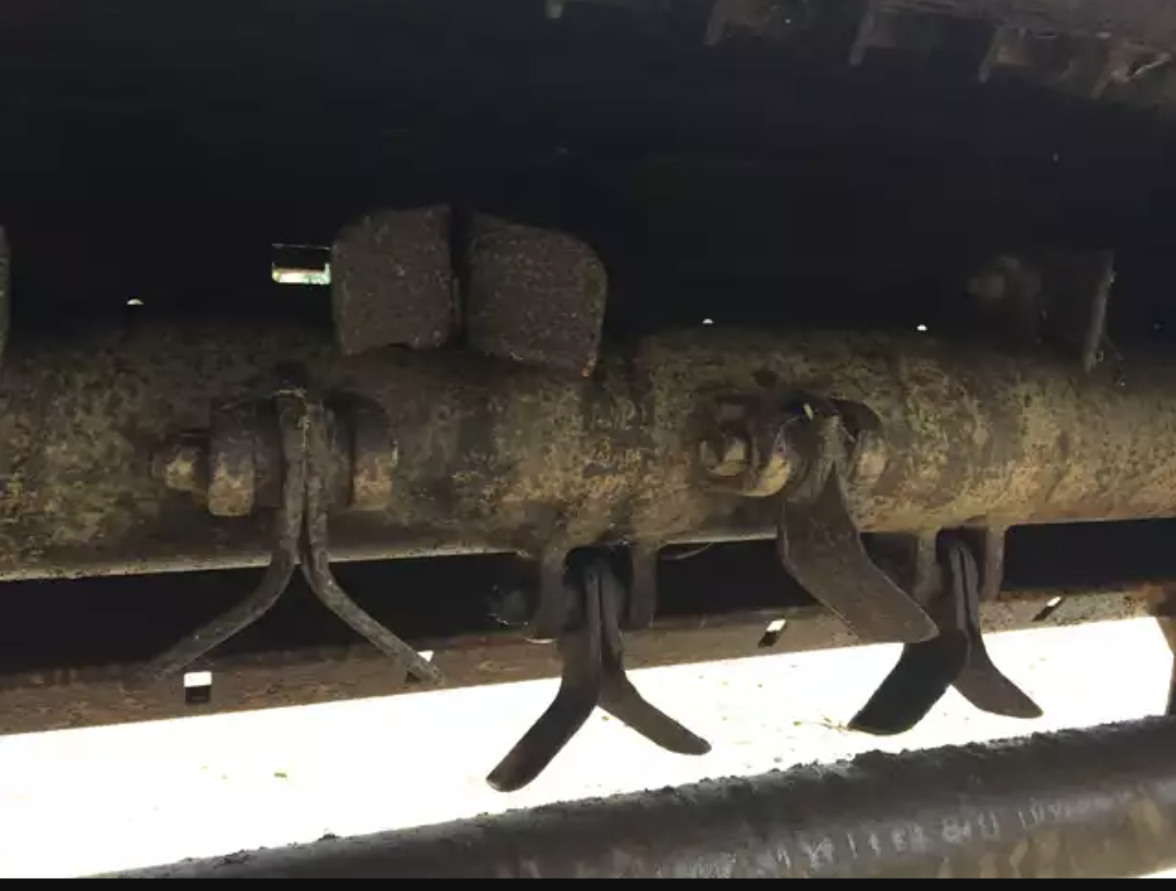

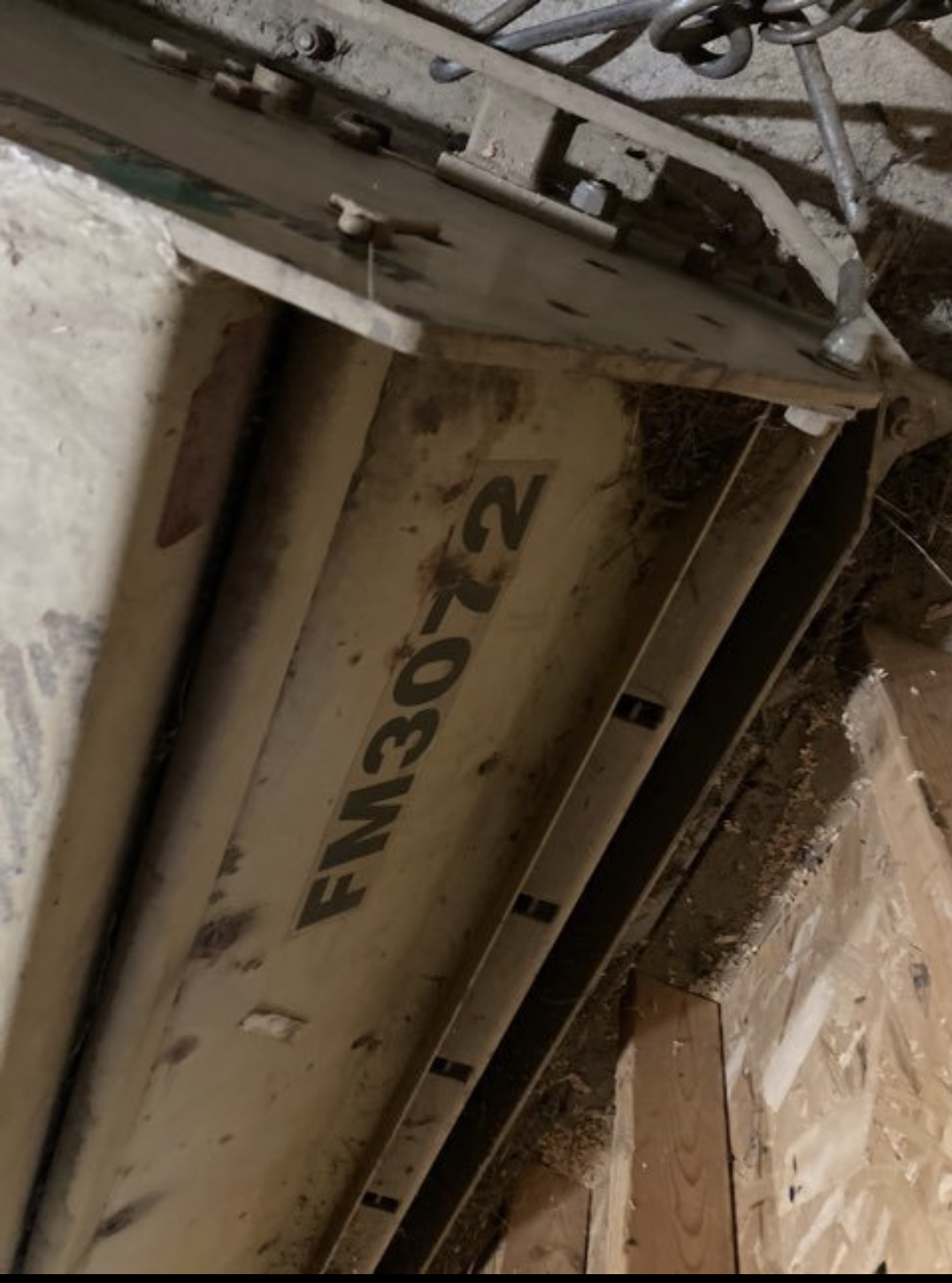

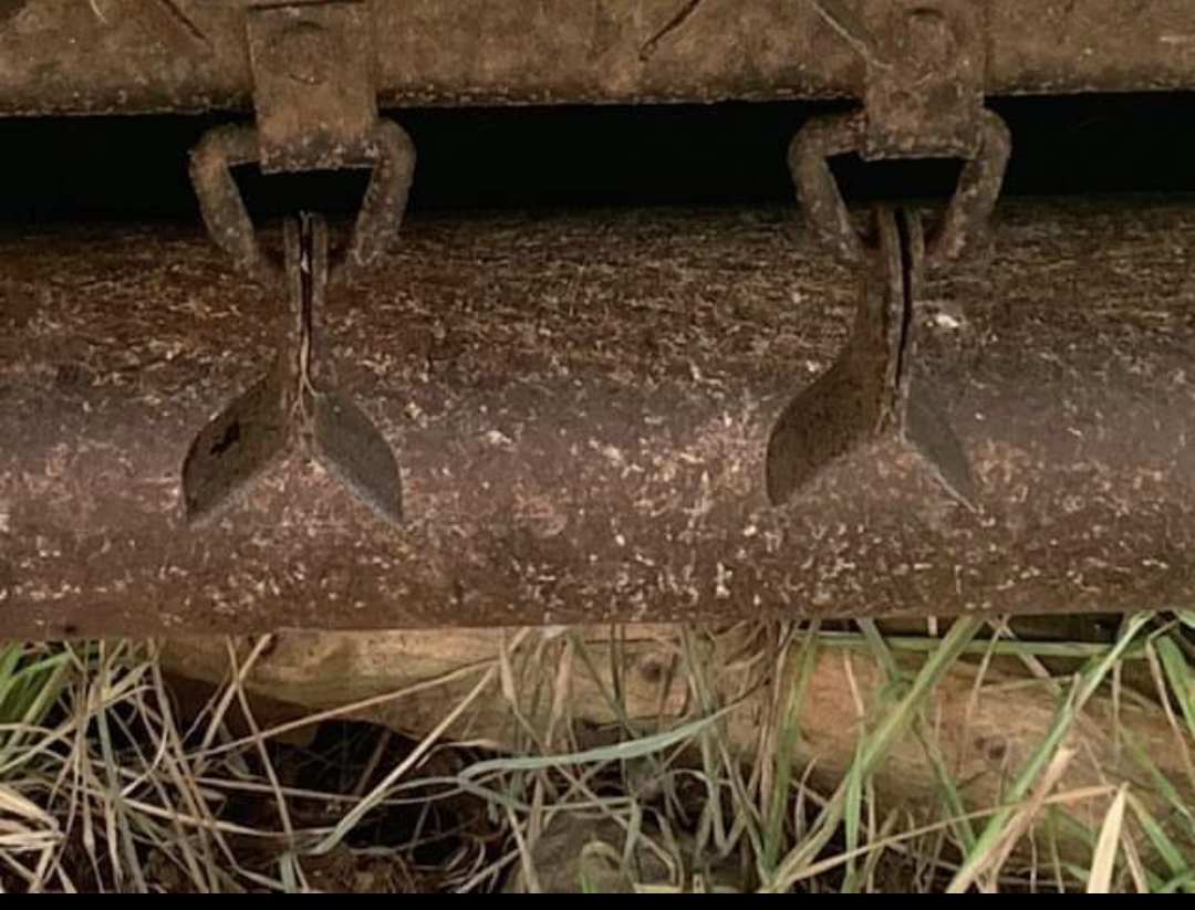

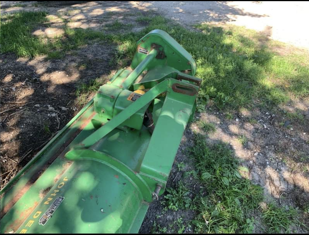

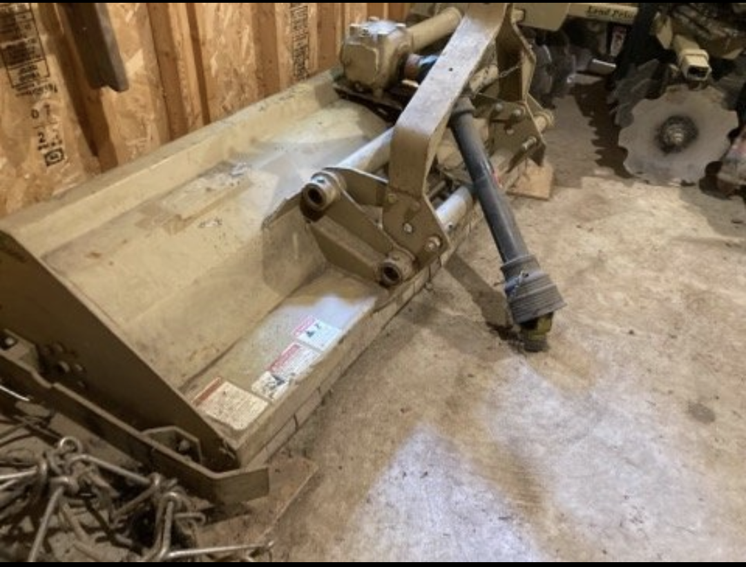

Can you smart guys (and gals) help me pick a used flail mower, and maybe answer a question about different knife types? I'm located in central Wi, with a 45hp tractor (1969 Case 580ck w/draftomatic 3pt and pto). My main use will be grooming a few acres of pasture with a little bit of fallen tree branches and occasional smaller saplings to mow over/mulch. Not necessarily looking to make the pasture look like a lawn-just want something that cuts and mulches better than a brush hog.
I have a couple of options that are currently listed:
6' John Deere 25a
6' Land Pride FM3072
They're both listed at roughly the same price.
Any opinion on which would be better for my needs? Also curious if there is a performance difference between those two knife styles. I notice that the 25a has the knives attached to the rotor via a clevis looking thing, whereas the Landpride is just pinned to the rotor. Is there advantage of one over the other? I tend to think the clevis type attachment would handle trash/debris better but would love to hear all your thoughts. Thank you.

Hello from Eastern WI.
I would personally take the JD 25A only because parts are going to be more readily available aftermarket. Either way, Flailmaster should have the knives and probably some other parts. The advantage of the clevis mount is the blades have an additional direction to move if they strike something. The knives will do just fine for what you are looking to do. I have an Alamo with a similar set up as the JD 25A, and I use it for the same stuff. I also mow my lawn with it, but I don't care much about my lawn so it does just fine for me. Just be careful on the fallen branches. I try to not run over anything over an inch or two. I've had larger pieces wedge into the hood and destroy my belt. When I mow heavier grass it will leave a nice carpet of clippings behind. I'd snap it up quick as they don't last long on the used market in this area it seems.

I'd anticipate the JD to be about $1200 and the Land Pride to be about $1500, but those might be low as I'm basing this off when I was looking and selling a few years ago. Seeing that new prices have almost doubled on some implements, I wouldn't be surprised if they're asking double my numbers.
I would also like to note that those are not the original blades for the JD. JD used a duck-foot looking blade (seen in the Flailmaster catalog). But what is on there is a good replacement as those are the Alamo style blades. They are better priced and more readily available.
I have the SHD88 on my MF 2706E. I paid $1200 for it, but I drove 3 hours each way to pick it up in IL. It was an old Tollway mower and it was in need of all new blades, clevises, and pins. I also had to replace the rear roller after about 2 years use, because it was dented pretty bad when I got it. It broke one day mowing the ditch. I welded it back together to hold on until I was able to replace it. I was able to get the roller ends from Flailmaster and a piece of tube locally, and then weld it together myself. I also replaced the roller bearings at that time.

I only have experience with a 6 ft Caroni with 56 Y blades & 28 clevis’s. I replaced all bolts, nylocks, and clevis’s recently in an all in refurbishment. Clevis’s are the most expensive part.

I bought a JD 25A a few years ago that was severely abused and rusted into the ground. After replacing all the bearings, blades and clevis and several hours of welding it works like a charm. I was so happy with it's performance I cleaned it up and painted it.
