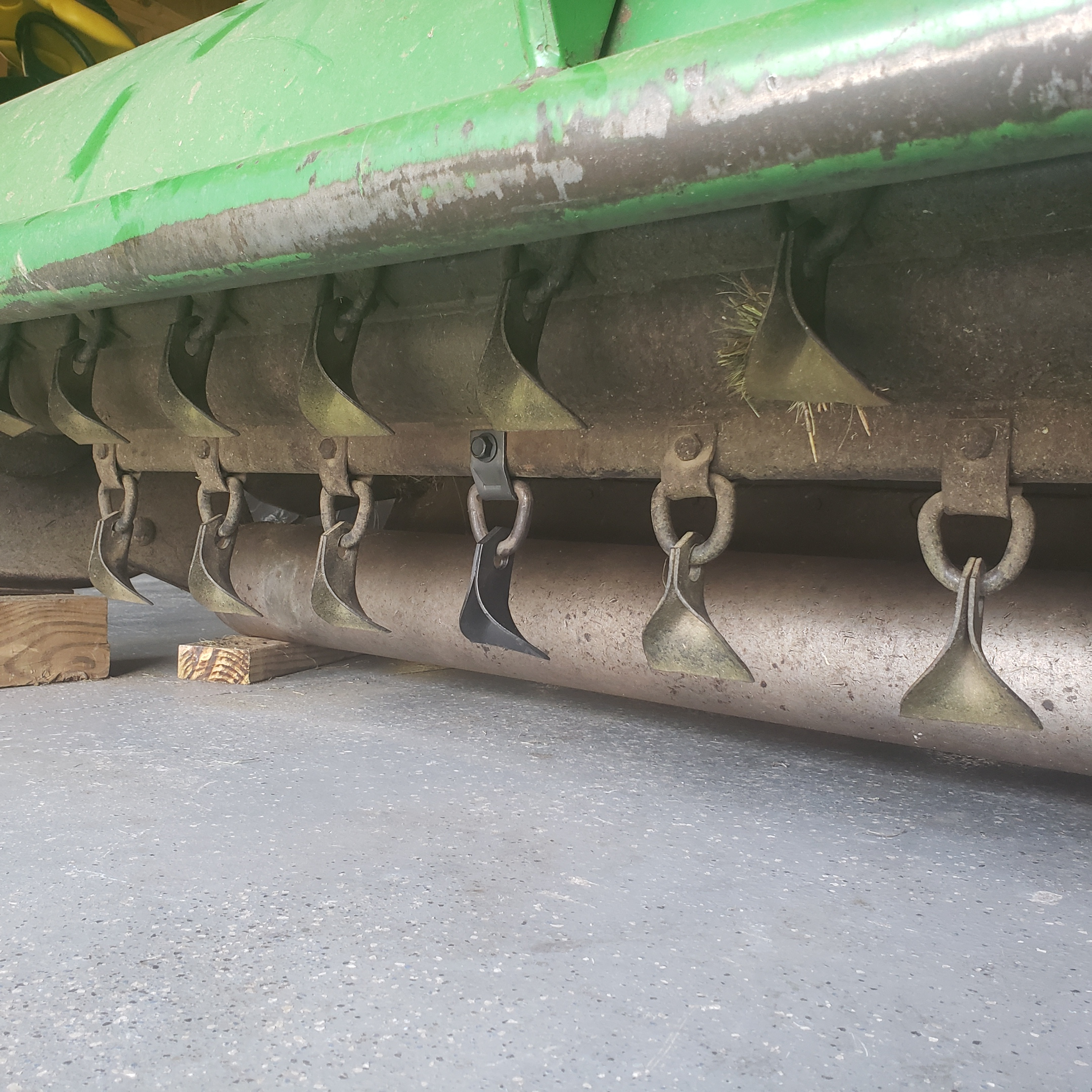

leonz - I have an iMatch quick hitch on it and flail only has one hole. Its in the float when mowing and raise front end of flail in higher stuff. Real high and thick stuff I had to lift mower and roller up about 4 inches.
Grass wrapping around rotor and getting warm is my concern. I'm guessing that's from grass too high. Doesn't seem to wrap in lower tin stuff. 1st pic is where its wrapping..after I cleaned it out.
Do I have the best blades for cutting grass shown in 2nd pic? Wasn't sure if side slicers would be better Grass only. Very little brush at field edges. Have a brush hog for that stuff sitting nearby for that.
thanks again for the help everyone.

leonz - I have an iMatch quick hitch on it and flail only has one hole. It's in the float when mowing and raise front end of flail in higher stuff. Real high and thick stuff I had to lift mower and roller up about 4 inches.
Grass wrapping around rotor and getting warm is my concern. I'm guessing that's from grass too high. Doesn't seem to wrap in lower thin stuff. 1st pic is where its wrapping..after I cleaned it out.
Good morning Nittanyjd,
The scoop knives you have are a multi-purpose mowing and shredding knife.
The side slicer knife with the slotted mounting hole is best suited for shredding brush
and mowing grass as you can make multiple passes to shred the grass and brush to a
very fine clipping that will rot away and dissolve in the soil quickly.
