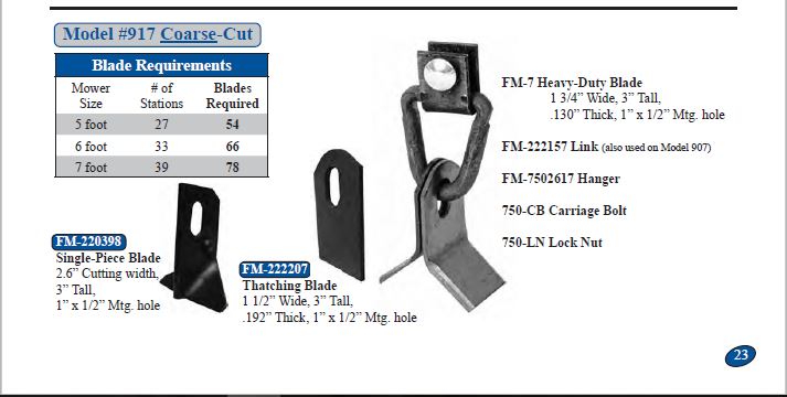

Thanks to @TheFarmerInAdell for posting the picture in post #6576 that is from the Flailmaster PDF. The bottom of page 23 for the Ford 917 specific blades/hangers etal.
If you look at the top of page 2 on the Flailmaster PDF for the Alamo/Mott blades there is the "fine cut" model #MH-386. Is there any data that anyone has showing/proving (past experience?) these are too long to try and use in the Ford 917?
If you look at this page from clean cutter in California, it gives the size & measurements of the blades that match the pictures and measurements of the craigslist ad I am referencing below.
http://www.cleancutter.com/CL102086.htm
As a comparison from the Messicks PDF for the Alamo/Mott mowers [Model # AC60 and the AC60 Brahma from the archive] have the same looking blade but, the measurements are not something I have found yet..

How would I figure out if these "Mott stamped blades" on craigslist are too long for the Ford 917 mower?
Is there a needed distance for flow of the cut up debre/mulched grass/etc as well as the tip of the blades minimum distance to the rounded shell of the housing that the 3-point arms are bolted to?
If so how much and where should I try measuring? (There, I hope the focus was better this time and the dyslexia doesn't byte me this time)

The MH-386 will not work. Go down to the 917 section of the Flailmaster catalog and it says the measurements of the 917 fine cut blade at 1-1/4" wide 3-1/2" tall. You could use the MH-293, but it will be shorter than the Ford version. I would suggest the airplane wing blades in place of going to a fine cut as you already have the hangers and brackets for them. This will give you a nice flat cut. If you want a very high quality cut you can switch over to the fine cut, but stick with the Ford blades.
Some dents in the back of my 917 they I really cant see in these photos lead to the knives hitting the hood. When I got the flail ($100) it was missing knives, presumably to combat this issue. I cut out & patched a large chunk of the rear of the hood & replaced knives to fix this.
Which is probably a long way to say there is probably between 1/4 & 1/2" between the knives & hood when its it's running right. I can't comment on what blades may or may not fit beyond ones designed for a 917.
Yes you can also see the cracks in the hood in the missing knives photo. I never did bother getting around to dealing with those as it ran fine (for a $100 mower), if a bit noisy. Ran it for 2-3 years like that before retiring it & upgrading to a Peruzzo Brush Bull. IMG_20150525_185656.jpgIMG_20150613_203410-1.jpgIMG_20150529_181633-1.jpg

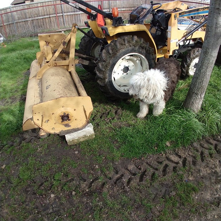

Okay, technically it's now "Monday" but, 'yesterday' I went a head and did a systems check and tested the 917 on a absolutely saturated back yard that had some varies growth. The missing 5-6 blades did have a noticable but still mild vibration while running.
The Cub cadet is claimed to be a 25hp unit. The 7260 (for refresher)
Here's the edited down pics of a test mowing and a post mow shot that one of our OES's is inspecting.
The trench I dug as part of a upgrade for drainage from the gutters. To get past the chicken coop. with the constant on/off rain its been very difficult trying to finish this all.
This 1st go at mowing with the 917 was a pleasant surprise. yes the accoustic signature was definately different, a much 'lower roar, if i dare say it. compared to the Bush Hog finish mower.
I did have to run the tractor at the 2300-2500 RPMS which is the "desired" 540 PTO RPMs but, that wasn't so bad.
I was able to cut 80% in M 3rd and occasionally the high spots were a drop to M2 gear and it did fine. The forward roll given the top link needing adjustment means next time I won't try to mulch the terf on a couple divet areas.
but, that yard is sooo saturated. over 8" this month alone......

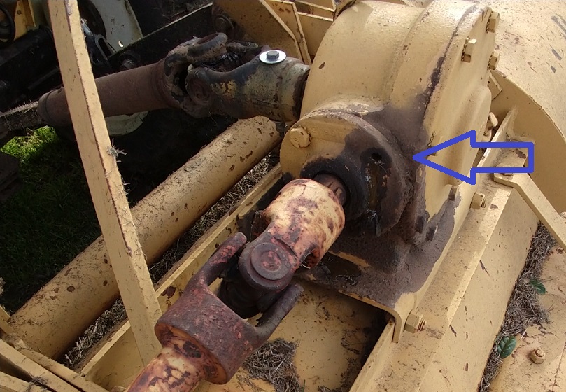

Oh yeah, and I'll be solving the bolt that spun out and disappeared(purple arrow).... drain and fill the gearbox when I do that too.

Looks nice. Get them blades on and you will have a winner for sure. I get my blades from flail master. You may want to get a whole set, and keep the old ones as spares. You will lose an occasional blade or two from rock strikes. Also, avoid wire. If you are not sure there is wire where you mow, walk the area first. Trust me, wire is no fun at all. I learned that lesson the hard way, twice!

still need to deal with that bolt on the gearbox..... but, its been rain and now brisk weather ....
