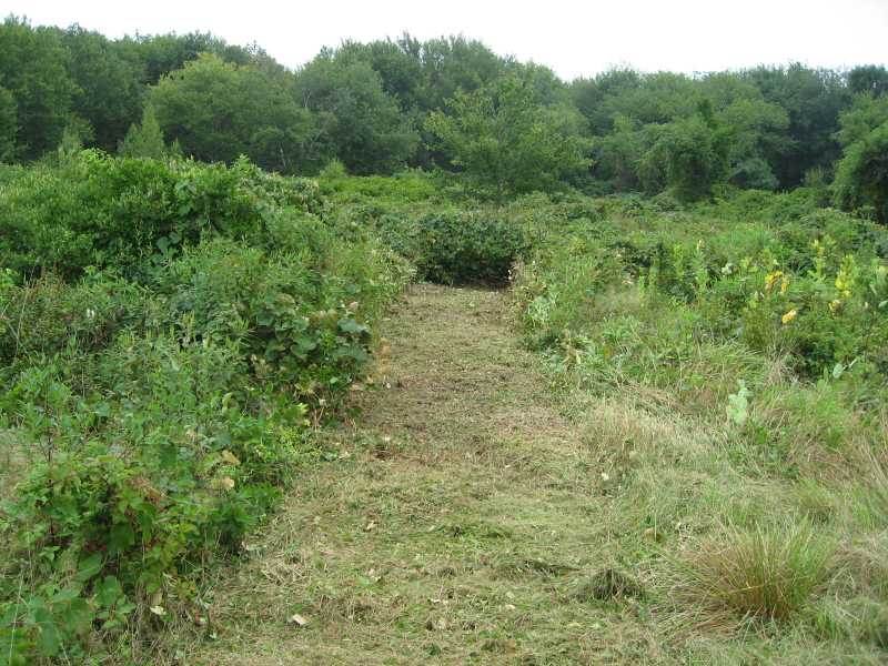

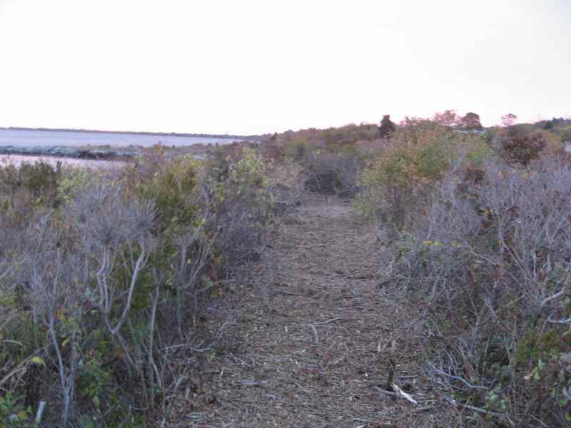

No, the flails do not "blow" grass or anything else. I haven't done it but a flail could probably mulch your leaves pretty well if you drove over them. Bottom line though is that there is, to my knowledge, no such thing as a grass catcher for a flail mower and flails don't have either side or rear "discharge". There is a metal flap in front that keeps material under the mower. The roller does the same for the back and the sides are solid.
Basically anything under the mower is cut and recut until the mower moves forward. That is one way to determine how finely you want to cut up brush. Again, I've posted this photo before but the first photo is essentially what you get if you go slowly through brush up to 2 inches thick. The second shows what happens when you just drive through at medium bush hog speed.
