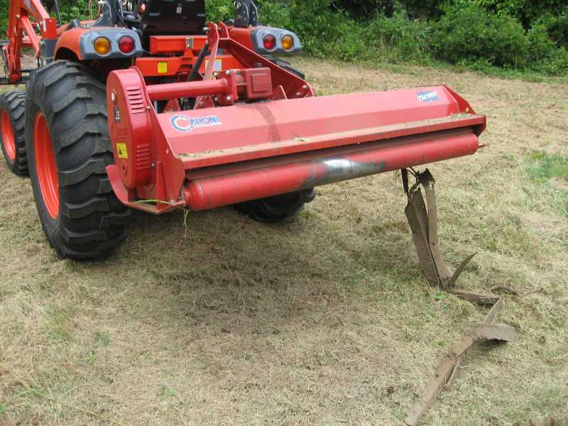

Have enjoyed reading this thread.
Can anyone address the real world cutting capbilities of the 3 knife styles that Caroni offers on the TM models?
A) TM1900A (Normal cut knives, with 56 total knives)
I am guessing this is mostly for grass, but how tall of grass/weeds would this handle? What diameter brush?
B) TM1900F (Normal cut knives, with 112 total knives)
Obvioulsy would produce a superior finish cut in lawns, but would double the knives be a detriment in tall grass/weeds and in brush? Would more tractor hp be required due to the added knives?
C) TM1900B (Brush cut knives with shackles, with 56 total knives)
I think this is the knife style that Island tractor has based on his pics, but am not sure.
/ Let's talk flail mowers #85

Addressed on the Caroni web site.
Yes, it is a trade-off between lawns and pastures.
LAWN and FINISH mowers are for "superior finish".
Yes, mowing tall thick weeds with twice as many blades presents a bigger load. Once you HAVE a given tractor your choice might be limited to a slower ground speed for an initial cut and/or mowing more frequently.

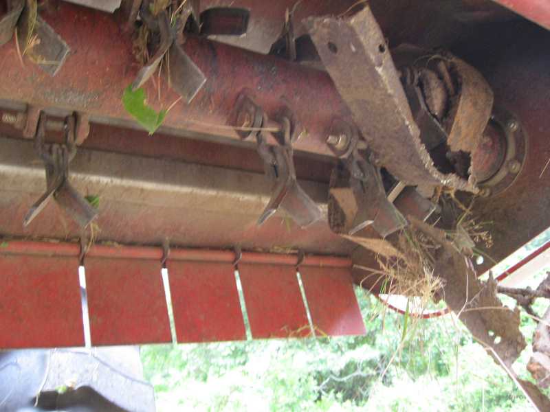

I have 56 knives and I recall they are shackled so it is probably the "B" model. Although the Caroni catalog lists a whole bunch of variations, I believe the only TM1900 model carried by AgriSupply is the one I have.
