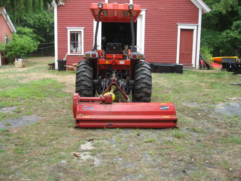

Yep, Red only.........nothing green. But they mow pretty darn good in red. :D
I have the hydraulic offset kit and for my use, getting through a narrow barn door and mowing next to a brook it is just the thing. But without the kit you have 2 positions the the 3pth can be mounted on giving different offsets. They will be of course fixed.
