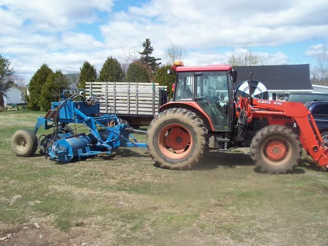

Here's a pic of one of our triple-gang flails equipped with shackled Y-knives for mowing dippy ground with the (sometimes more than)occasional rock. It's got three 3' heads.
