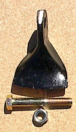

Keith with BETST provided these images of the Hammer style blades at a price of $188 for the "kit".

Yes that would be correct . I may even try a set on my big flail for light work . The beauty of this type is that they eliminate the gap that the 'Y' blades have and would also create more suction as well as being an easy replacement option .

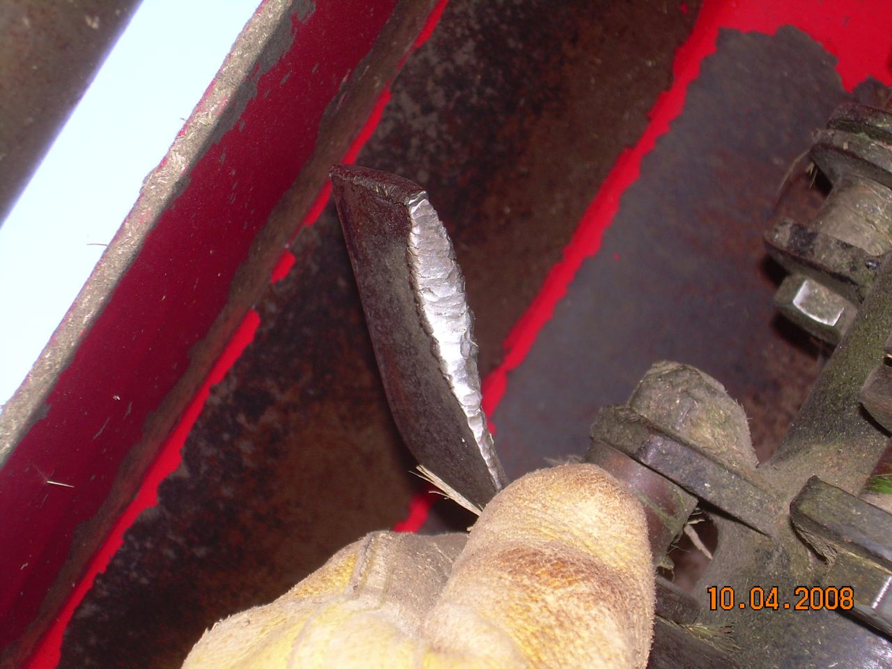

Well, I decided it was time to sharpen my knives since the mower was struggling, and the reed canary grass really needed to be cut. To my surprise the blades were not so much dull as mangled, maybe 1 in six seemed to be hitting each other or their mounting brackets :( . Any thoughts as to why?: poor design, improperly lubricated, pushing too hard in the tall stuff, not running at high enough PTO speed (often run at 500 vs recommended 540 rpm), using as tiller (don't ask :rolleyes:).
I am half way through sharpening after (only) two hours. At this rate it might be faster to just replace.

Most of the above . Blades need the centrifigal force to keep them off the drum so correct PTO speed is needed (use 1000rpm setting at lower engine revs if you have it for light mowing) . Poor design , blade mounts should not be used as blade stops . Use as a tiller , no no :D. Why not try a set of the folded cup knives , i think you would find they would hit the drum squarely with their backs and not be damaged .

You can get knife sharpeners that'll sharpen them right on the cuttershaft and undoubtedly be much faster/safer than the vicegrips/minigrinder approach. That being said, we usually use them until they're too dull/worn to be of much use and then replace them.
