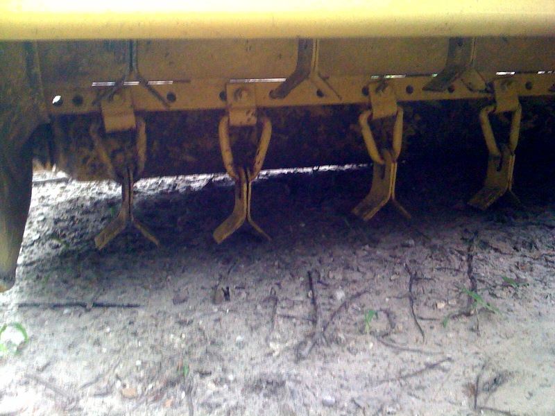

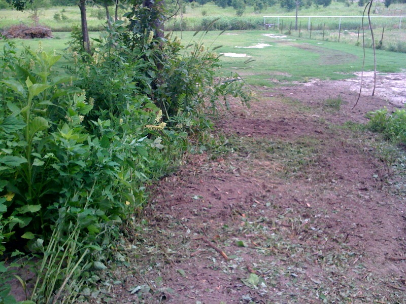

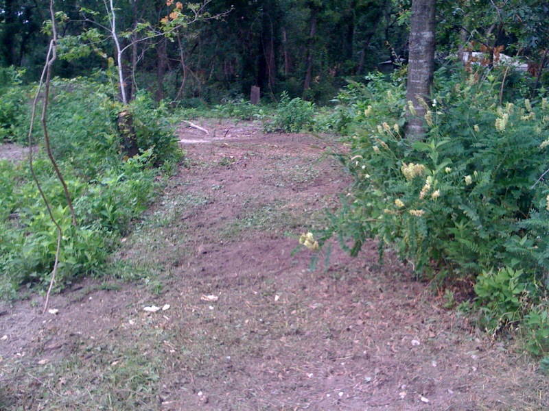

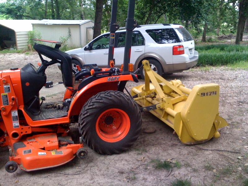

Here's my new to me flail. It's a Ford 917H and I got it on Craigslist for $550. Can you say tail wagging the dog?
I'm gonna modify the lower attachment points on the mower by lowering them. With my shorter-than-an-R4 bar/turf tires I can only raise this thing 1" off the ground. Cuts great though, has the coarse cut blades and only 27 pairs of them so it won't be expensive when I have to replace all of them. It's a 62" cut, by the way.
Not sure what it weighs, but the loader had a heck of a time lifting it out of the back of the truck. If I were to guess, I would probably say in the range of 650 pounds. :eek:

That is a lot of mower for that tractor. Looks like it does a good job though.

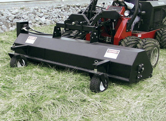

Slightly off topic, but I am a newbie trying to learn... is there a flail mower I can run with my case 1840 standard flow machine without over heating it? I have been searching the net and finding that most flails are built for 100plus hp high flow machines. Any help or guidance would be great!
Thanks in advance,
Beau Nelson
I believe you should be able to run the Power-Trac flail with your machine. It is powered by a 15 GPM hyd motor. I have made an adapter to hook it up to a Case 1445C. 72 in cut.

Looks pretty good and it was a good price.
/ Let's talk flail mowers #632
It may be easier to buy a quick hitch with the lower mounts to adapt it . I would suggest you also fill in the ROPS with some mesh to catch missiles from the front of the mower .
Great idea on the quick hitch...I'll have to look into it. As far as the missiles, this mower is forward rotation (same direction as the tractor tires) so anything in the front gets thrown rearward. It is missing the rubber shielding on the back of it, so it would probably be a good idea to pick that up to keep missiles from coming out the back. :)
Well , Ive learnt something new . I have never heard of a forward rotation flail mower . The pulleys are on the left side so they must have reversed the gears in the box . Why on Earth would they do that ?
/ Let's talk flail mowers #635
Tis true...in fact, the current heavy duty flail from New Holland (model 918H) is field reversable for different tasks. This is what they say about it on their site:
Rotor direction can be reversed for mulching. Forward rotation of the rotor knives (same direction as the tractor tires) lifts the grass for even cutting. Reversing the rotors allows for thorough mulching of the clippings and throws them to the rear where they are evenly distributed.
Supposedly, forward rotation works better for grass and weeds as it tends to pull the grass rearward and upward after it has been laid down by the tractor tires.

About the direction of flail mowers. What is the normal rotation for a flail? As you look at the flail, if the blades are turning toward you from the top, is that considered forward rotation, then the cut material would be thrown to the back. So now, if the rotation of the blades are reversed, and the Y type blades are sharp on front and back. The shaft is now turning in reverse, with the tip of the blades turning toward the back of the flail. all material is thrown forward to be cut over and over, What percentage of the time is reversed rotation is used? Yes, I can see that it would keep cutting the material, but I also see the long grasses and vines wrapping around the shaft, but maybe not.. I have a hydraulic driven flail, and can reverse direction at any time. When I first got my mower, it had slicing blades on it, perhaps used to renovate lawns. So the question is, to someone that has used the flail in forward and reverse rotation, what is the advantage of each direction. How do you reverse rotation on a PTO type flail, other than driving the tractor in reverse. With the Power-Trac, I am pushing my 72 in flail mower.
A flail mower like this will coat about $4700.
Here is a picture.
