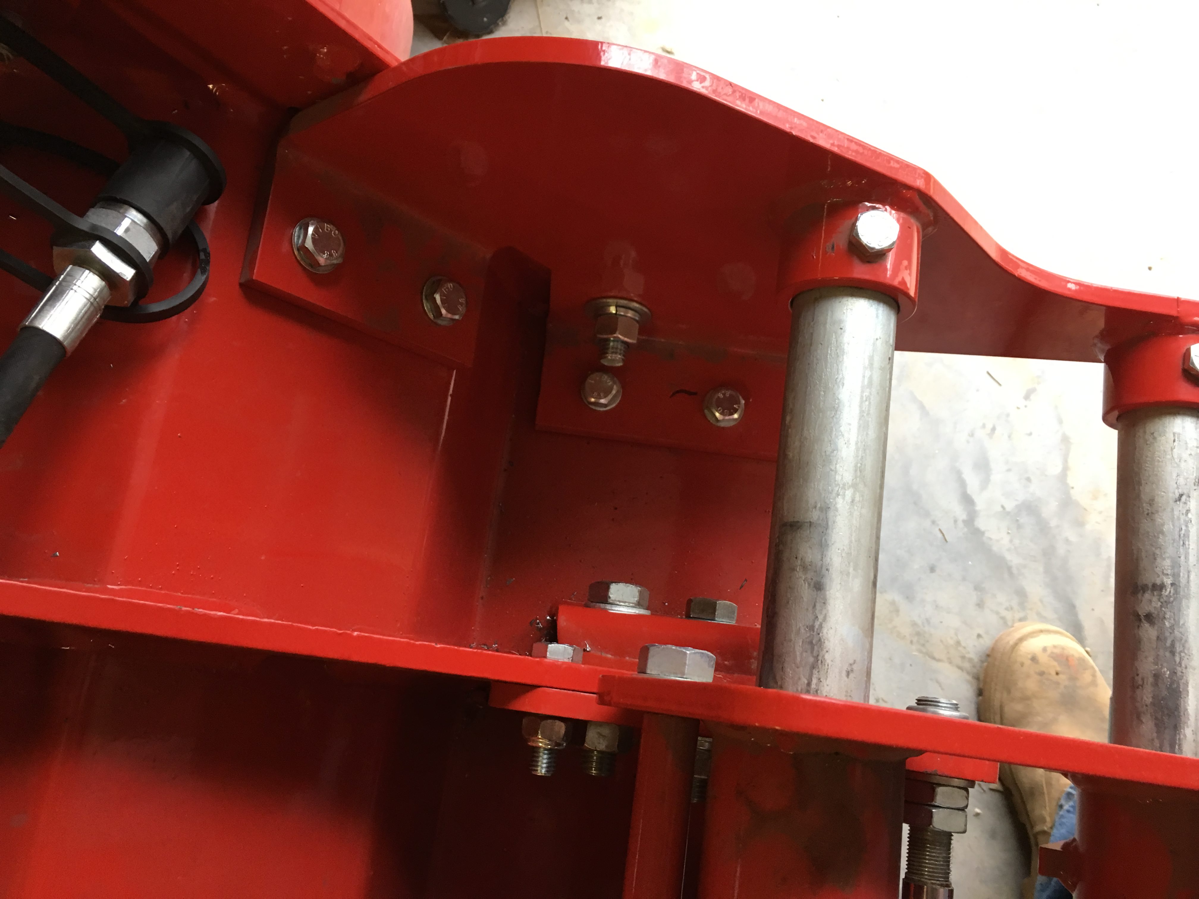

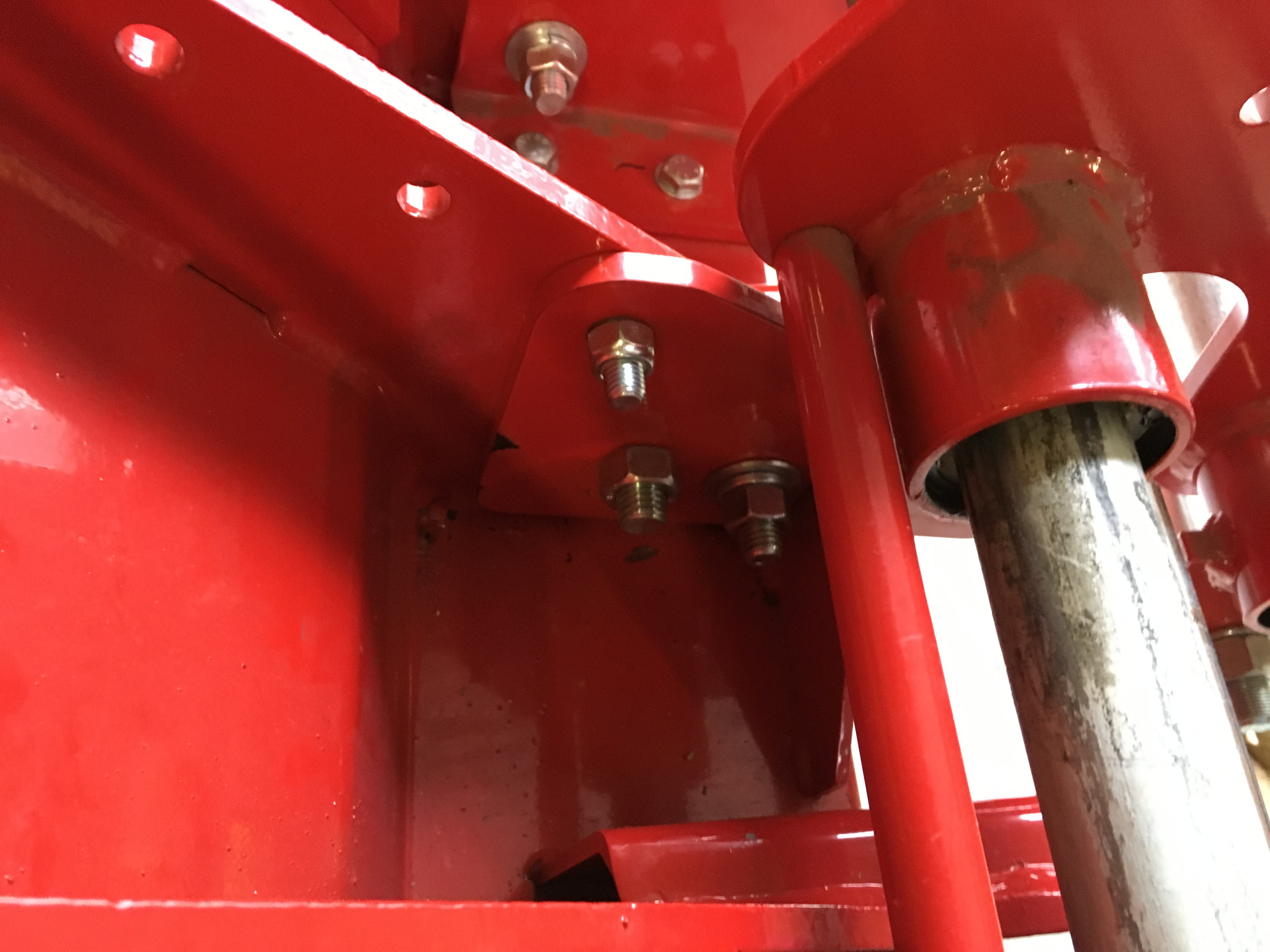

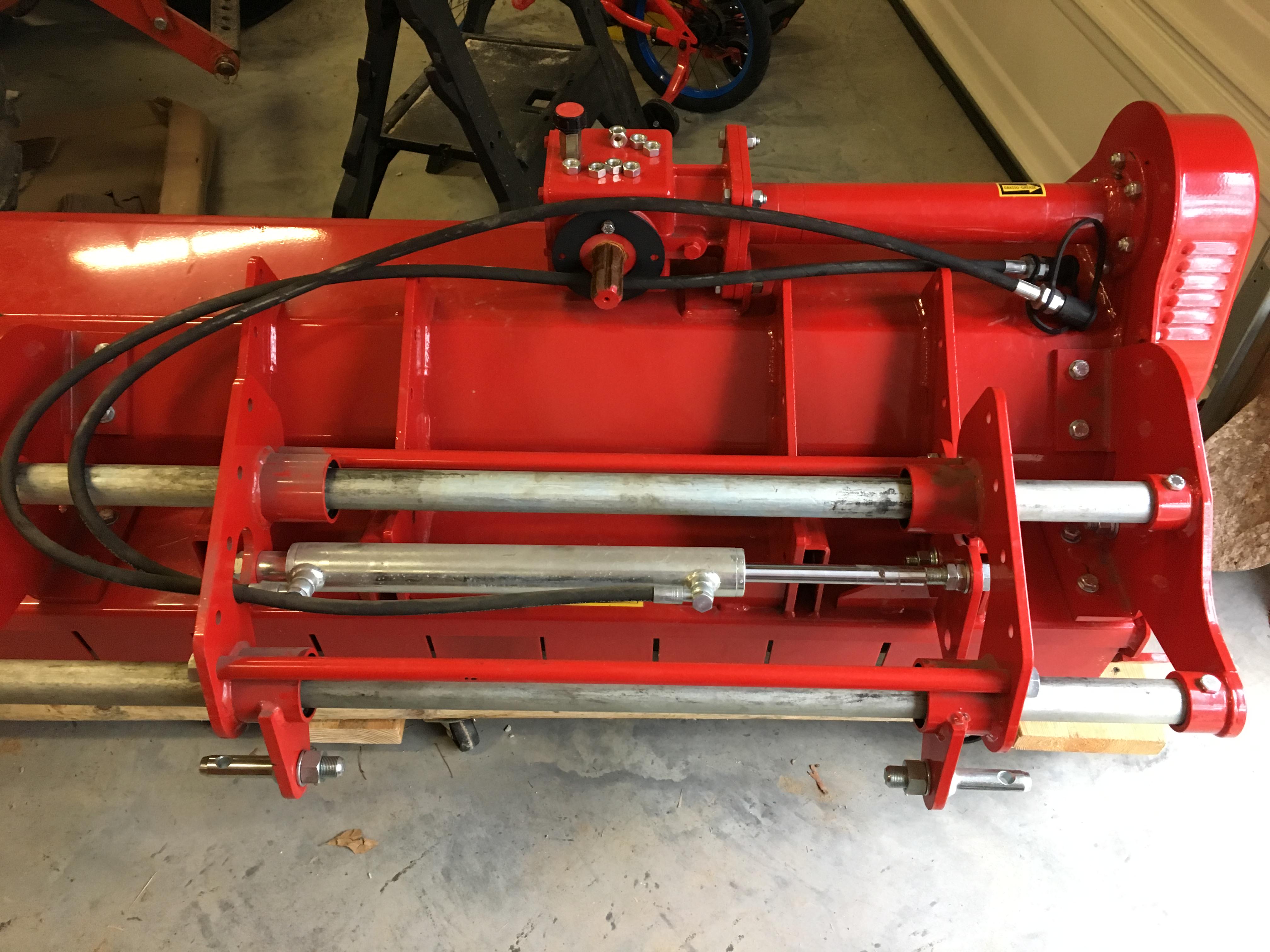

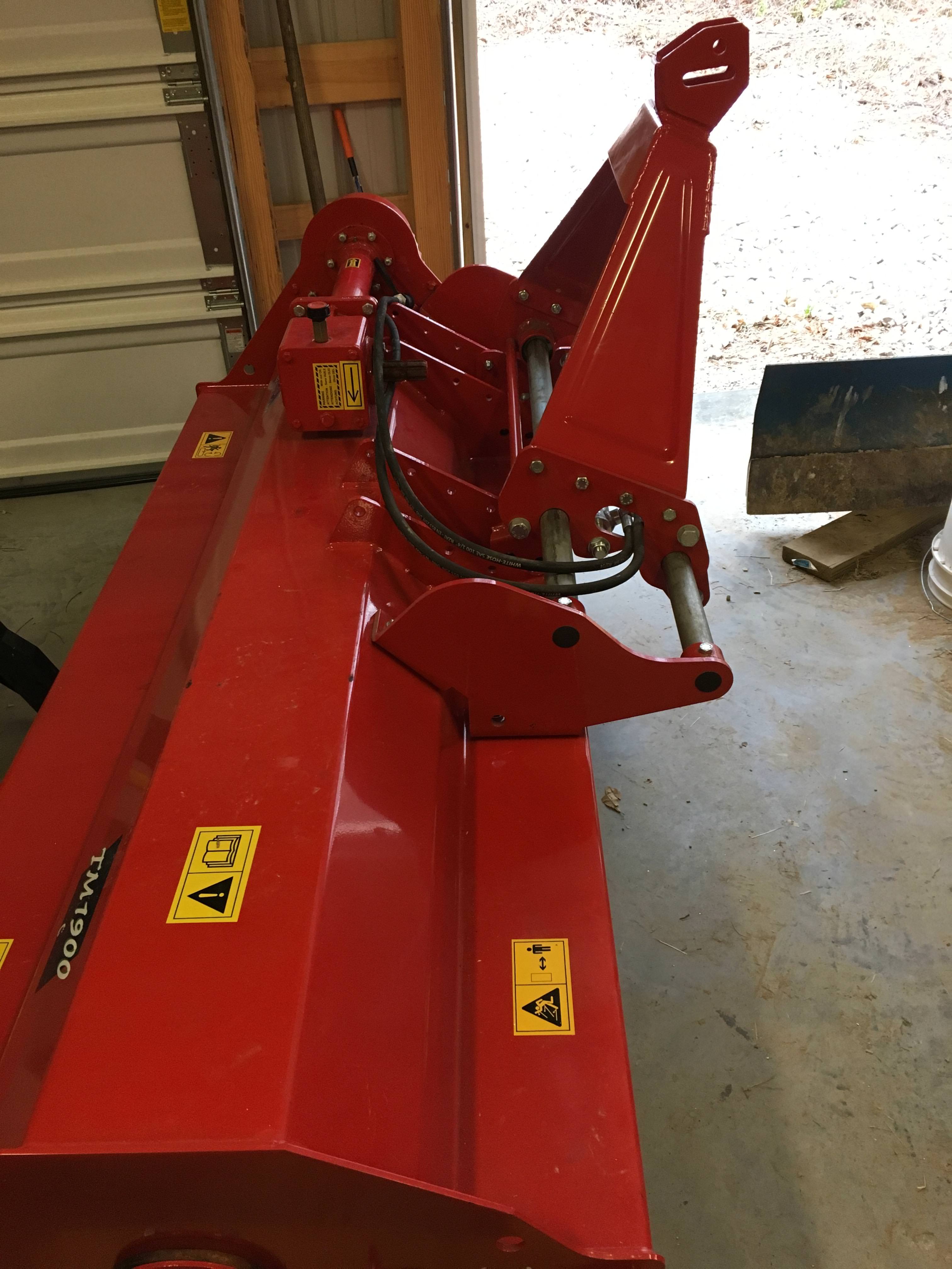

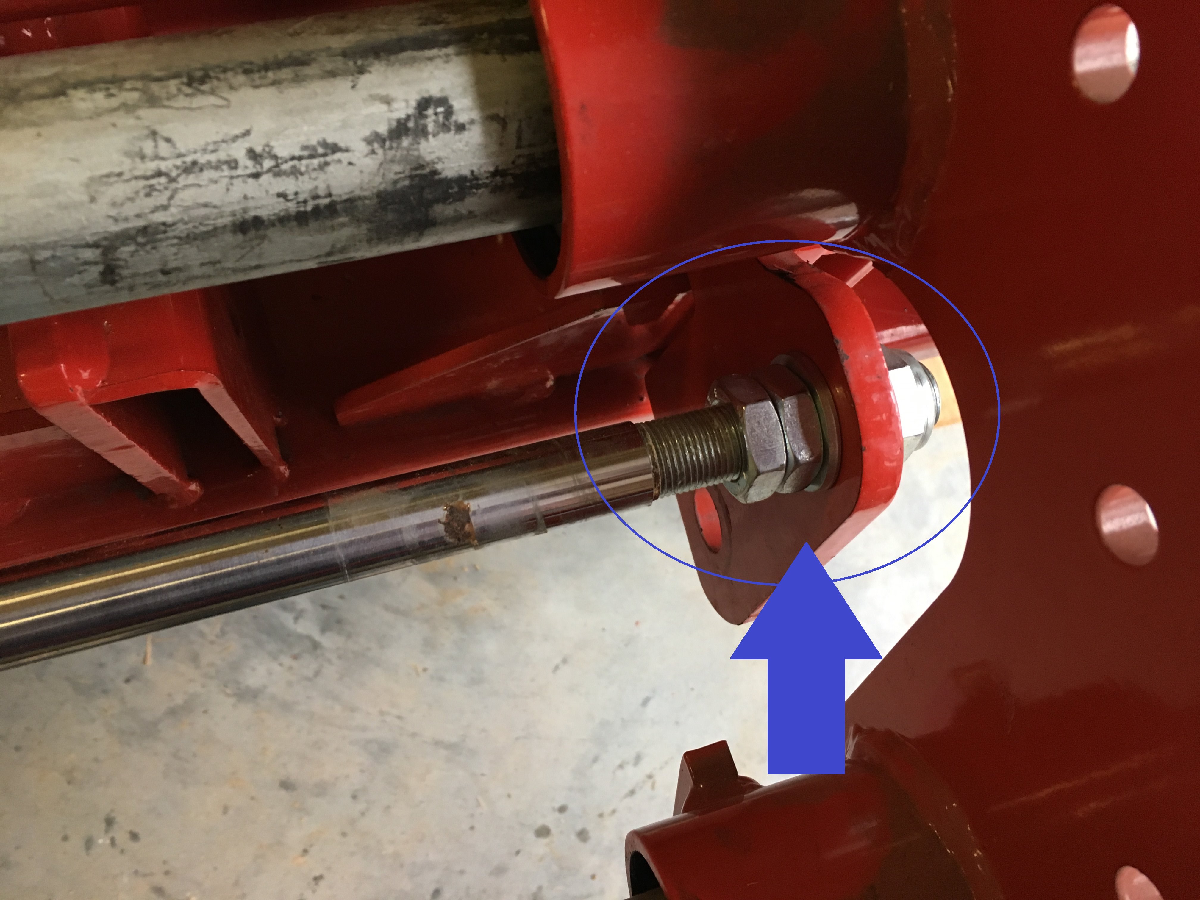

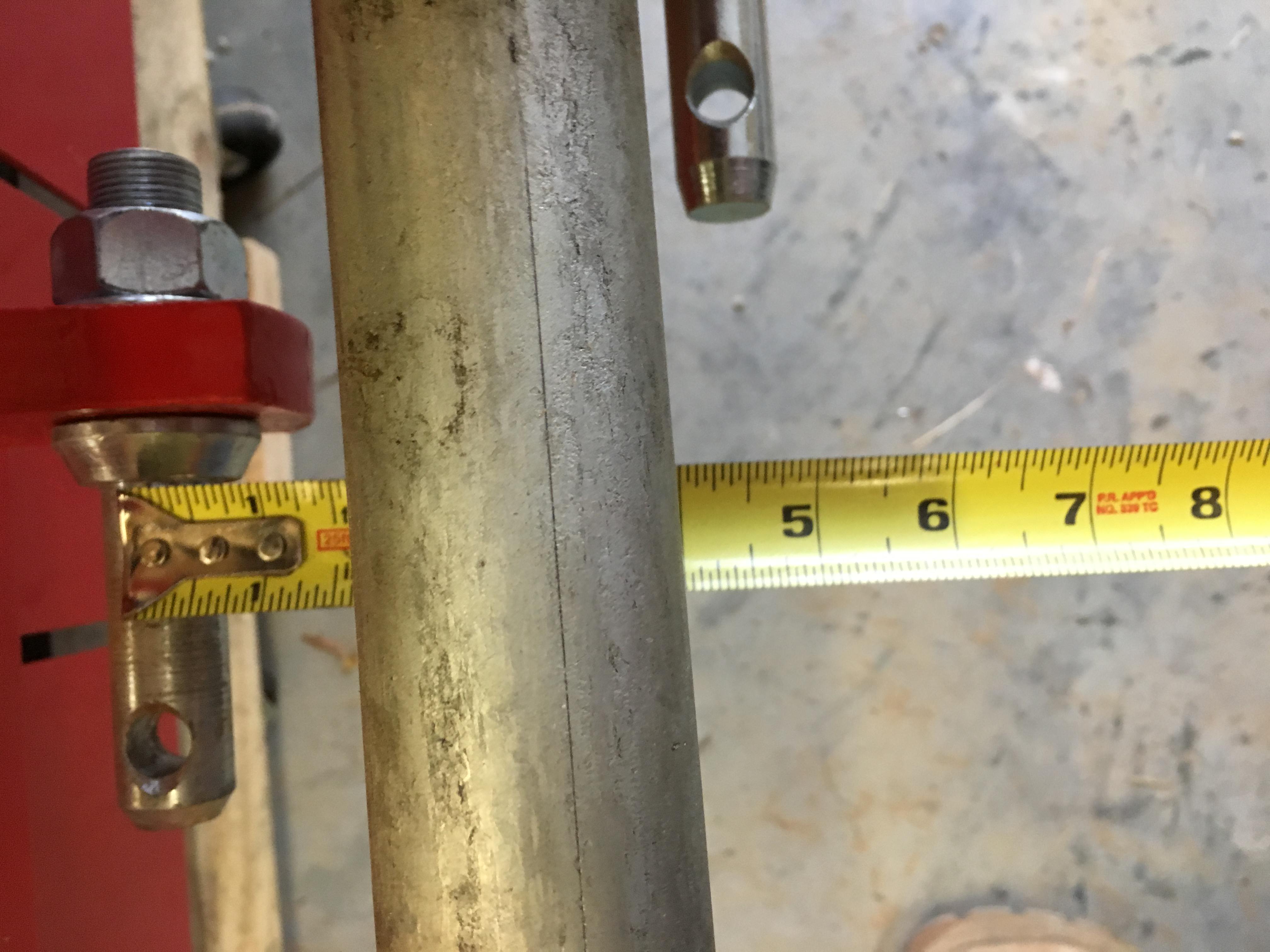

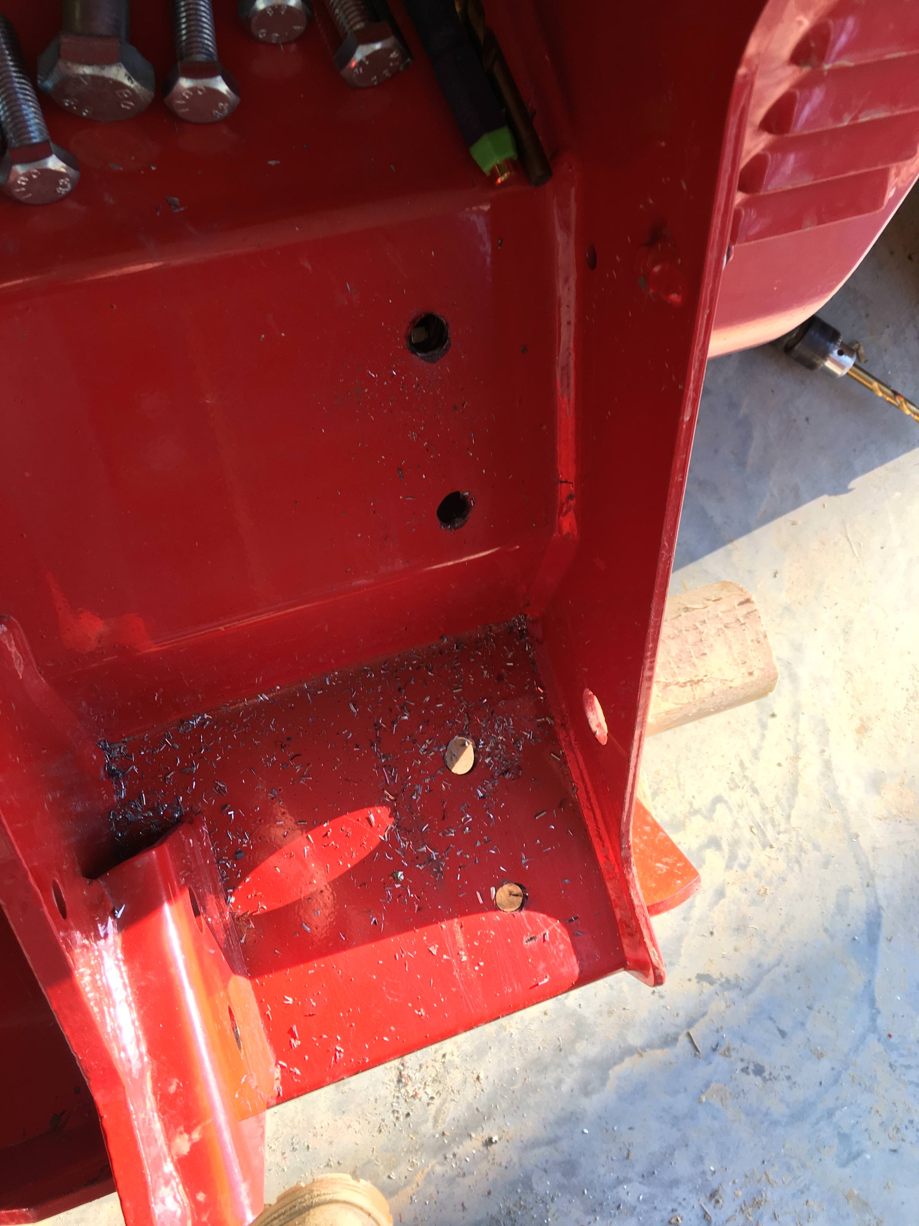

That's why I think the seller sold you the wrong offset kit which is not for your Caroni mower. I cannot believe Caroni need customer to drill holes on the mower to assemble the hydraulic offset kit, Caroni engineers won't be so stupid, I don't believe it.
Jack, I was definitely disappointed, but I can understand Caroni not wanting to pre-drill holes on all units when 95% of them will never see a shift kit.

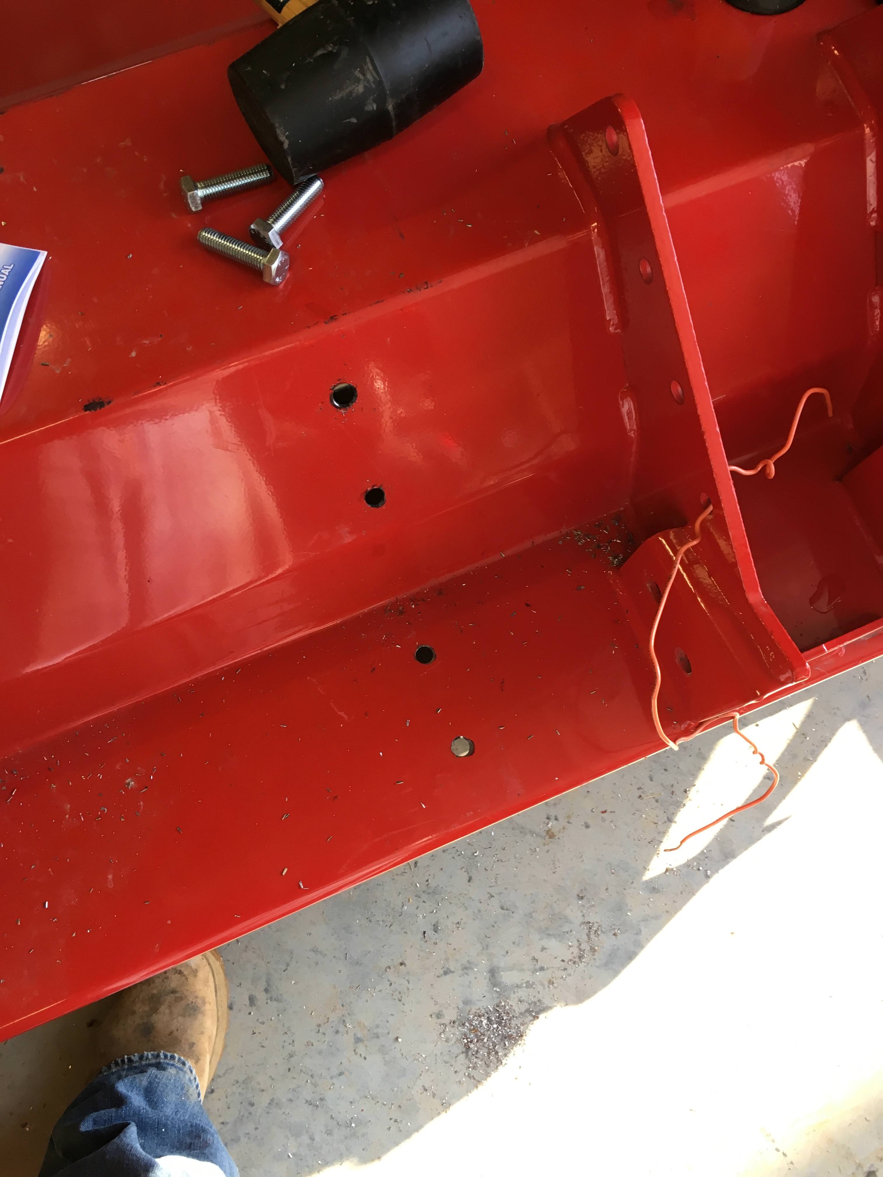

I made some good headway last week.
Holes drilled.
Assembly finally mounted!
In my previous post I showed the huge washers to put on the inside of the mower. Two of them were red, and clipped. I ended up needing to clip two more of them to get everything to fit properly. On each of the two columns of holes, the bottom and second from the top holes required clipped washers.

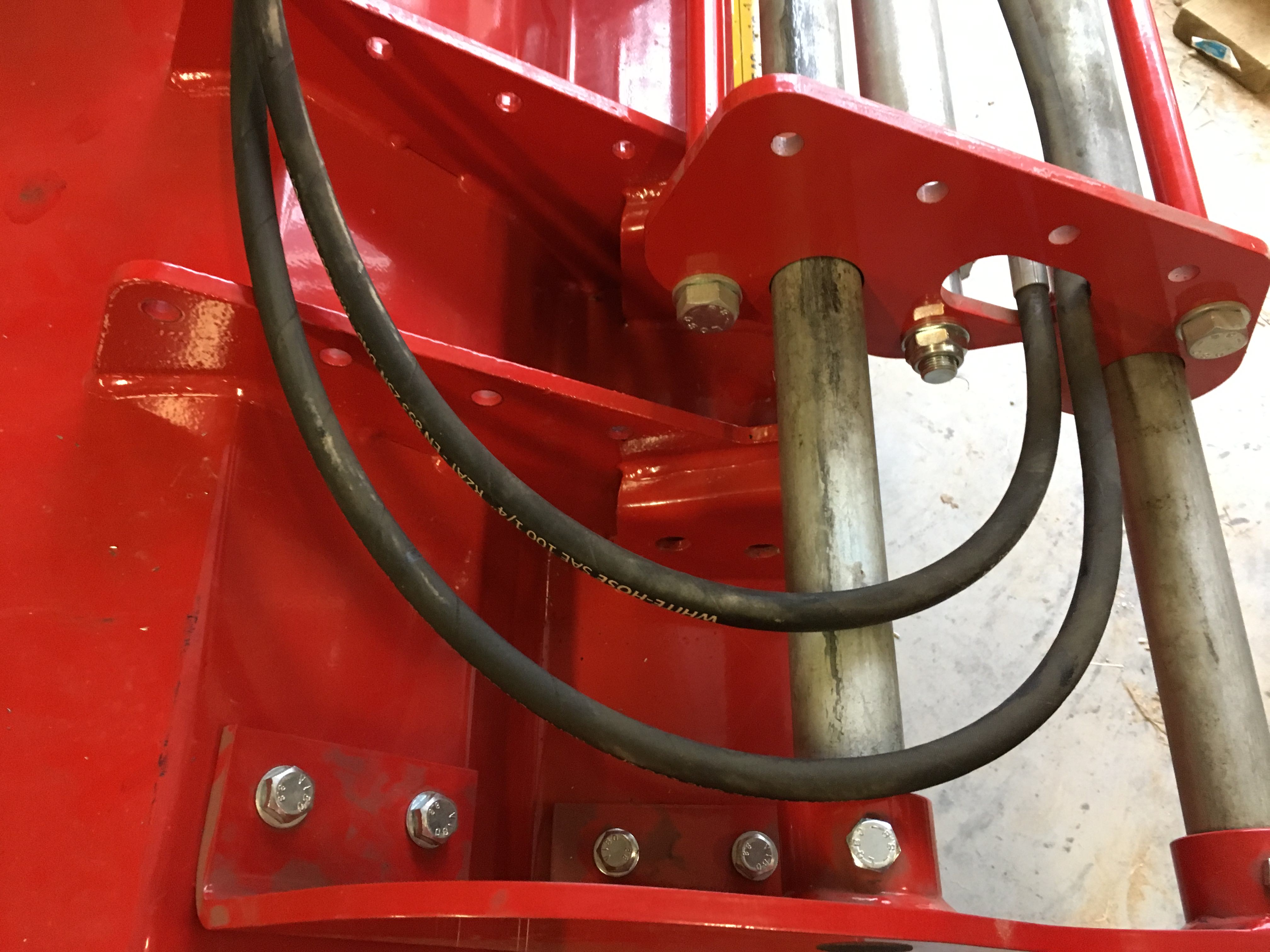

Starboard side bolts.
Port side bolts. The horizontal bolt you can see at the top of the picture was not included in the kit. I added it since there was a hole there anyway. If you get side guards for the mower (like in this picture https://www.europages.com/filestore/opt/product/96/38/Trincia_e_b920e9cf.jpg ) one of them will bolt through that hole.
Strike plate attached. The Kit came with only the top and bottom left bolts. I added the bottom right since there was a hole there anyway.

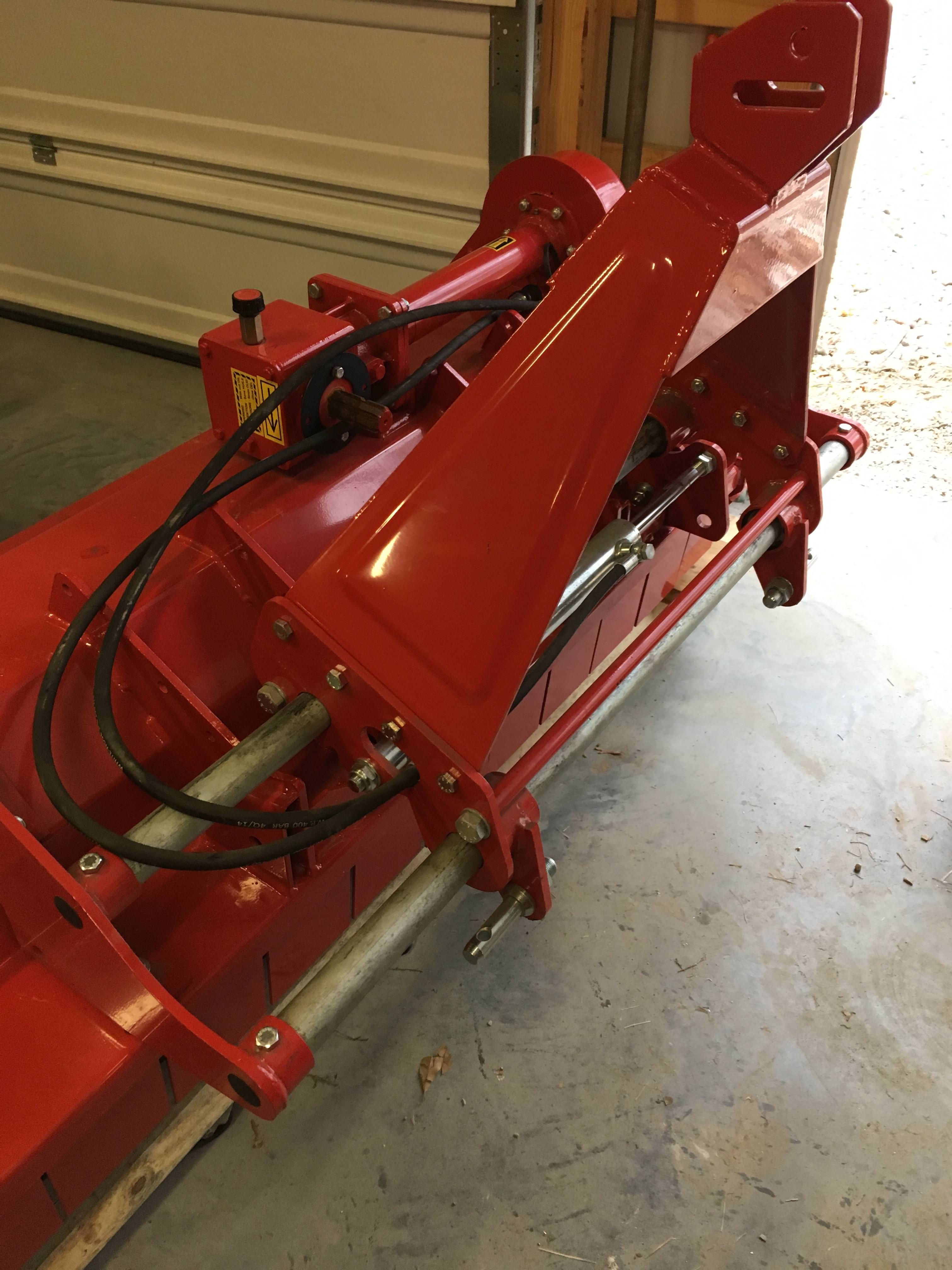

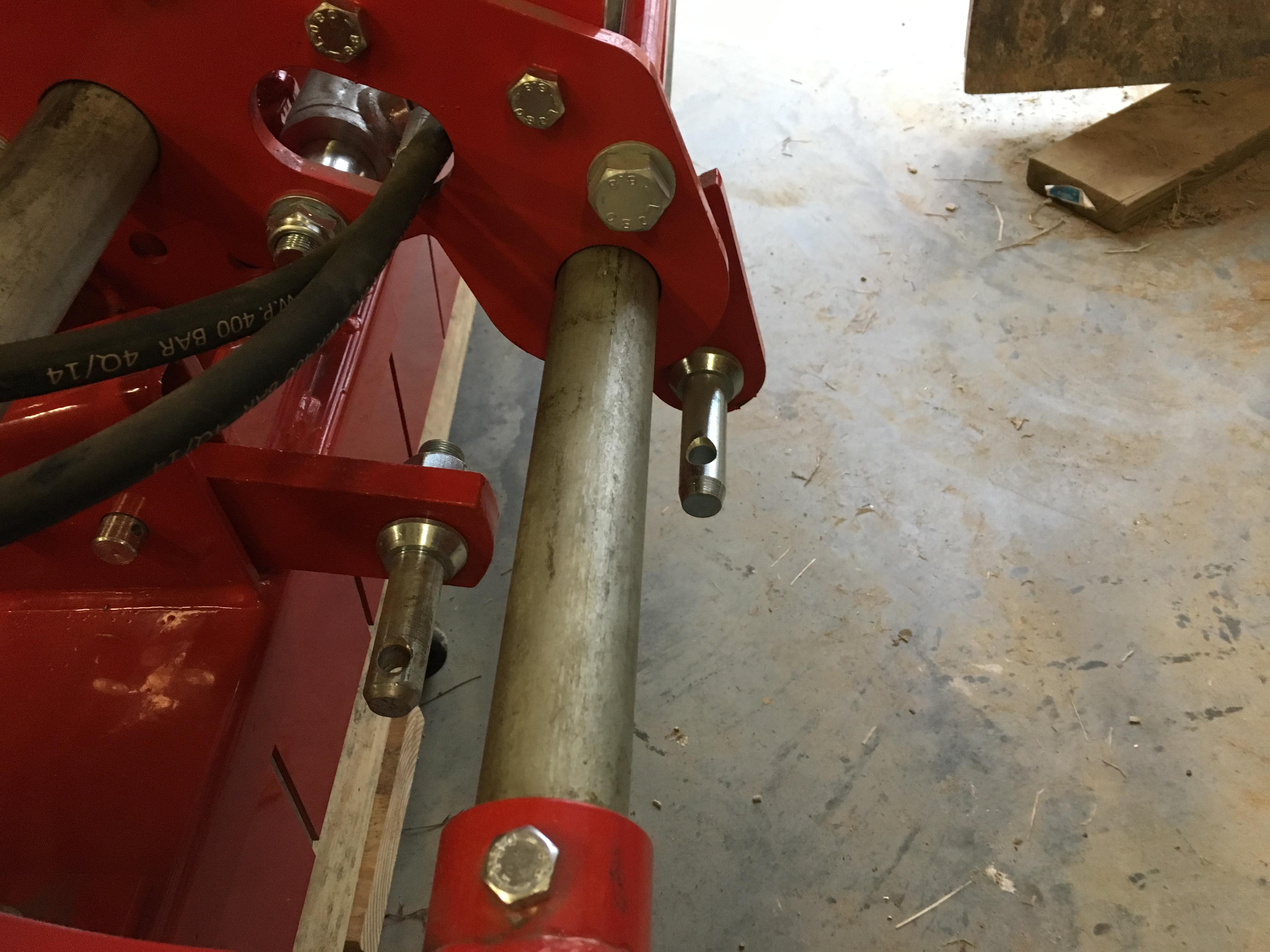

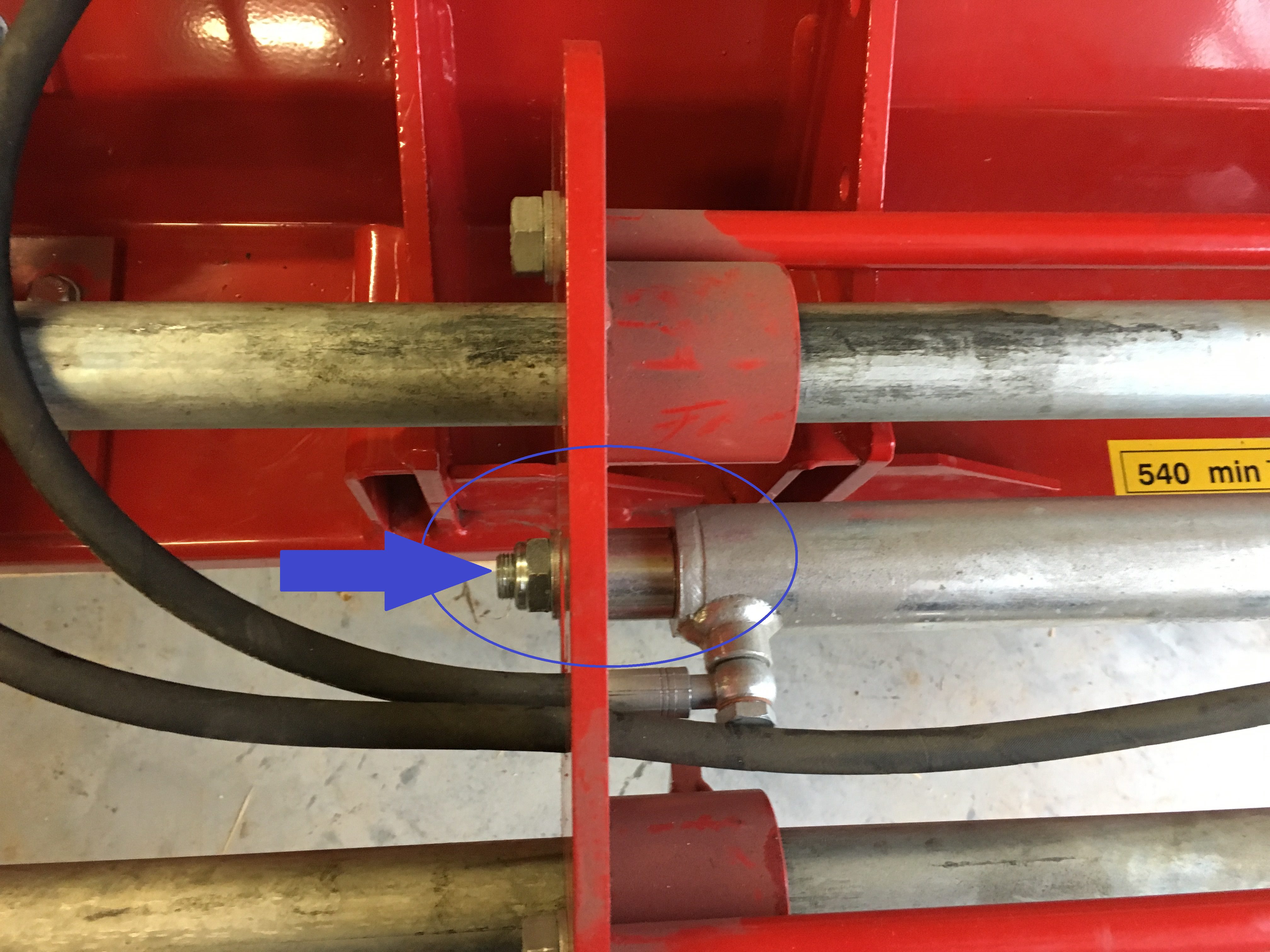

The hydraulic cylinder was pre-assembled on the assembly, but there was a centimeter or two of slack in it. I'm assuming this was to allow for easier mounting. Once I had the assembly bolted onto the mower, I tightened this end to remove the slack on it.
Then I adjusted this end to get rid of the remaining slack.

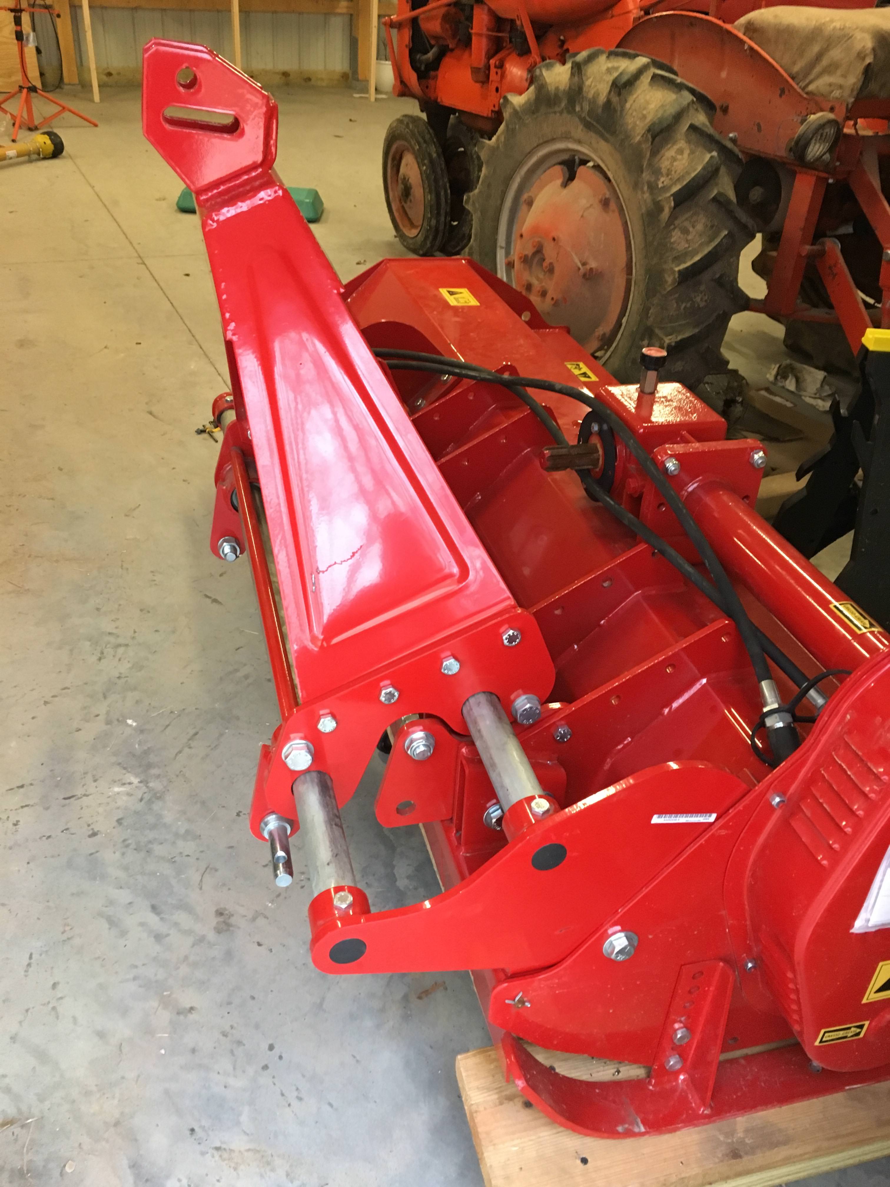

Fully assembled with toplink tower.
I put one of the original 3pt lower mount points back on (left side of picture) to compare with the new hitch point. The new hitch point is around 4.5" forward of the old one.
The full album is here: Caroni Flail Mower with Hydraulic Side Shift kit - Album on Imgur
This week the plan is to get the PTO shaft cut and test her out!
/ Let's talk flail mowers #4,964
Lagreex1, These pictures and explanation will definitely help out others who get this kit. Nice work!

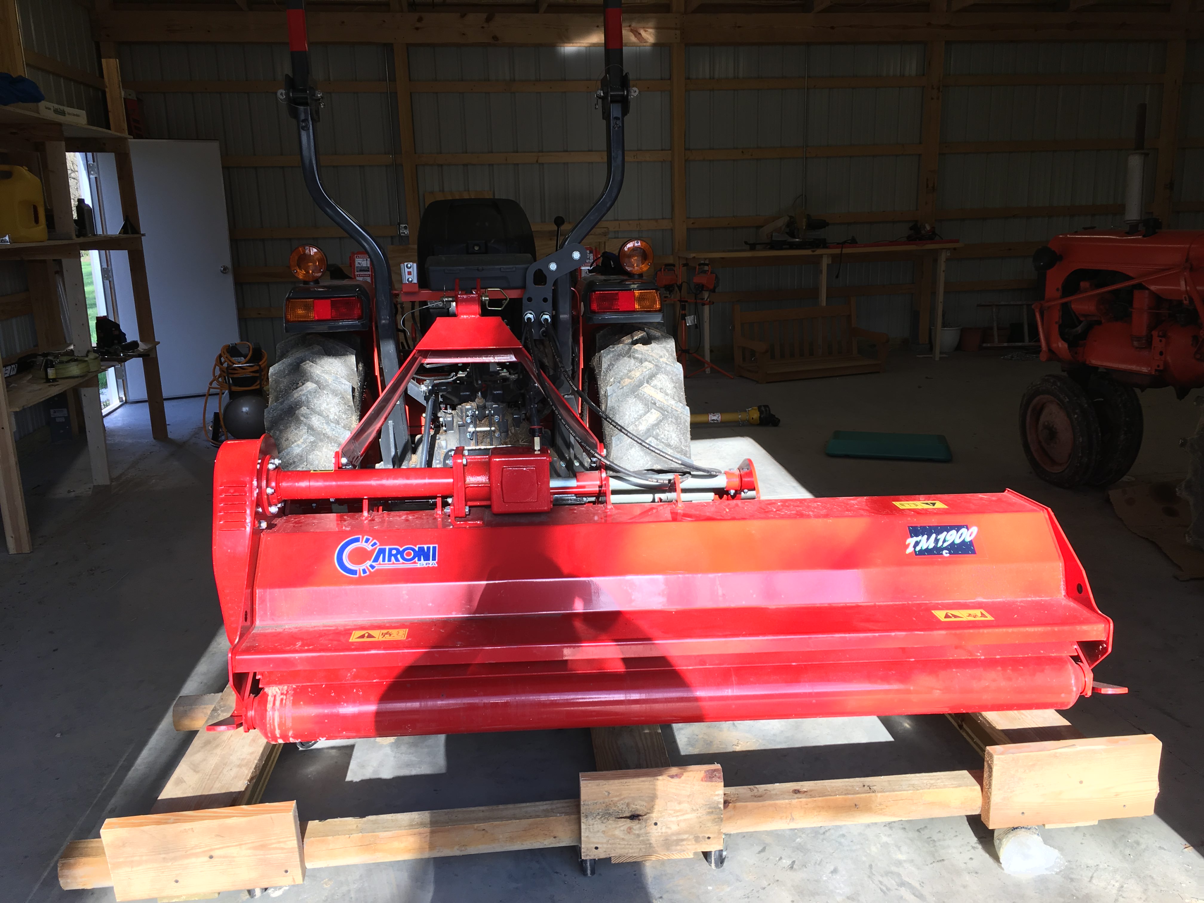

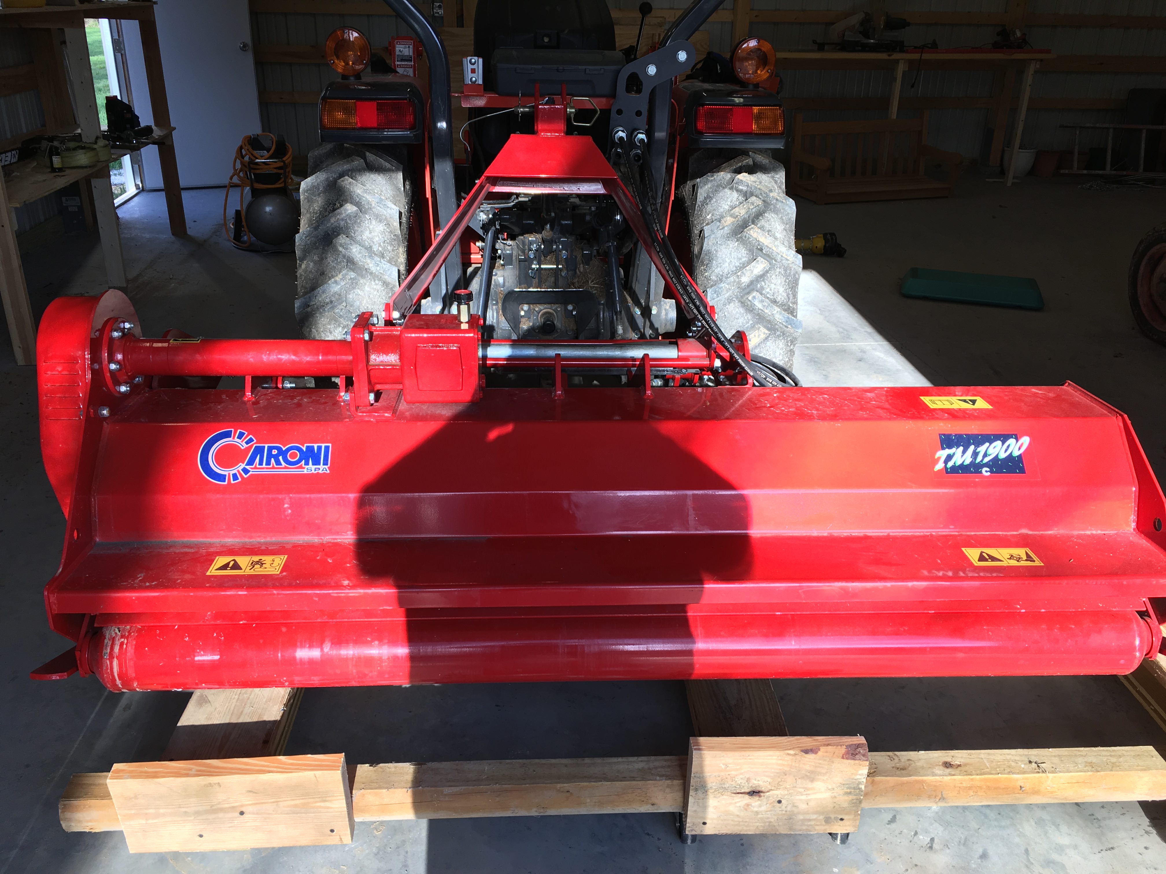

Well I had my first mow with the Caroni and it did great. My toplink was just barely long enough, so I had it pulled in a bit to make sure it didn't break. I picked up a longer toplink today, so my next mow should be even better.
This is the position of the mower fully extended out.
Here's the position fully drawn in. With the side shift kit the mower is almost centered, although the cut is still offset to the right (due to the gear box on the left).
Other than putting the PTO guard on (oops), she's all done and ready for the season. My test mow went well, everything went fine.
A few notes to anyone looking into this setup:
1. Because of the positioning of the shift kit and my PTO, I CANNOT raise the mower all the way up without bending the PTO shaft. That's fine for me, but could be a problem for some. To fully raise the mower I'll need to unhook the PTO shaft.
2. Because of the extra length added by the shift kit, I did NOT need to shorten my PTO shaft.
I'm not used to having that much weight behind me, it'll take some getting used to. I have a 55 gallon drum of wiper fluid ready to fill the tires with, as soon as my buddy has time.
One question: For those with side shift mowers, do you grease the rails at all? There is a light amount of grease or film on them currently, but the manual doesn't say anything about keeping the rails lubricated.
