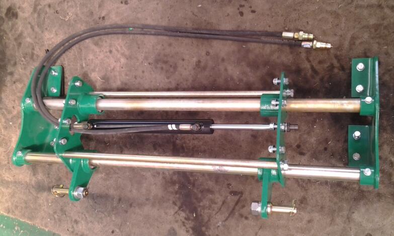

I have a question, why the cylinder is not parallel with the two track? I think this could make big noise when it is moving.

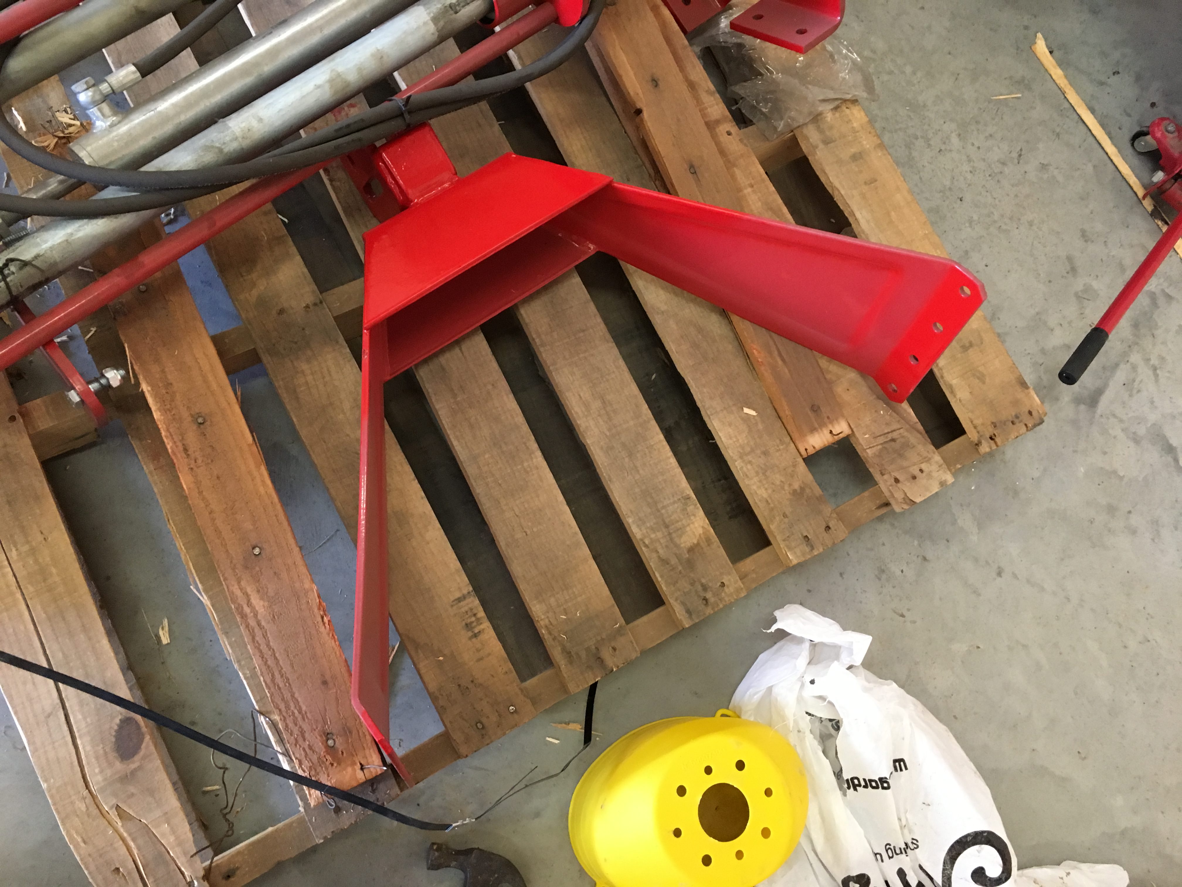

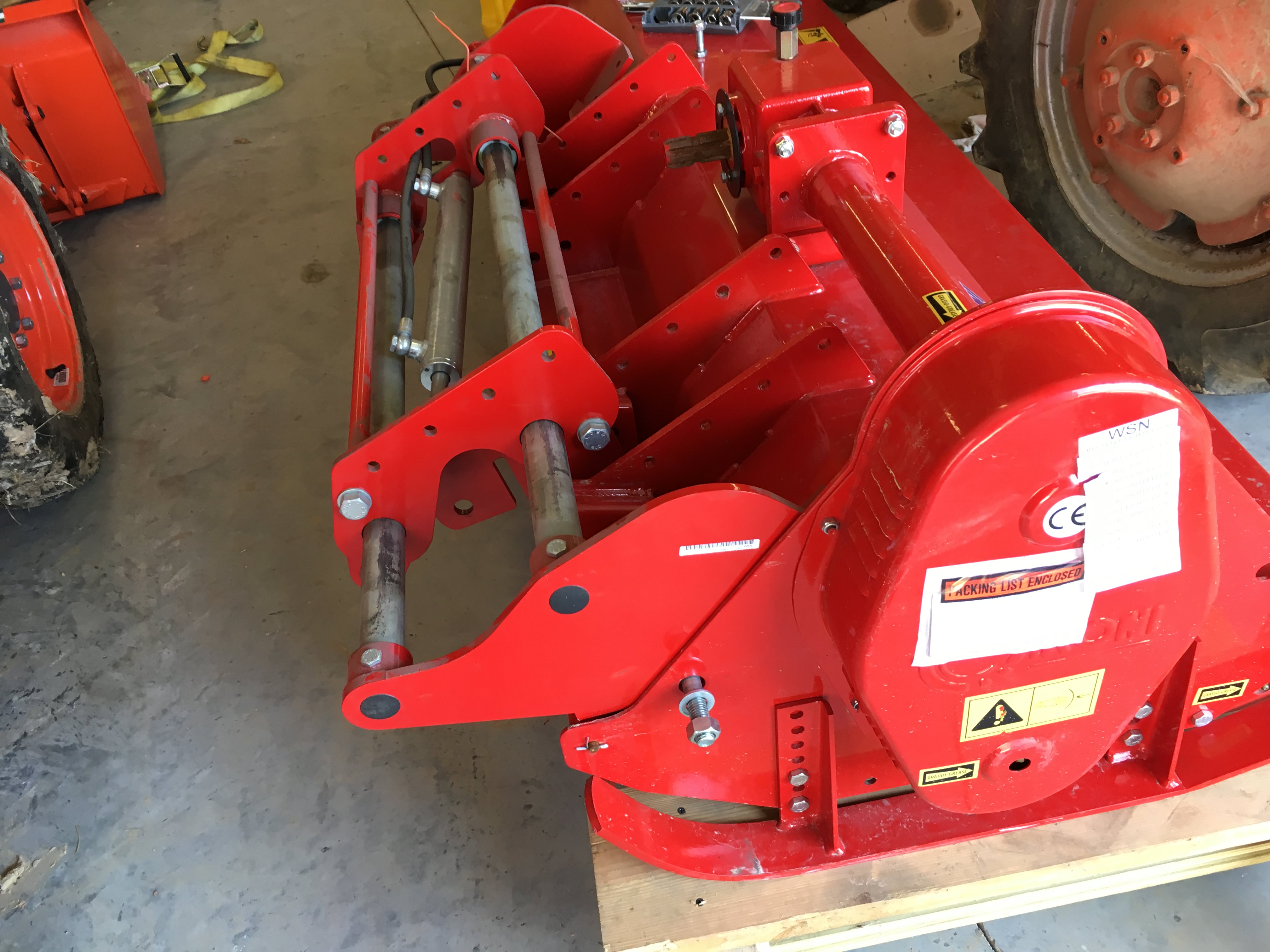

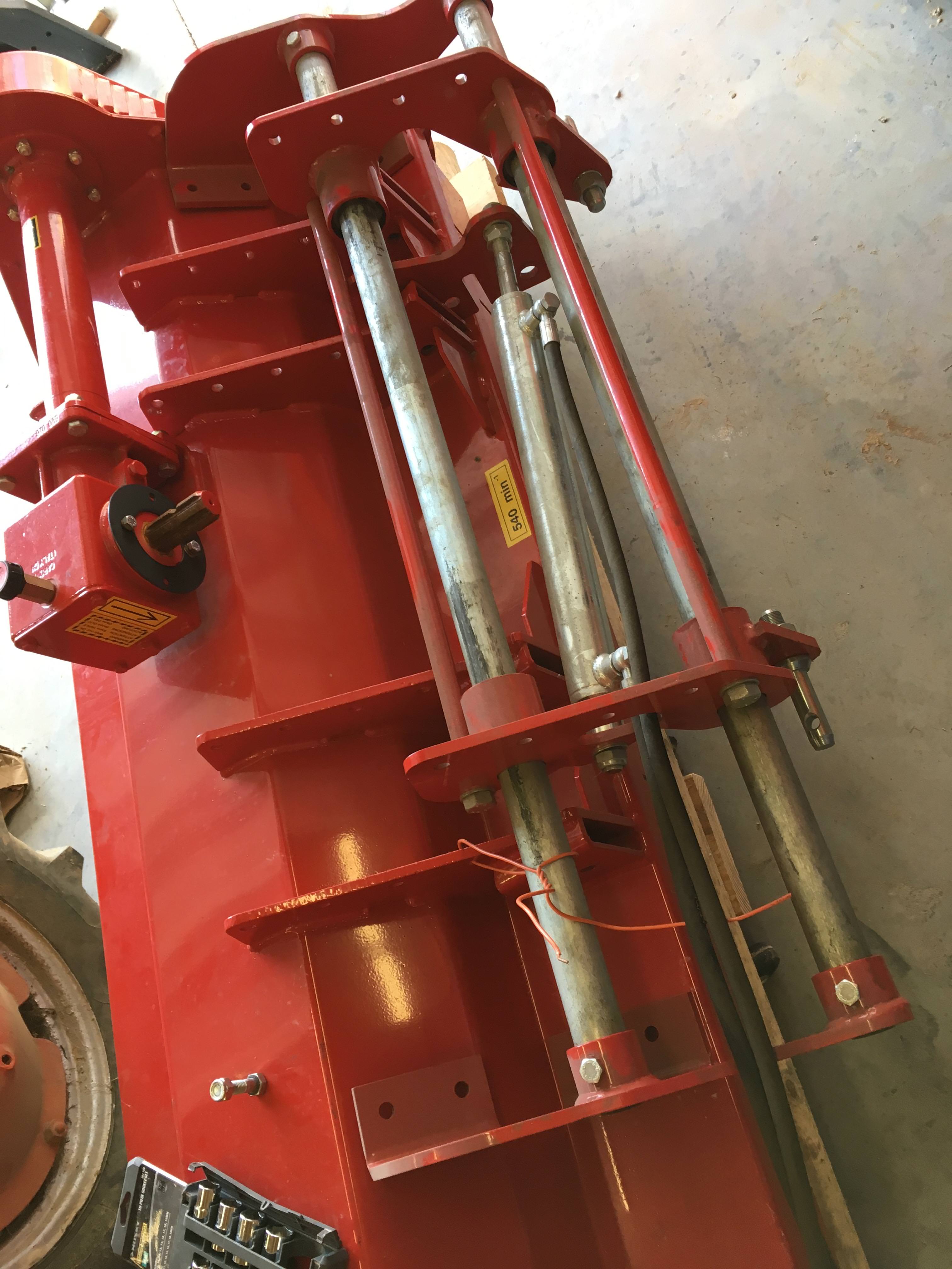

Well I finally have time to start getting the side shift kit onto the TM1900. The "directions" (if you can call them that) are TERRIBLE. I am trying to document the process in case anyone else can benefit from it.
To fit the side shift kit you have to take all the standard hitch equipment off.
This leaves you with the standard top link tower and lower 3pt mounts as spare parts (unless you take the slide shift kit off later).
The kit comes with it's own top link tower. It is different from the standard one
I dry-fit the side shift assembly on top. It's held on by a bolt and some wire. The cylinder mounts aren't lined up in this picture, so it won't normally be cockeyed.
One thing I didn't realize was that holes need to be drilled to mount the kit. I'm not looking forward to that. That's the next step, for another day. There are spacers that need to be inserted on the cylinder assembly, but I haven't figured out exactly how many or where. Different spacing is required for rear mount or front mount assembly, and the instructions aren't clear.
It has been a long time since I did mine, but from memory it wasn't all THAT hard.
Accepted that the translations are rough, add some intuit and with a clear head ta dahh... all done.
One thing to watch out for when drilling the holes is that you have everything "square, level and plumb".
Initially I didn't and a slight out of squareness caused considerable binding when shifting to extreme right.
I had to "oval out" a couple of holes, assemble barely snug then shift out to allow everything to settle "where all the tolerances tolerated each other" then really tighten things up.
YMMV etc.

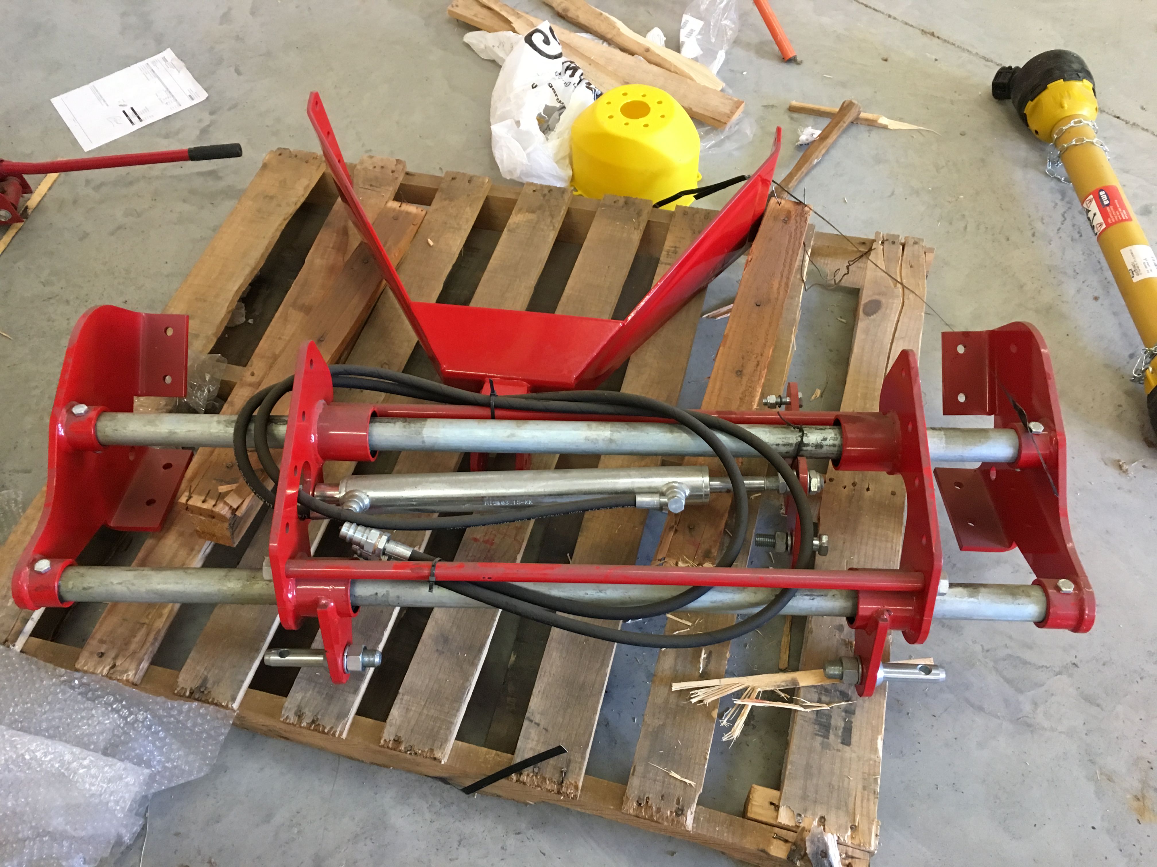

WAIT, WAIT, WAIT, Before you start drilling anything!!!!!!!!!!!!!!!!!!!!!!!!!!!!!!!!!!!!!!!!!!!!!!!!!!!!!!!!!!!!!!!!!!!!!!!!!!!!!!!!!!!!!!!!!!!!!!!!!!!!!!!!!!!!!!!!!!!!!!!!!!!!!!!!!!!!!!!!!!!!!!!!!!!!!!!!!!!!!!!!!!!!!!!!!!!!!!!!!!!!!!!!!!!!!!!!!!!!!!!!!!!!!!!!!!!!!!!!!!!!!!!!!!!!!!!!!!!!!!!!!!!!!!!!!!!!!!!!!!!!!!!!!!!!!!!!!!!!!!!!!!!!!!!!!!!!!!!!!!!!!!!!!!!!!!!!!!!!!!!!!!!!!!!!!!!!!!!!!!!!!!!!!!!!!!!!!!!!!!!!
Please purchase an Italian to English language dictionary to do the work first !!!!!!!!!!!!!!!!!!!!!!!!!!!!!!!!!!!!!!!!!!!!!!!!!!!!!!!!!!!!!!!!!!!!!!!!!!!!!!!!!!!!!!!!!!!!!!!!!!!!!!!!!!!!!!!!!!!!!!!!!!!!!!!!!!!!!!!!!!!!
You have to flip the side shift kit over to mount it in the 3 attachment holes that correspond with the three holes in the side shift kit on both weldments on the flail mower shroud.
I will have to get in touch with Rodney Barbour about this.

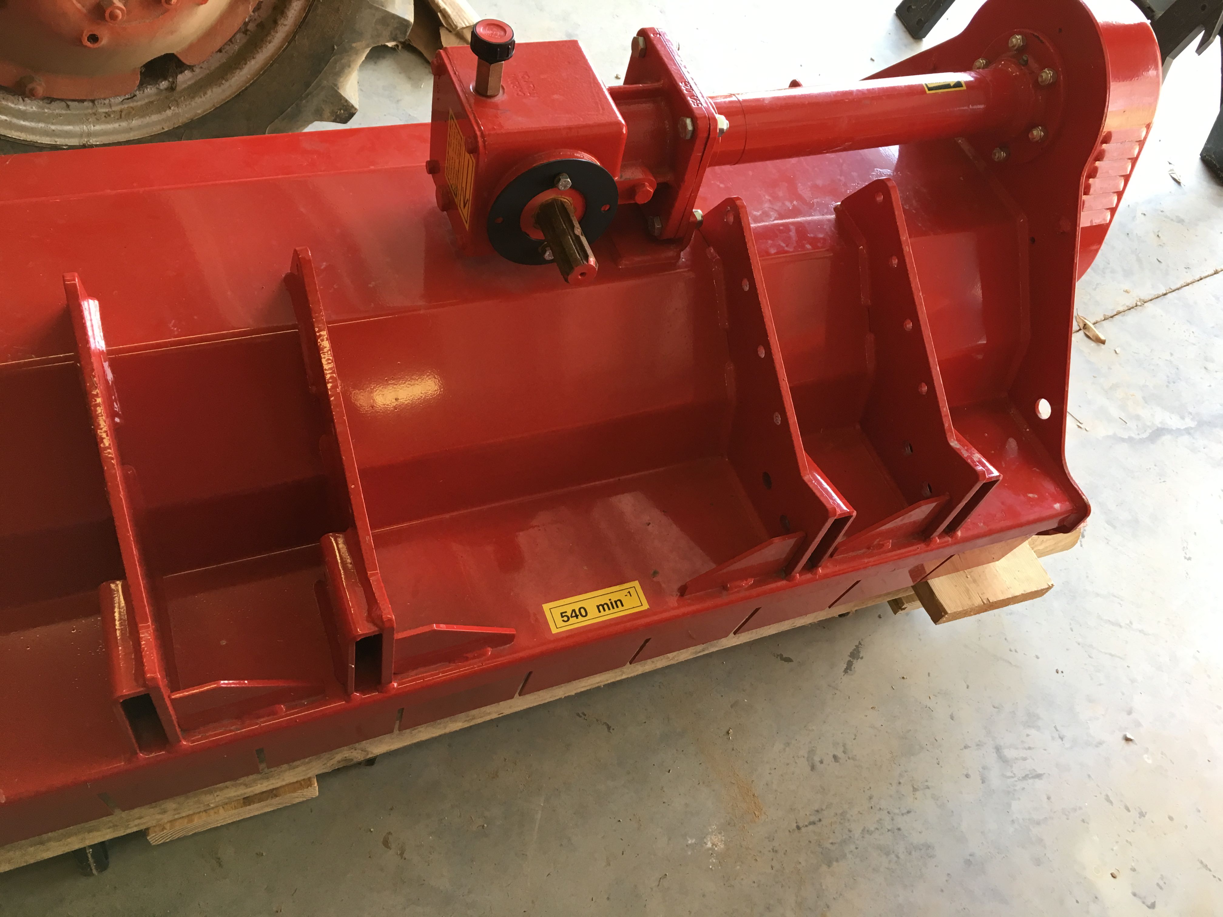

I got a little bit more figured out today.
In order to mount the strike plate for the hydraulic cylinder, I had to do some grinding on one of the welds where the 3pt link arm attaches. After that, the bolt holes lined up and the M18 bolt fit in fine.
I finally realized that the spacer the installation instructions were referring to was already installed.
The smaller spacer is only required for front-mounting. I don't know why I received two of the smaller spacers.
Here is the box of bolts and misc parts. I finally realized that the red and black discs are not spacers. They are heavy-duty washers to be used on the inside of the flail mower after drilling bolt holes. The two red ones are clipped because full sized discs won't fit with two of the holes.
It should be parallel like this.View attachment 543410
Jack, yes absolutely! I had it off in my original picture and mentioned that in my post: "The cylinder mounts aren't lined up in this picture, so it won't normally be cockeyed."
When mounted it will be parallel, thank you for checking!
Sorry, not sure I follow. Are you saying I have the whole thing upside down, or spun 180 degrees? There are absolutely zero holes on the surface of the mower, so I can't imaging not drilling holes and getting this thing mounted.

Hello lagreex1,
These beautiful flail mowers share components with their sister line of rototillers and the mower shrouds and three point hitch assemblies are almost identical to the rototiller shrouds.
If you can rent a mag drill(drill press with a magnetic base) you will have a much easier time of mounting the side shift attachment that will help you 500% in assembling it as the magnet on the drill press will hold it in place with no effort and the drilled holes will be perfect.
Once you have the holes drilled I would definitely want you to use red Loctite to secure the nuts as tight as possible.
