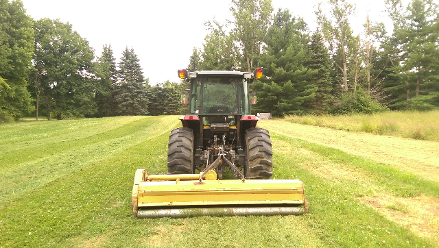

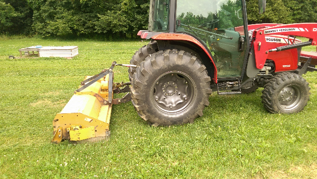

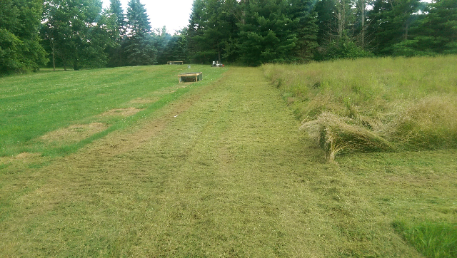

Had a fantastic day yesterday. New neighbors moved in next door and were trying to mow their fields with a big zero turn mower. The key word here is trying. I have been looking for an excuse, so with a bit of help (shoulder surgery) I got my Mascio Giraffetta 160 SE hooked up. Started out a little timid, but once I got going it was beautiful music to my ears, The hum of grass being cut and the crunch of the saplings. One acre was very heavy in grass and cattails. Mower and tractor mowed through it with ease. It was also cool to swing it out over the irrigation ditches and just trim everything down. Did a pretty good job of mulching, but I am still wanting to add the counter blades to make it a bit finer. I did learn a few truicks on the corners (pick it up slightly) so the skids dont dig in. Also mow so wind does not blow everything back on to you :shocked::laughing: After cutting I inspected the unit - some paint off the hammers, but that was it.
Went well and I made good friends with them. They sent their son over to mow my small back yard as barter.
So far it is a good match for my tractor and does a pretty decent cut.

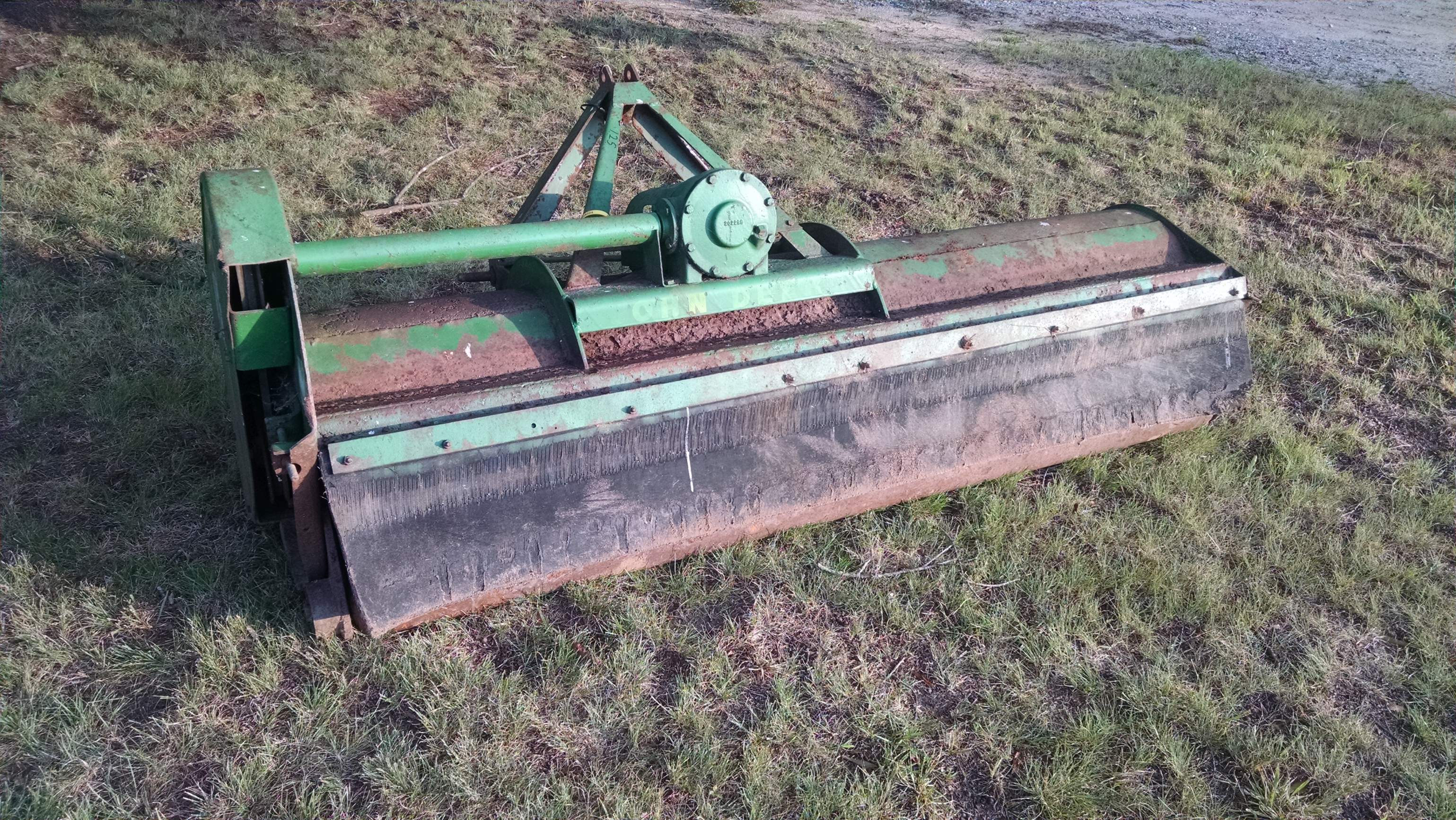

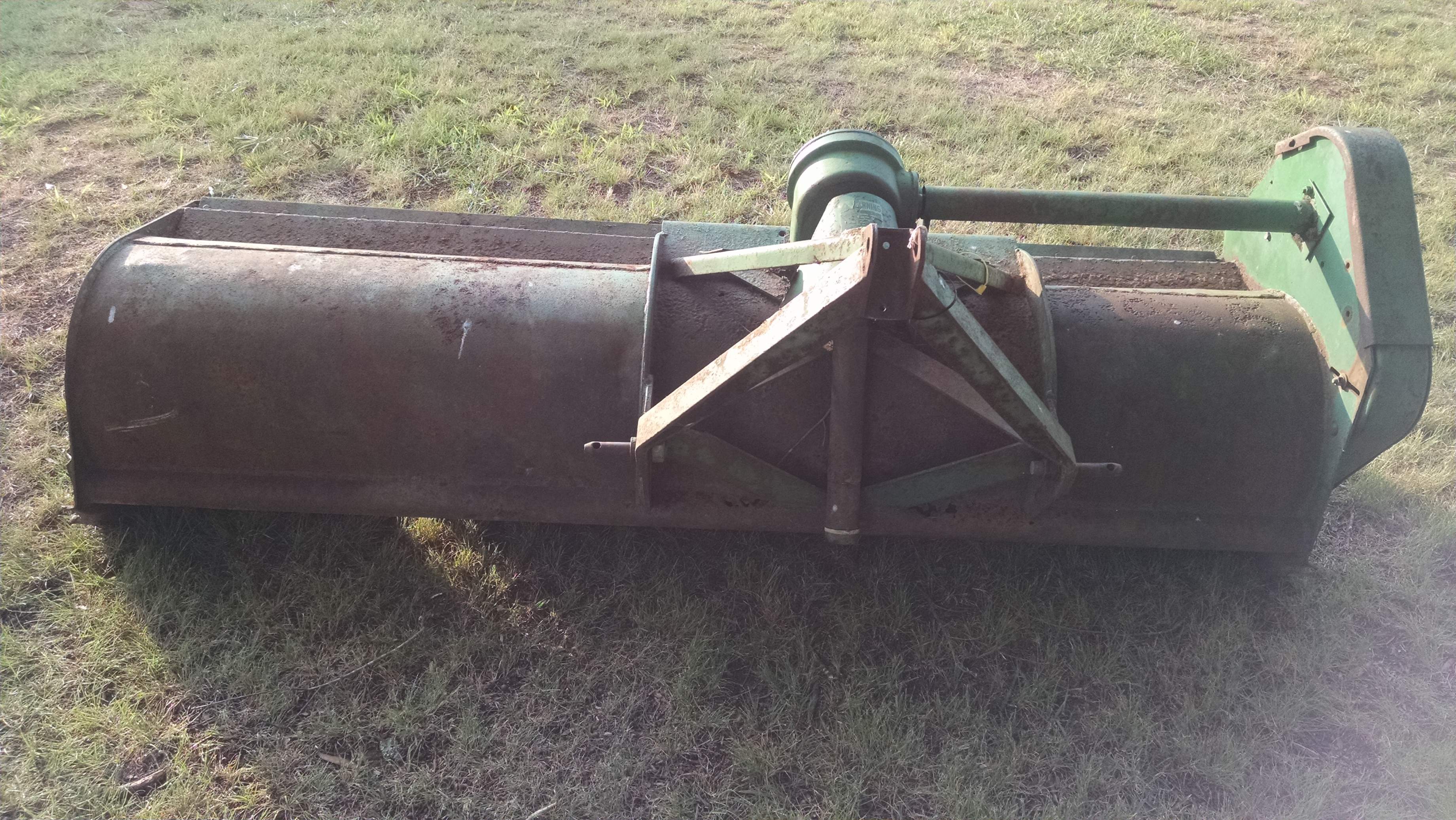

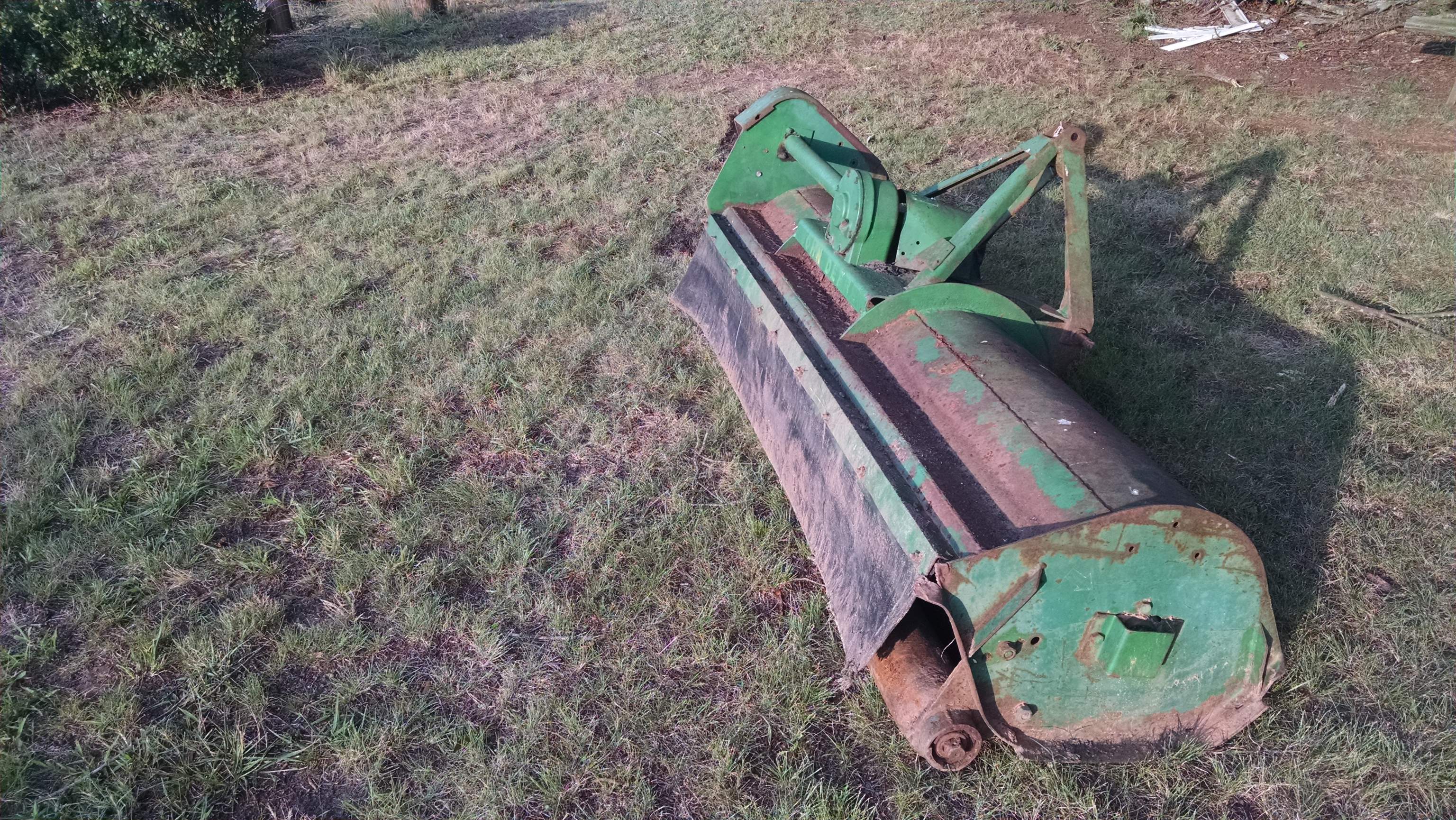

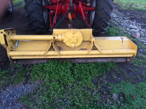

Can someone identify the make/model of this flail that showed up on the local craigslist?
/ Let's talk flail mowers #4,293
Thanks. Given a make to search on, it does indeed look like a Mott of some kind. The owner says it's a 6 footer and "has new knives". Wants $1200. He's not even that far away as things go hereabouts - about an hour.
Edit note: Never mind - he sold it earlier today. So it goes.

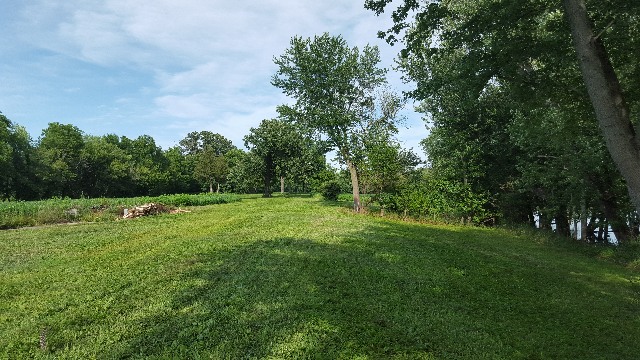

Island, I am overly pleased with the construction. When this thing spools up it's like it's not even there--quiet, smooth and very precise. I think the Italians are indeed on to something. Del Morino has been around for 130 years...I would hope they have it figured out!
